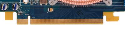

You are telling me that this ...
... is just as good (or even better) than this ...
Except for how it looks?

It is if you have a piece of hardware that needs a crapton of bandwidth.
You can go on and on about how that sleek little car you love so much looks has a 450 HP 4.0 V8 engine, air conditioning, heated seats, satellite radio, and a TV in the back, and claim it's the best for everything around. But when I need to move a mountain, a fast little car with heated seats isn't gonna do me a bit of good. No. I'm gonna want to use a big ass ugly 3500 HP dumptruck.
