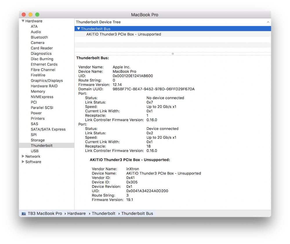

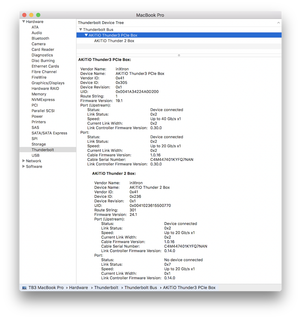

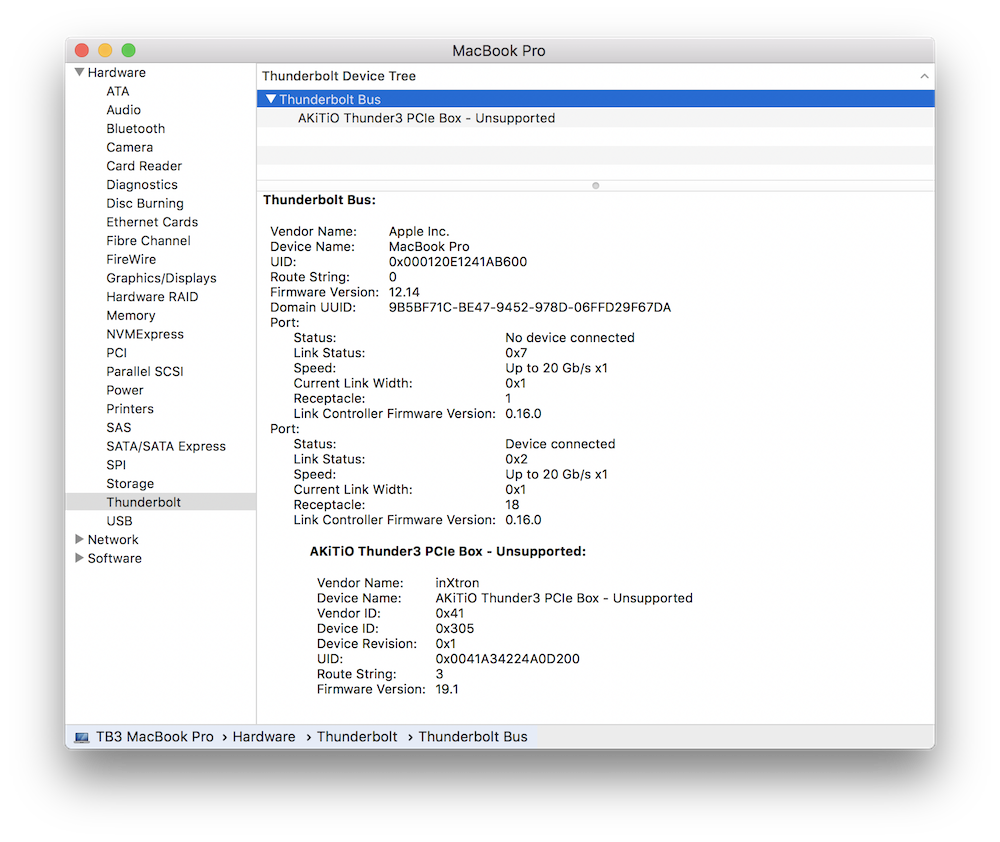

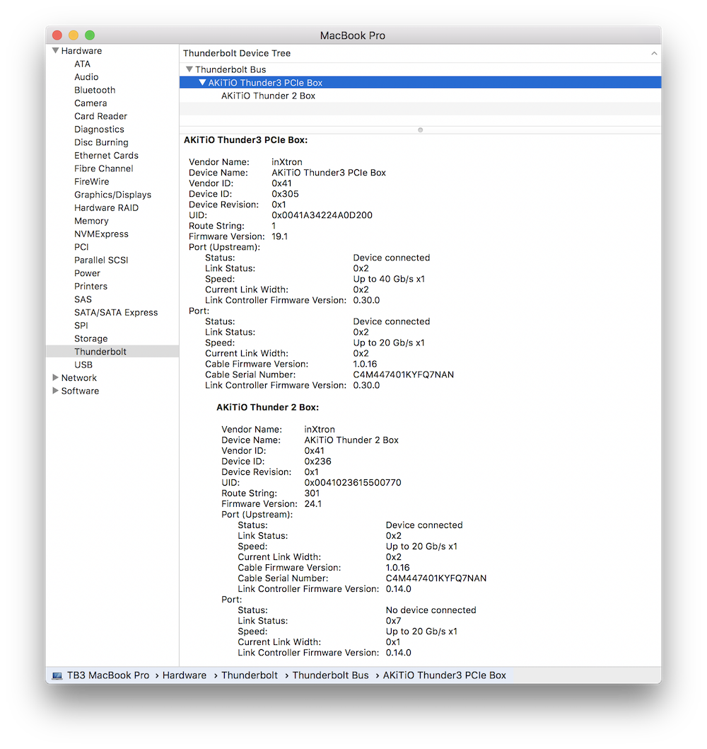

I tried hooking up an AKiTiO Thunder3 (which uses the same TB3 and PCIe board as the Node) to my 2015 MBA using the TB3<-->TB2 adapter. It does not work.
Many others with the TB3 MBP have found Unsupported message when connecting TB3 enclosures directly. This is a software limitation Apple put in place in macOS. Same hardware setup work great in Windows.
There's a workaround which involves hex editing to make macOS talk to Thunderbolt 3 enclosure.
How do you know it's an intentional software block? Apple stated that they don't support some of thr first gen TB3 chipsets found in some peripherals.
