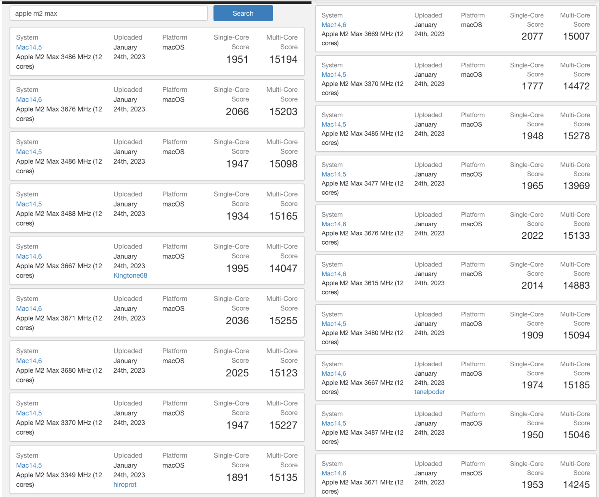

Here's a screenshot showing most of the first page returned by a search for "apple m2 max" in Geekbench's Recent Results (14,5 = 14" M2 Max MBP and 14,6 = 16" M2 Max MBP).
Even with the variation, it can be seen there is a systematic difference in base frequency between the 14" and 16" Max's—they appear to be 3.5 GHz (same as the base M2), and 3.7 GHz, respectively:
14": 3.5 GHz (6 results); 3.4 GHz (1 result)
16": 3.7 GHz (7 results); 3.6 GHz (1 result)
Scanning two more pages showed essentially the same thing, which gives about 20 results for the 16" M2 Max at 3.7 GHz, and 20 for the 14" M2 Max at 3.5 GHz, along with a few that are probably outliers.
I'm going to speculate that the difference isn't because the 16" models had high power mode turned on, since I suspect many who ran these scores didn't bother to do that; if so, the default base frequency for the 16" Max models is higher. That does make me wonder what the effect of high power mode is.
I didn't see this distinction when I searched for M2 Pro results—all models (14,9; 14,10; and 14,12 = 14" M2 Pro MBP, 16" M2 Pro MBP, and M2 Pro Mini) are 3.5 GHz.

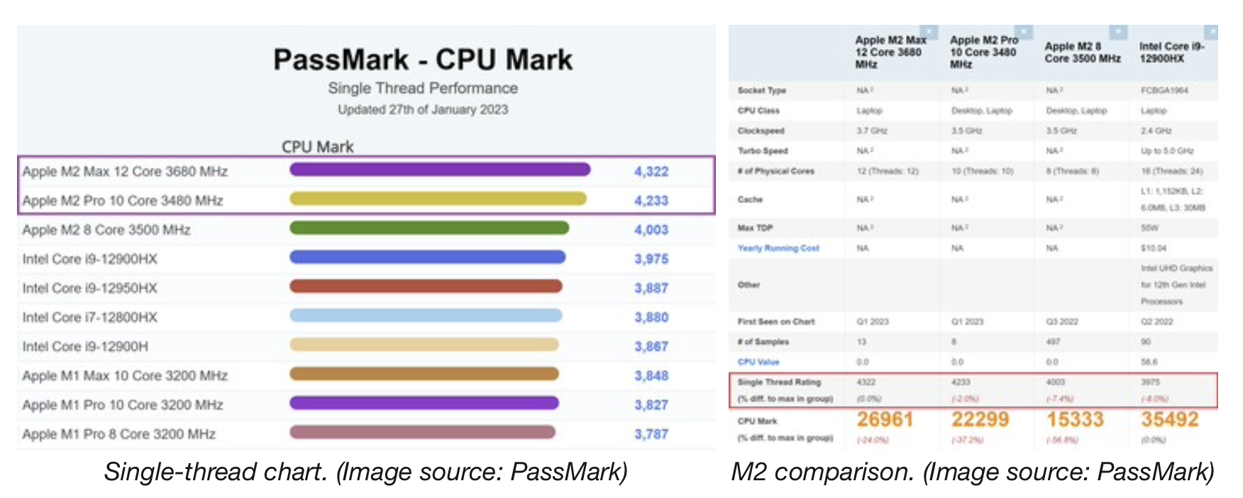

Passmark testing also reports a frequency difference between the M2 Pro (3.5 Ghz) and M2 Max (3.7 GHz).
I'm surprised no one has devoted an article or youtube video to this, since it does seem interesting.
A 6% clock increase but a 2% score increase?
That's not what's important here. A single pair of PassMark results with a 2% difference could be due to run conditions or normal variation. The question under discussion is whether the GB reports of the CPU frequency difference between the M2 Pro and M2 Max are "real". You were skeptical of this, but the fact that PassMark also reports them supports that they are.
Furthermore, if you look the first three pages of recent GB results for both the M2 Max and M2 Pro, pick the three highest SC scores for each (which should be those run under optimal conditions), and average them, you get a difference of {2076, 2075, 2075}/{1971,1970,1970} = 5.03%, which is quite close to the 3680/3480 = 5.07% expected based on the frequency difference.
