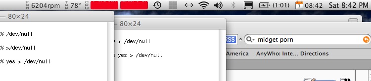

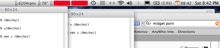

I had coolbook on my first Air and I was under the impression the last Air update wouldn't let CB work? Could be wrong but I don't really want to load and pay for it again on this model. I can say, I ran two terminal windows w. dev/nul and continued to surf and even tried viewing a mp4 show and it still worked w. no jerkiness/ dropped frames or loss in video/audio syncing.

Okay, a few people keep asking for this. Ran two terminal windows w. yes >/dev/null concurrently for 18 minutes now. Also ran Handbrake today.
Here's the dev/null screenshots:
midget porn WTF!!! 😀 😀 😀
