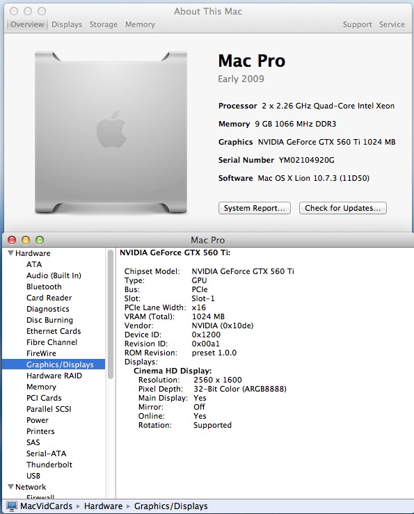

Just tried with an Nvidia GTX560Ti. Worked fine except for EFI boot screens.
Going to try a GTX560 Regular next, it has HDMI and MDP.

Just tried with 560GTX that has HDMI and MDP.
It's a No GO on the special ports.
The lower DVI port works, but it seems that the further something deviates from Dual DVI, the less likely to work.
If you have a look at last 2 Quadro cards they put out, they had to reduce outputs to 2 only on Mac card.
The whole basis of Mac Nvidia display drivers is for 2 ports only. Bit of a curse really.
MDP and HDMI will likely require other help.

Better news than I thought
I had been playing with that GTX560 and trying different ROMs on it.
Once I put the factory ROM back on it, the Displayport and HDMI started working. Quite likely indeed that it will run Apple Display.
Once I get it on my 1,1 which is with the 27" ACD I will post verified results.
I doubt very much that Audio will work over these connections.
As far as installing on a 1,1, a series of right clicks and "show packages" will show you:
/Volumes/NVIDIA Drivers/270.00.00f01 Web Release.mpkg/Contents/Packages/webDriverPayload_SVSSJ.pkg/Contents
In that final "Contents" folder are the kexts themselves. You can use Kexthelper, Kextdrop, or just drag and drop them into S/L/E, you will just need to do a repair permissions after to get them working, then reboot.
