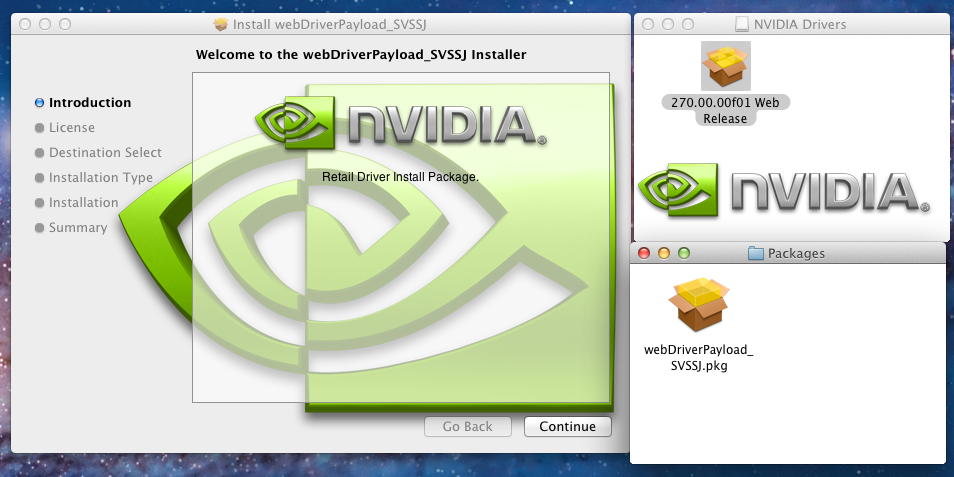

Just tried it on my Mac Pro 1,1 using an EVGA GTX 570 without helper card. I noticed you don't really need kextdrop or kexthelper, I was able to open webDriverPayload_SVSSJ.pkg and installing it with no issues. No need to go inside and drop the kexts manually.
I did the ATY_init and kext fixes initially, but after realizing I could install this, I deleted ATY_init and installed.
Thanks for all the info 🙂
(I attached a screenshot of Sys Profiler and one of the installer.)
