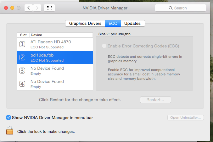

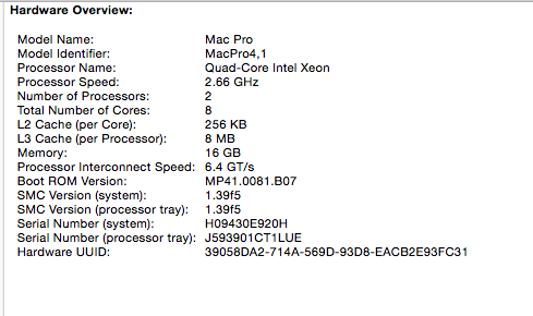

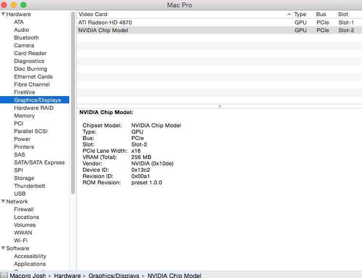

I've got some questions about the GTX 970, or rather I should say that I got one thinking an install would be somewhat simple and have discovered that I cannot get the system to boot with the card in.
I have an early 2009 Mac Pro. I've installed the NVIDIA Quadro/Geforce drivers for Yosemite 10.10.2. I've installed the CUDA software.
When I swap out my old ATI Radeon card for the GTX 970, the black screen persists (as expected) until boot is over. Then, a gray screen with a mouse appears for 10-15 seconds. Then the computer restarts. I can find no way to break this cycle.
I'm using the two 6-pin power cables from my ATI Radeon card and I tried the 970 in several of the PCIE ports.
I've discovered I can boot using the Radeon 4870 AND the GTX 970 as long as the power cables are attached to the Radeon. I assume this means that the 970 isn't getting enough power to perform, so the system never switches to it. Under that setup, the NVIDIA driver manager will recognize that there's SOMETHING in the 970 PCIE slot, but it doesn't recognize what.
I'm hoping someone has some insight! Thanks in advance.

Yes, you don't have Web Drivers installed, without which you got NADA.
Hmm... I installed the NVIDIA Web Driver 434.01.03b01, which is how I got the NVIDIA driver manager. I'm not sure what I'm doing wrong. Also, I foolishly updated my OS the other day, so the Driver Manager won't let me select the NVIDIA driver anymore—it's stuck in OS X default mode.
Is there a different driver I should be downloading? I was under the impression that the Quadro/Geforce drivers for OS X 10.10.2 would recognize a GTX970.
Always update web driver first then OS. You will have to rewind to 10.10.1, sorry
No, that's great news! Thanks man, if it's as simple as heading back a few ticks on the Yosemite clock you've saved me a lot of heartache!
Cool. Just remember when 10.10.2 official comes out you wait a few days for the web driver first then install the driver and then update the OS.
