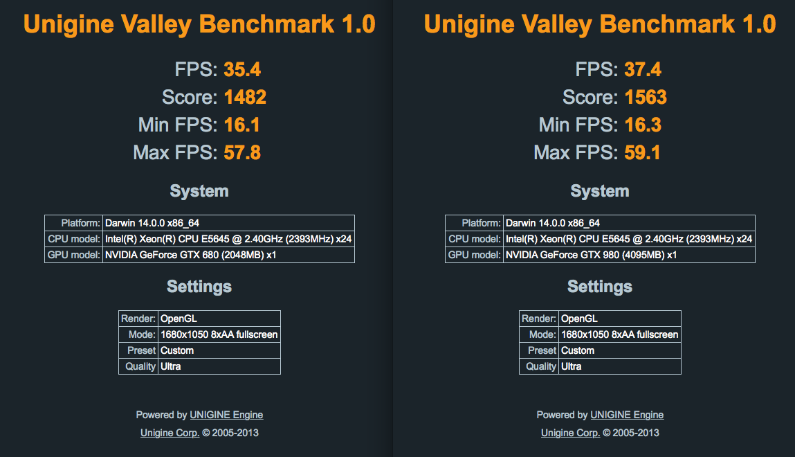

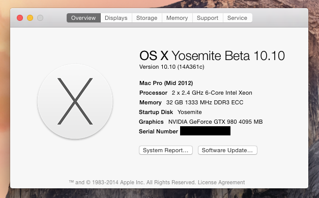

Well, my GTX 980 SC arrived and I am using it to type this right now on my MacPro5,1. Under Windows. 🙄
I'll spend a bit more time with it, but even in these early stages the performance is pretty impressive. GPU-Z reports all is well, except for it appearing as only a PCI-E 1.1 x16 device, rather than PCI-E 2.0 x16. I believe this is a known issue - MacVidCards have certainly mentioned it. Also, no boot screens of course (as there's no EFI support in the card's firmware) and starting Mavericks just puts the system in a reboot loop.
Yosemite works with the beta web drivers, but those drivers are far from ready. I got it through the Valley benchmark, but the results are useless as its obvious some things are not being rendered properly. On an earlier version of Yosemite though.
A very promising start, though. Apple will have to make use of Maxwell architecture cards (and thus provide drivers) soon enough; it's too powerful at such low energy usage for them to ignore. Looking forward to experimenting more!

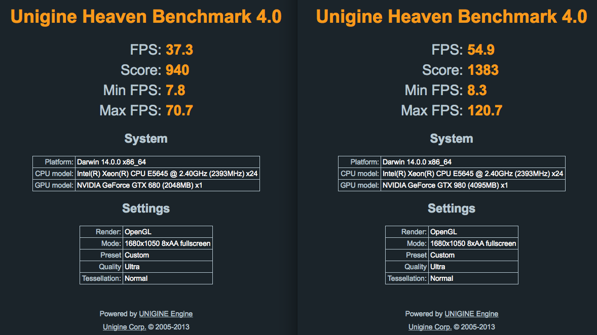

Quick update. The official NVIDIA web drivers are out and working for Yosemite now - just updated them with the GTX 680 installed, then did some benchmarks, swapped in the GTX 980 and did the benchmarks again. Running driver 10.1.43 (343.01.01f01) on Yosemite Final (14A389).
All of the problems I was seeing with the GTX 980 in the beta exhibiting incomplete rendering and artefacts on the desktop are gone. Heaven and Valley benchmarks render properly. However, only MacVidCards and Netkas have PCI-E 2.0 working, so my tests are at PCI-E 1.0 x16 bandwidth, so half the speed it should be.
Seeing good improvements in Heaven, though the min FPS is low - doubtless there's the PCI-E limitation showing there. Much less of an improvement in Valley for the time being. Tests were run full screen on my little 1680x1050 panel, Ultra quality, normal tessellation, 8xAA.
