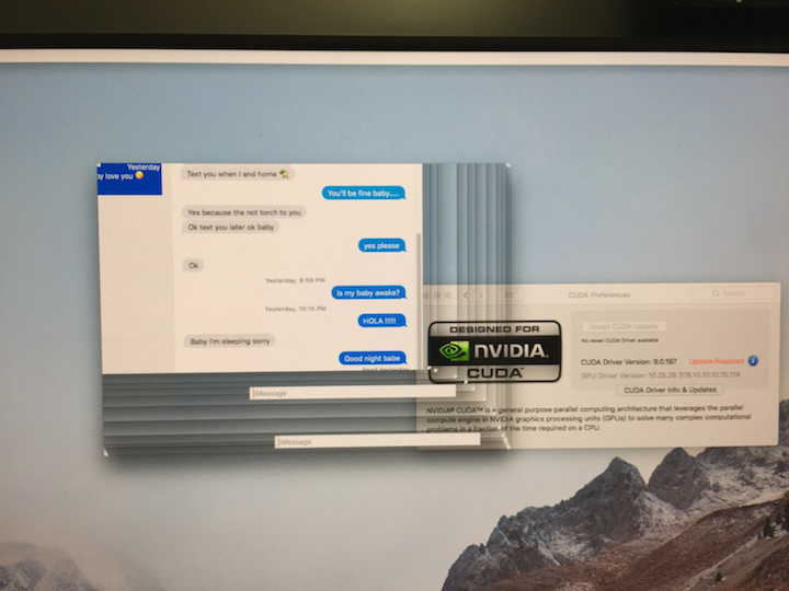

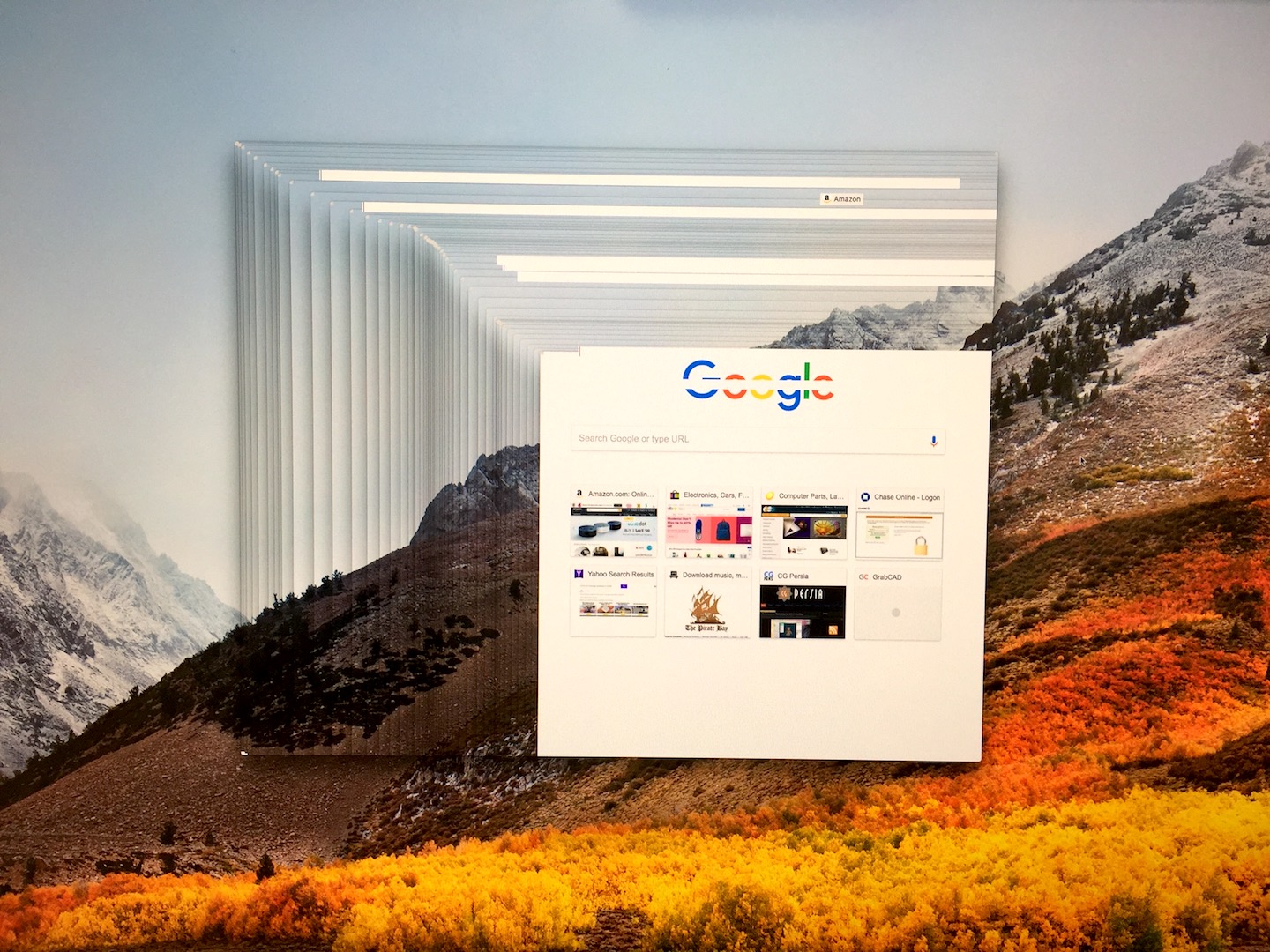

New Nvidia Driver for High Sierra: WebDriver-378.10.10.10.15.114.pkg
http://www.nvidia.com/download/driverResults.aspx/125379/en-us

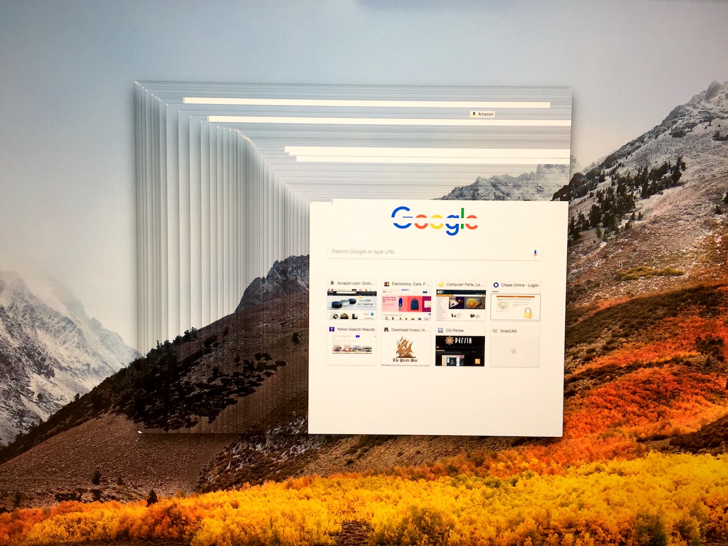

OS: macOS High Sierra 10.13 . (NOT 10.13.1)
It's kind of working but pretty buggy. If I drag a window it leaves window traces all over the screen until you click on a blank desktop area. Lot's of glitches.
But to be fair to Nvidia. Each time I've run the driver install it stops half way and say's there has been an error installing. It then asks if you want to quit the install or try to continue. I hit continue and it seems like the install finishes okay. Buy it's pretty obvious all is not well.
But we are one big step closer. You can't expect too much with a Beta OS combined with a Beta GPU Driver.
But it is working..... Kinda
Mine don't have that issue.
You probably need to remove your GT120.

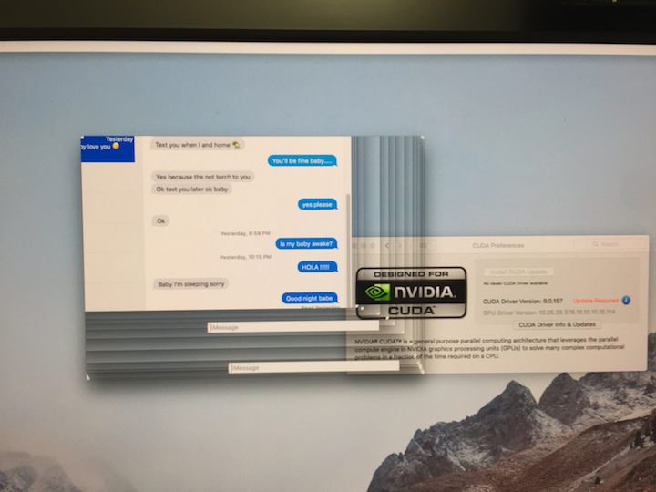

i will
Can you screenshot the issues DR Stealth?
[doublepost=1506747983][/doublepost]Oh and are you still running the 5k screen?
Screen shots don't work for these glitches. The screen shot looks perfect without the glitch showing. So I used my cell phone. No I'm not using the 5K Dell, I RMA'd it due to too many issues. I'm now using a new Dell 32" 4K UP3216Q that I just received a couple days ago. This isn't a random occurrence. It happens on every window move. I'll remove my GT-120 as Prince134 suggested and see if that makes any difference.

Screen shots don't work for these glitches. The screen shot looks perfect without the glitch showing. So I used my cell phone. No I'm not using the 5K Dell, I RMA'd it due to too many issues. I'm using a Dell 32" 4K UP3216Q that I just received a couple days ago. This isn't a random occurrence. It happens on every window move. I'll remove my GT-120 as Prince134 suggested and see if that makes any difference.
Woah!!!! That's weird!!!

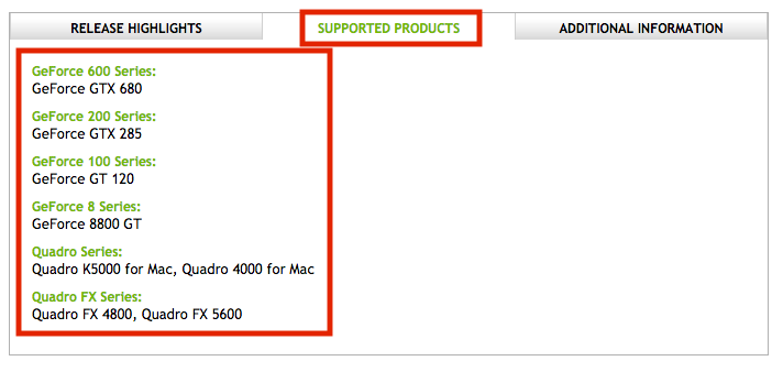

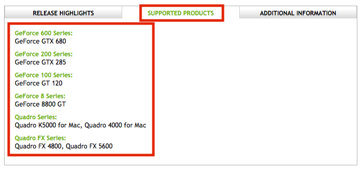

Well after looking into this a bit more here's what I believe is going on (In my case)
The new driver WebDriver-378.10.10.10.15.114.pkg only officially supports a limited number of GPU's. The 10 series is NOT officially supported. That's probably why I get the error during the driver install and things are really buggy. I think it's pretty funny that the driver still supports the GT-120. So I switched my display's input to the GT-120 and it is able to drive my 4k display at 3840 x 2160 @ 30 Hz. Still using the Web Driver. I get no window glitches with the GT-120, only with the 1080 TI's.
And the new CUDA driver cudadriver-9.0.197-macos.dmg was released for Sierra 10.12.x NOT HS 10.13. Nvidia say's they'll have a CUDA driver for 10.13 at a later date.
I wouldn't look too much into that, that is what it has said for the drivers since kepler. technically it is not a true "official" support, those cards listed are the only cards nvidia ever actually made officially for mac.
We do appear to be waiting on a cuda update though.
OK - First off - The Web Drivers do indeed support Maxwell and Pascal Cards. Check out this link:
https://blogs.nvidia.com/blog/2017/04/06/titan-xp/
Second - Yes, Cuda 9 does not yet work in High Sierra, but Cuda Drriver 8.0.90 does at this moment. If you need Cuda support use the old driver in the interim.
Third - The list of cards you posted are the only OFFICIAL Mac Edition Cards. I am now on my third MVC flashed Nvidia GPU. First was a GTX 570, then a GTX 780 and now a GTX 1080. All have been Gigabyte 3 fan models. All have worked flawlessly with the Web Drivers.
I know some of you are having problems in High Sierra. I don't know why, but I am not.
BTW, this thread has been kept up to date over the years, it was and still is relevant:
https://forums.macrumors.com/thread...out-nvidia-pc-non-efi-graphics-cards.1440150/

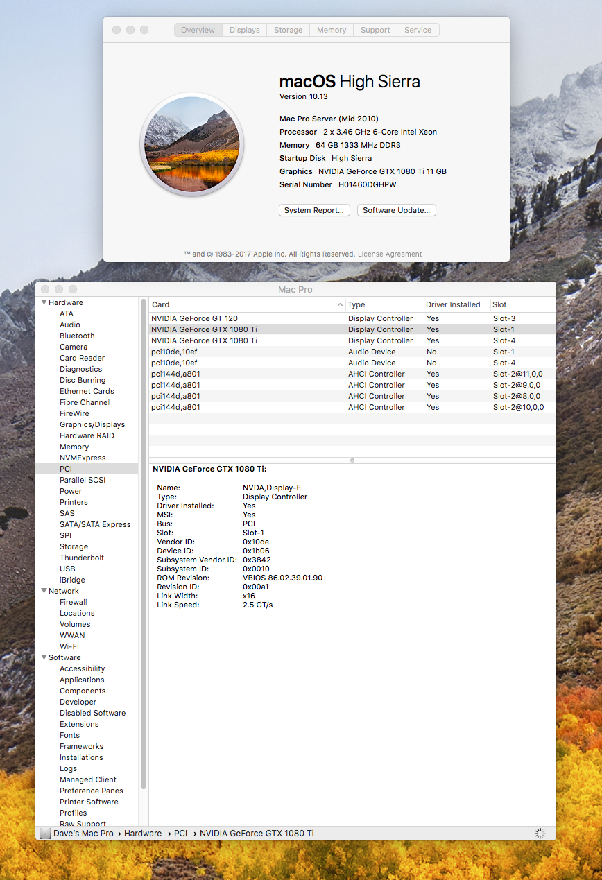

I have a Mac Pro 5.1 (Mid-2010) with a 6-core 3.46, 32GB RAM and a non-flashed 1080ti 11GB video card.
I had to buy a GT120 card to upgrade to High Sierra due to the firmware upgrade. I tried upgrading without a native Mac video card, but I got stuck with a black screen mid-install and was dead for 2 days until my GT120 arrived in the mail today. Popped in the GT120 and finished the upgrade.
In the past, I could just bring up my Mac Pro on my iPad using VNC whenever I did an OSX upgrade, install the nVidia web drivers, and I'd be back in business. Now that I'm past the firmware upgrade, that is my plan for future 10.x releases. (Bring it up on VNC, update the nVidia web drivers, then boot native to 1080ti.)
I did the upgrade, swapped out the GT120 for the 1080ti and it works perfectly. I have a dual screen set up with an LG monitor and an Apple Cinema Display. I can watch YouTube while browsing an iBook and edit a Photoshop CC (2017) image.
I'm not having any of the issues reported on this thread.
I'd go so far as to say that so far, my desktop experience is better and smoother than it was with Sierra.

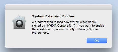

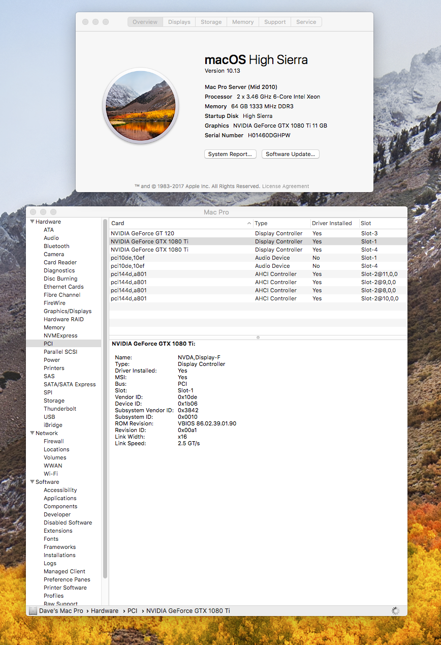

RESOLVED =) ! Enable SIP is the Answer !
Well, I was encouraged by the reports of success with nearly identical systems so I'm going to do another clean install.
I did some Googling and found the answer to my problems.... I had SIP disabled. I never thought this would be a problem but it was, at least with High Sierra. Both the web driver and the CUDA driver will not install properly with SIP Disabled. Two Gatekeeper exceptions need to be added (Security & Privacy - Yes Allow) then both drivers install perfectly, without the errors.
I have no more window glitches and everything is running very smoothly with my two 1080 TI's in High Sierra. :)
This was the error I was getting half way through the install. If you continue the install looks like it finishes but Gatekeeper has blocked needed extensions.
If you enable SIP and run the installer again you will get this....
Then you just go to (Security & Privacy - Yes Allow) and everything works fine !
