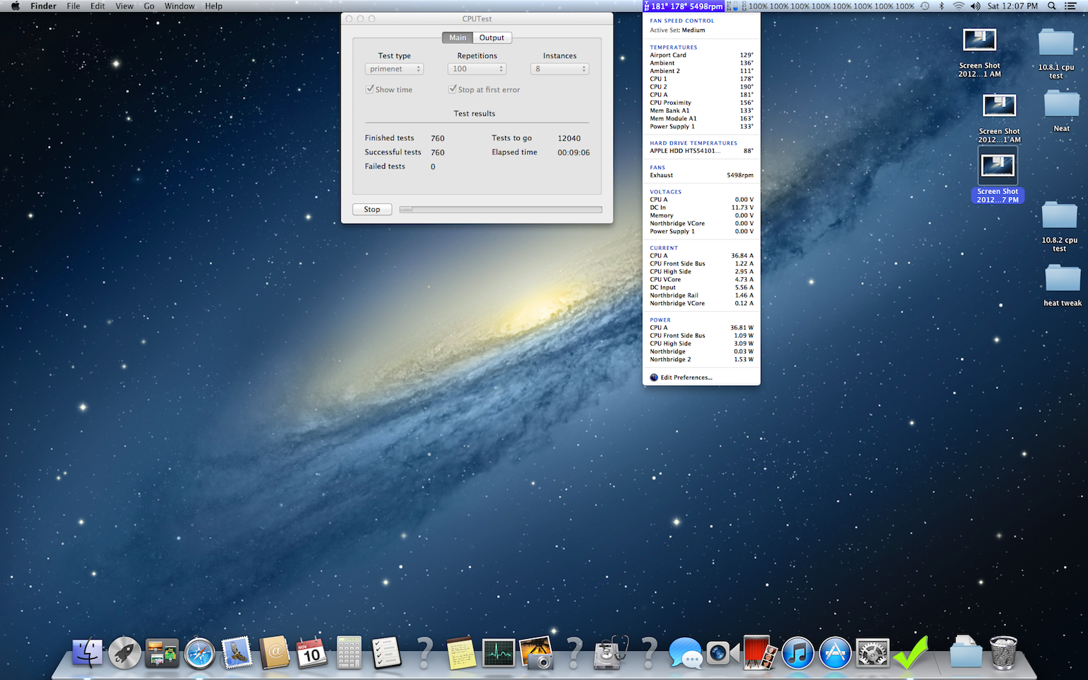

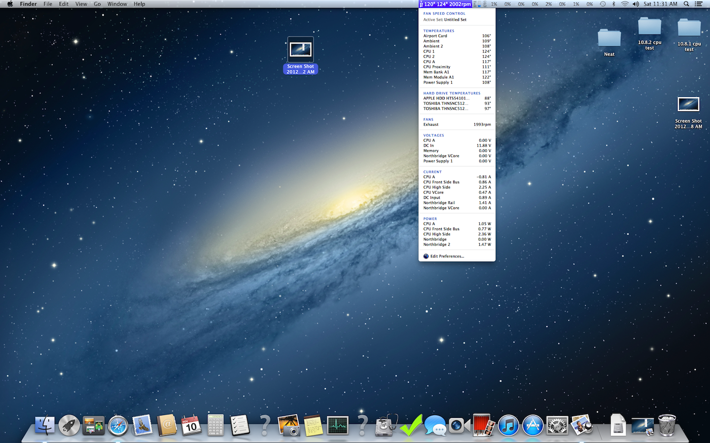

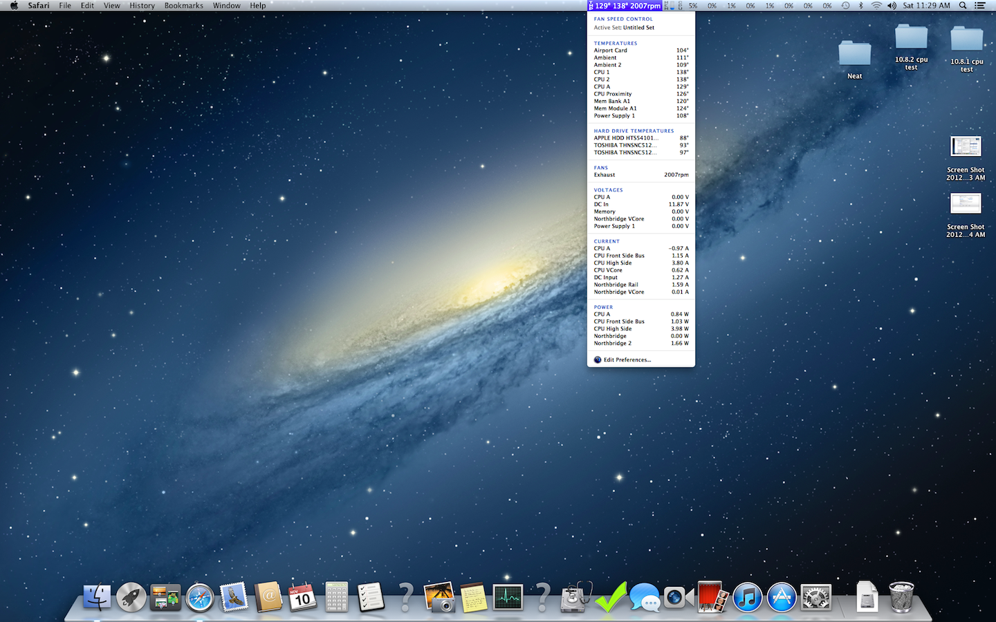

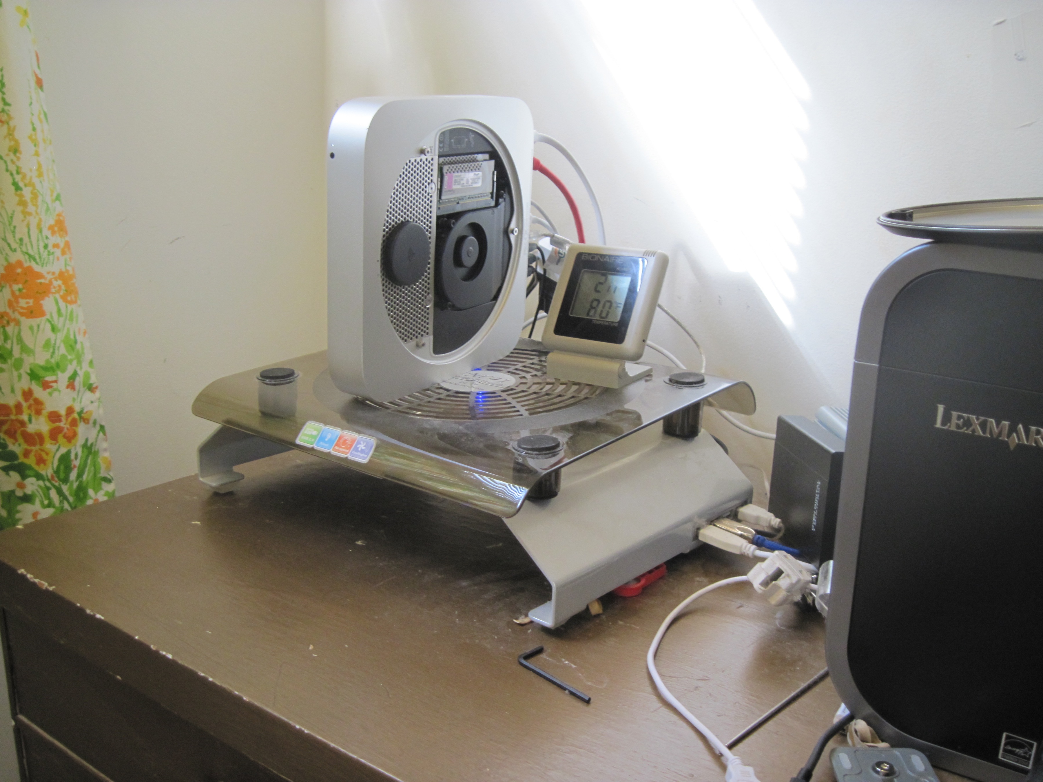

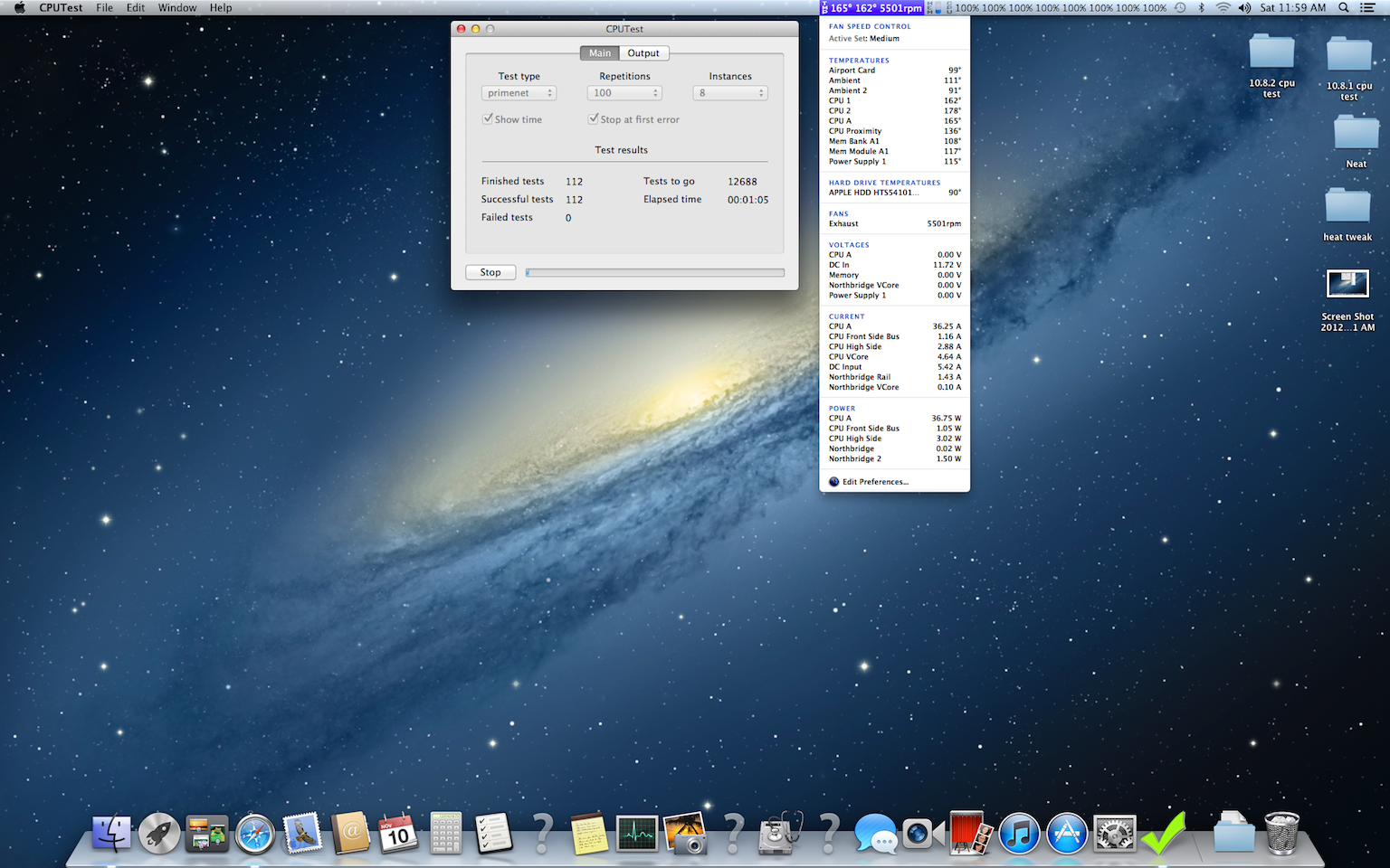

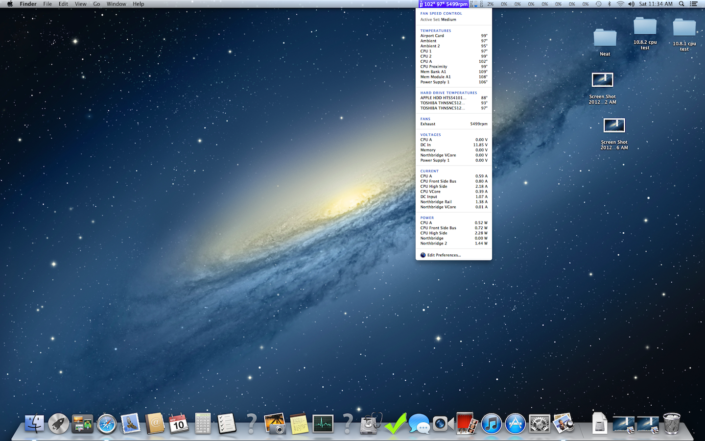

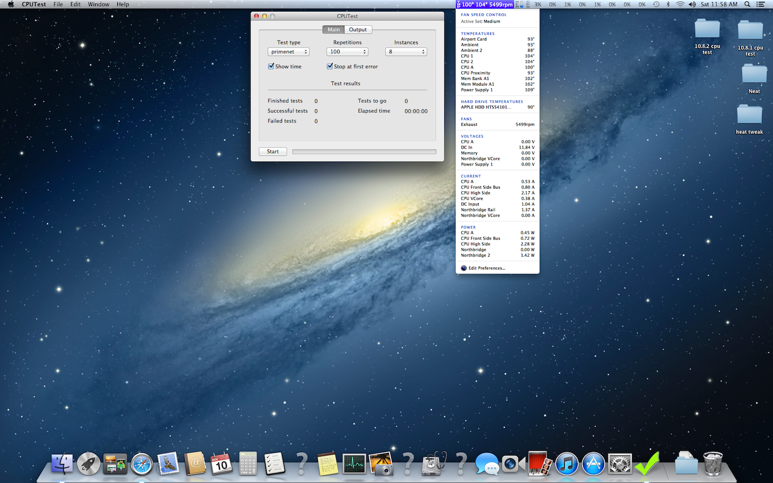

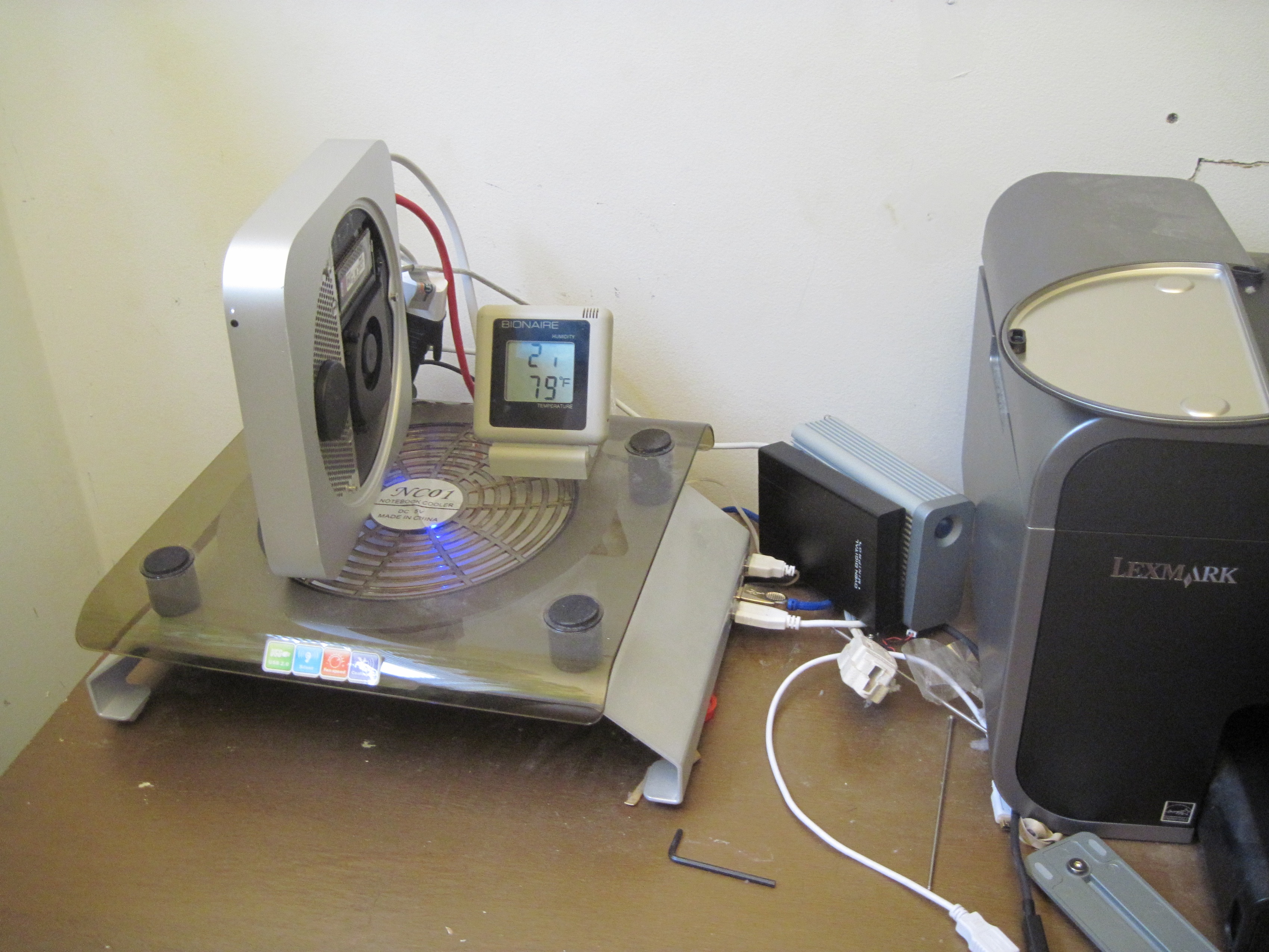

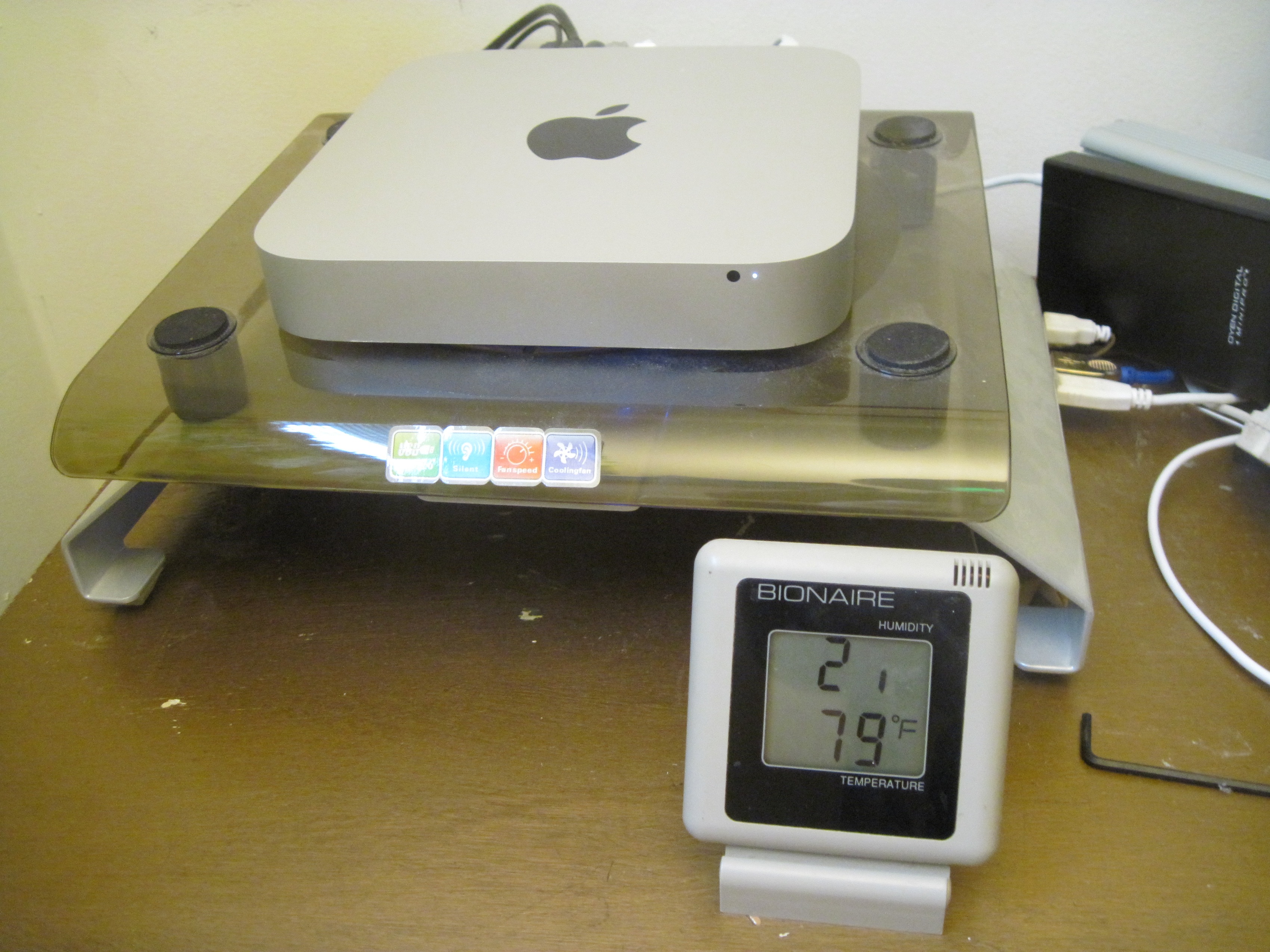

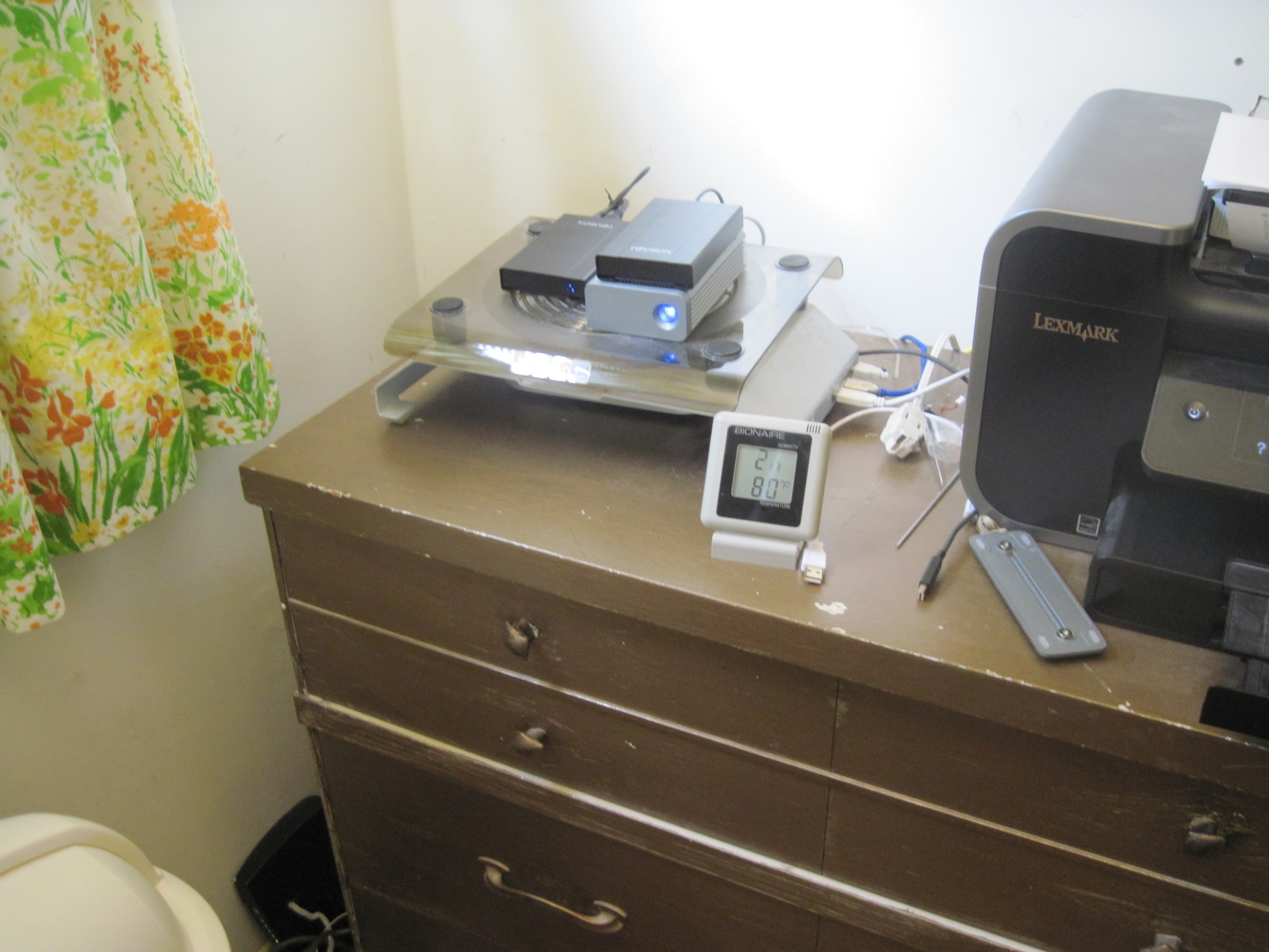

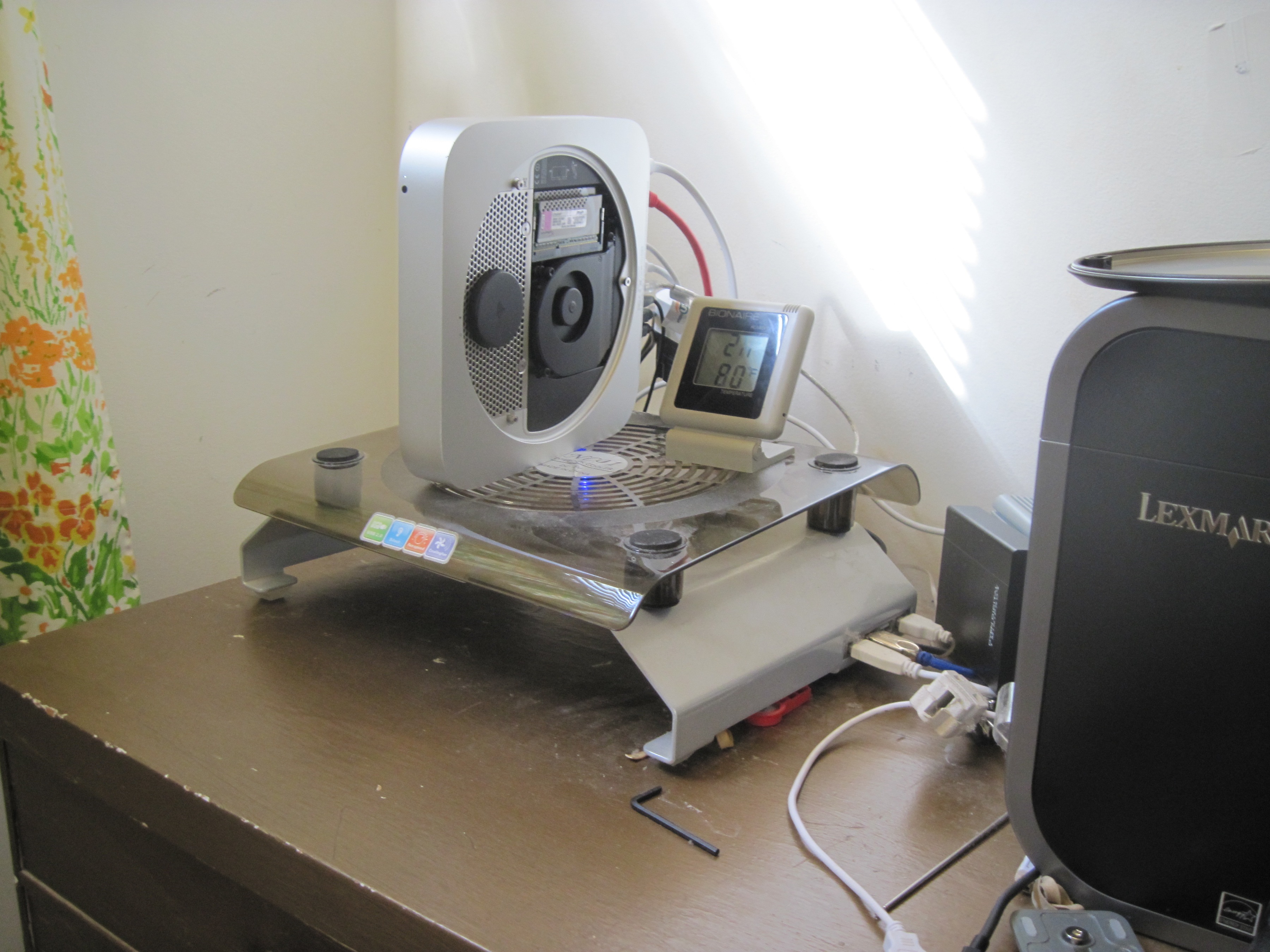

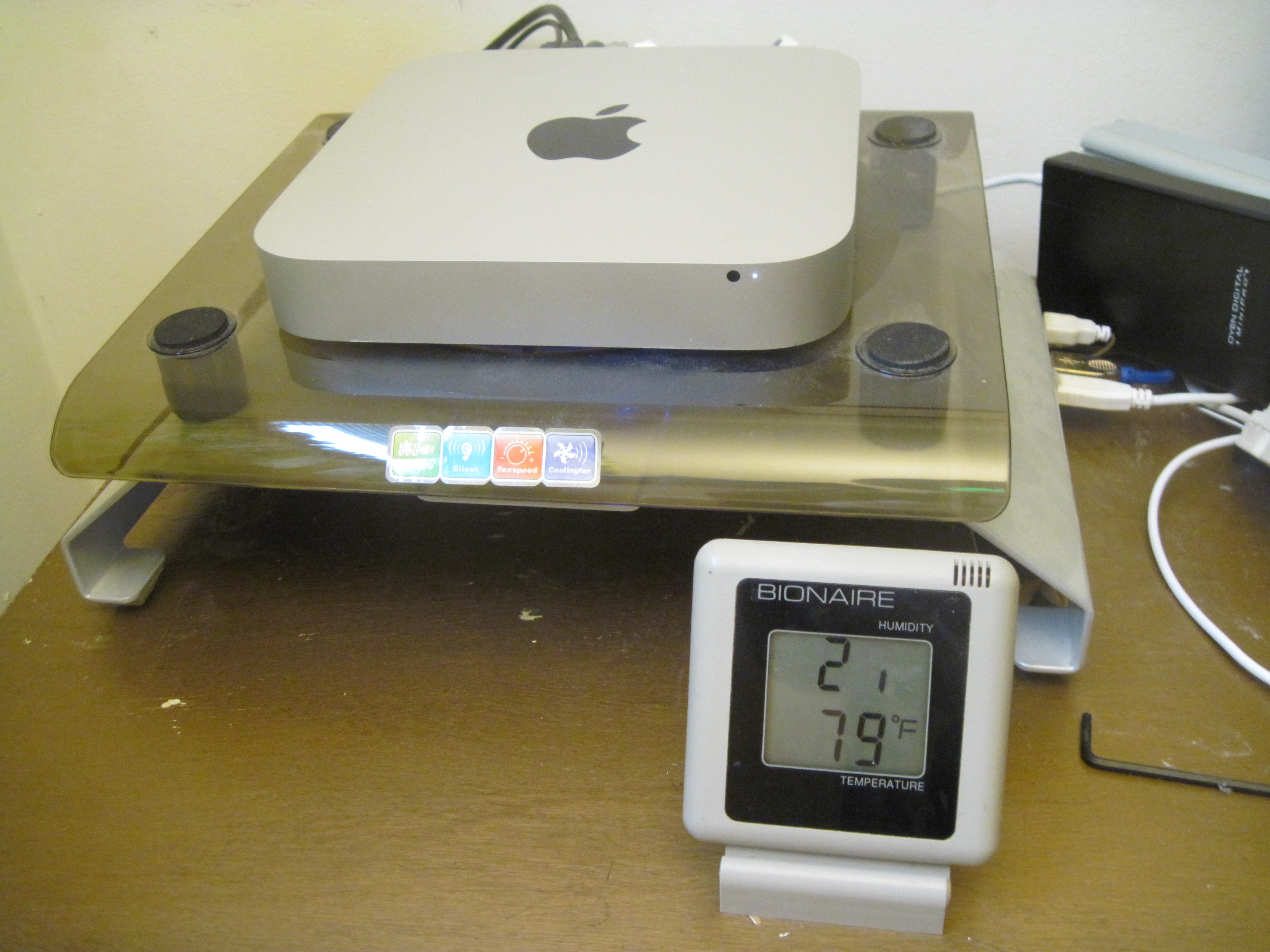

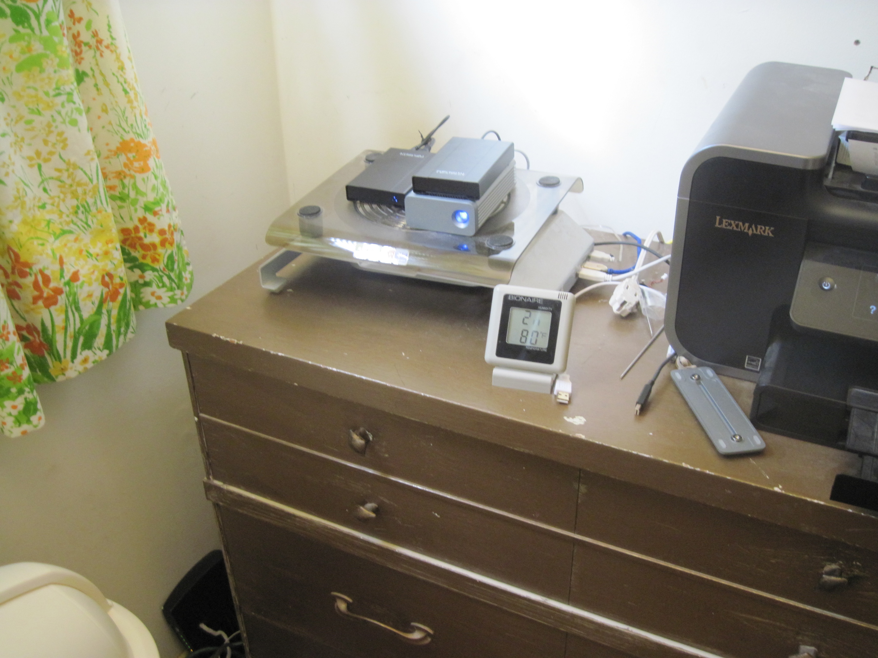

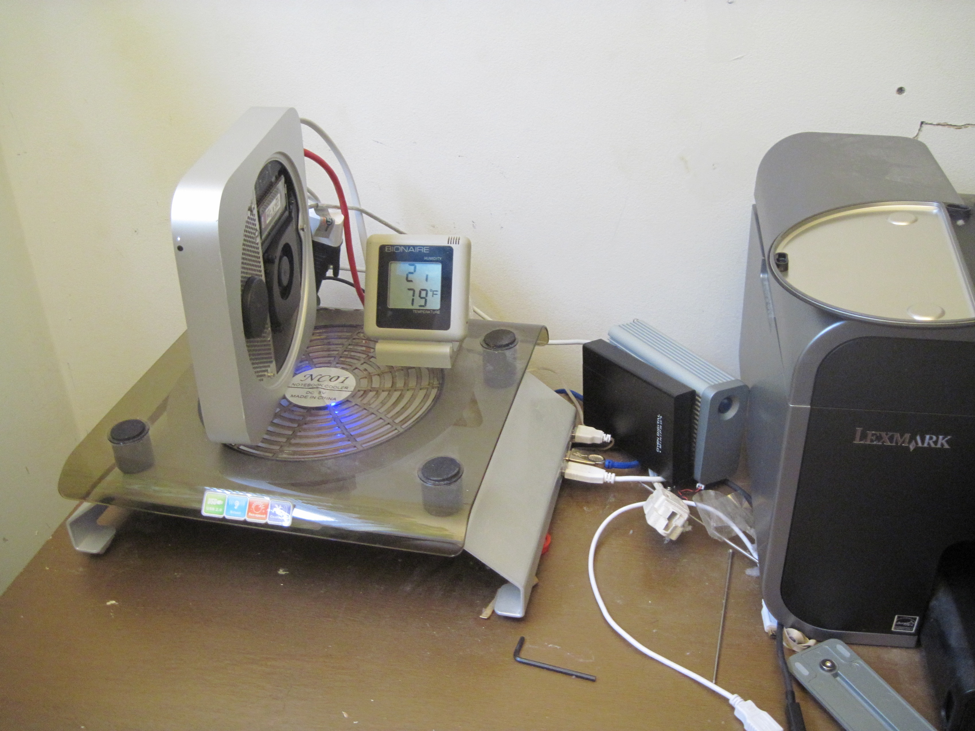

3 screens shots before and after cooling tweak. 2 photos before and after cooling tweak.
this is a 10 dollar tweak ugly but truly function first.
on its side is best for cooling.
but it could be turned on top of the cooling fan.
I am going to run 3 cpu tests. with max fan speed.

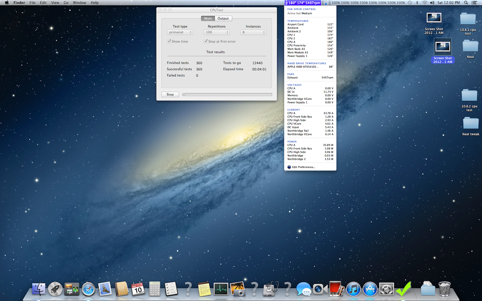

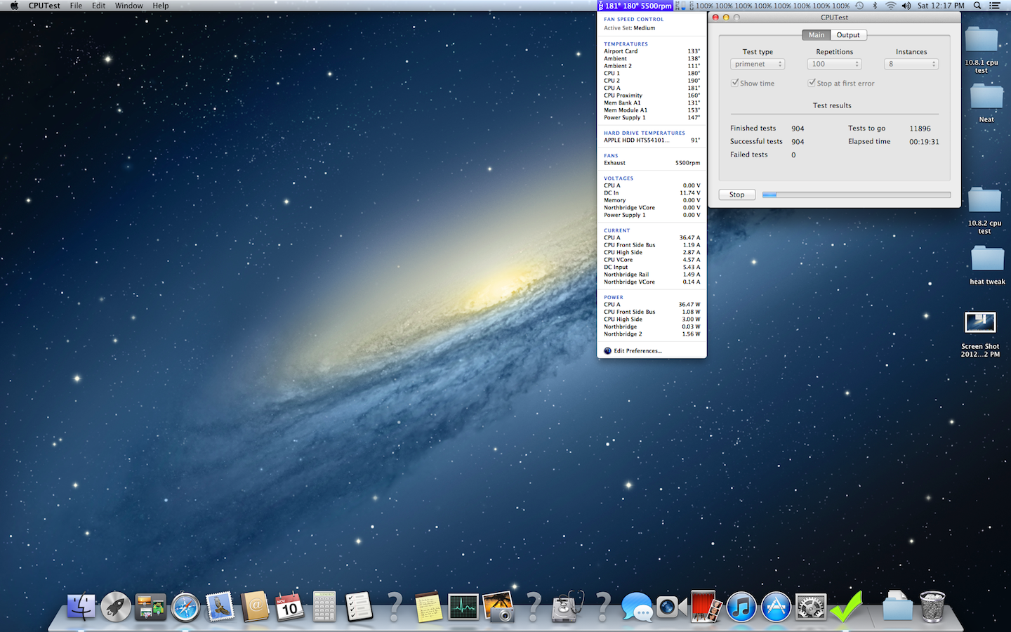

mods my apologies for double post but I want to show many screen shots. well a few minutes in and all is good with proper venting and cooling.
I am about 10 minutes in at this time my temps were 211 to 216 now 190 or less. I failed at the long run (100 reps) of this cpu test at the 1 hour mark and the 2 hour mark I then said stop test and check ram.
I still believed the problem was heat more then anything else. I will post this test until 1 hour or until it fails.
At one hour I will turn the mini down to be less ugly but it will still be on the laptop cooler.
It may go higher then the 185-190 it has been doing on its side. It may fail. .
If it still works at the 2 hour mark i will put the black cover on the mini and rest it on the laptop cooler.
all spots would be considered good venting or even great venting.
My guess is this will pass the side test and the sitting on the laptop cooler without a black cover.
I think it will over heat with the black cover on sitting on the laptop cooler.
18 minute marked all maxed temps are good. I will post back in 20 minutes or so. well between the 17 minute mark and the 37 minute
mark cpu test got stuck it was maxed at 100% on all 8 cpus but stopped counting higher. so I have become pretty sure that the test is flawed. and yesterdays and the other days failures were test related not heat. i also have been able to see a 25 to 30 degree heat improvement with the machine on its side. I will stop all cpu tests and now do prime95 tests. this is the cpu test without the skin or gui.
link
http://www.mersenne.org/freesoft/
so far it is running with no faults at 190 to 200 c . If I can run it for 1 hour with mini on the side I will try to run it for 1 hour with mini on the laptop cooler.

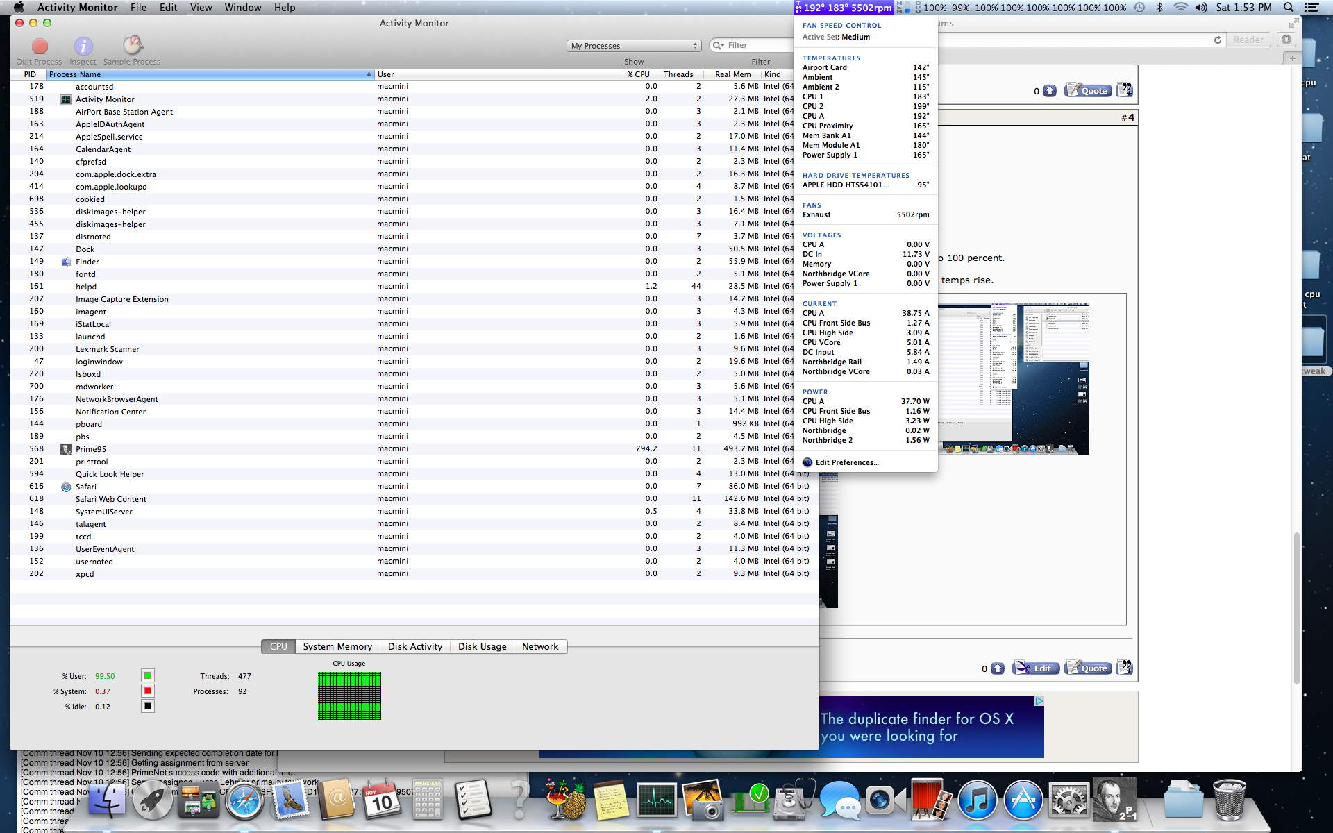

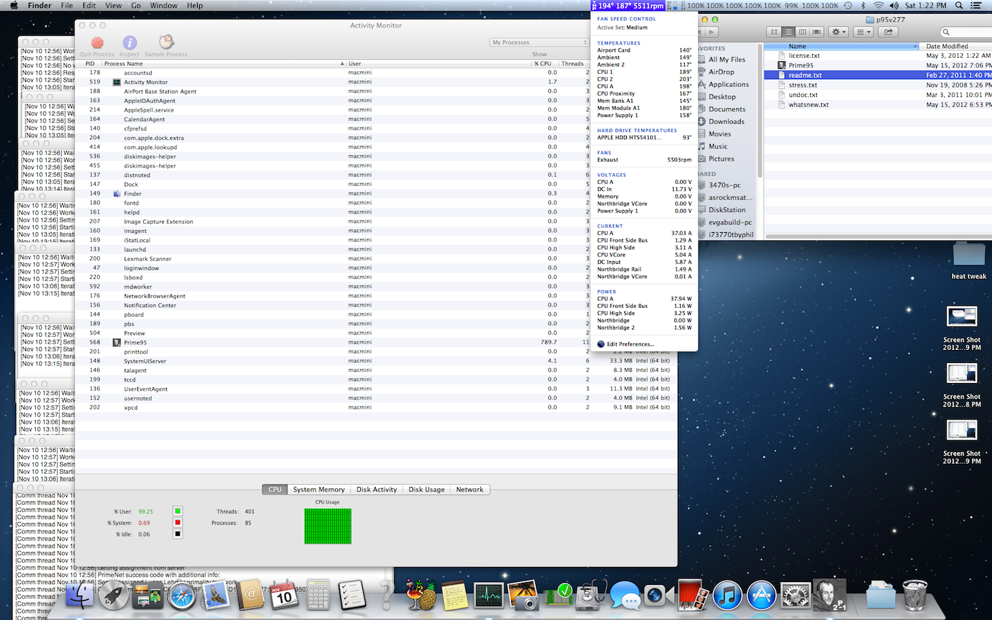

yes and here are my tests with prime 95 as
cpu test is not good.
use prime 95 at this link
http://mersenne.org/freesoft/
I am about 35-38 minutes into prime 95 and my high number is 203f all 99 to 100 percent.
in 20 minutes I will flip the mini in to normal position and see how much the temps rise.

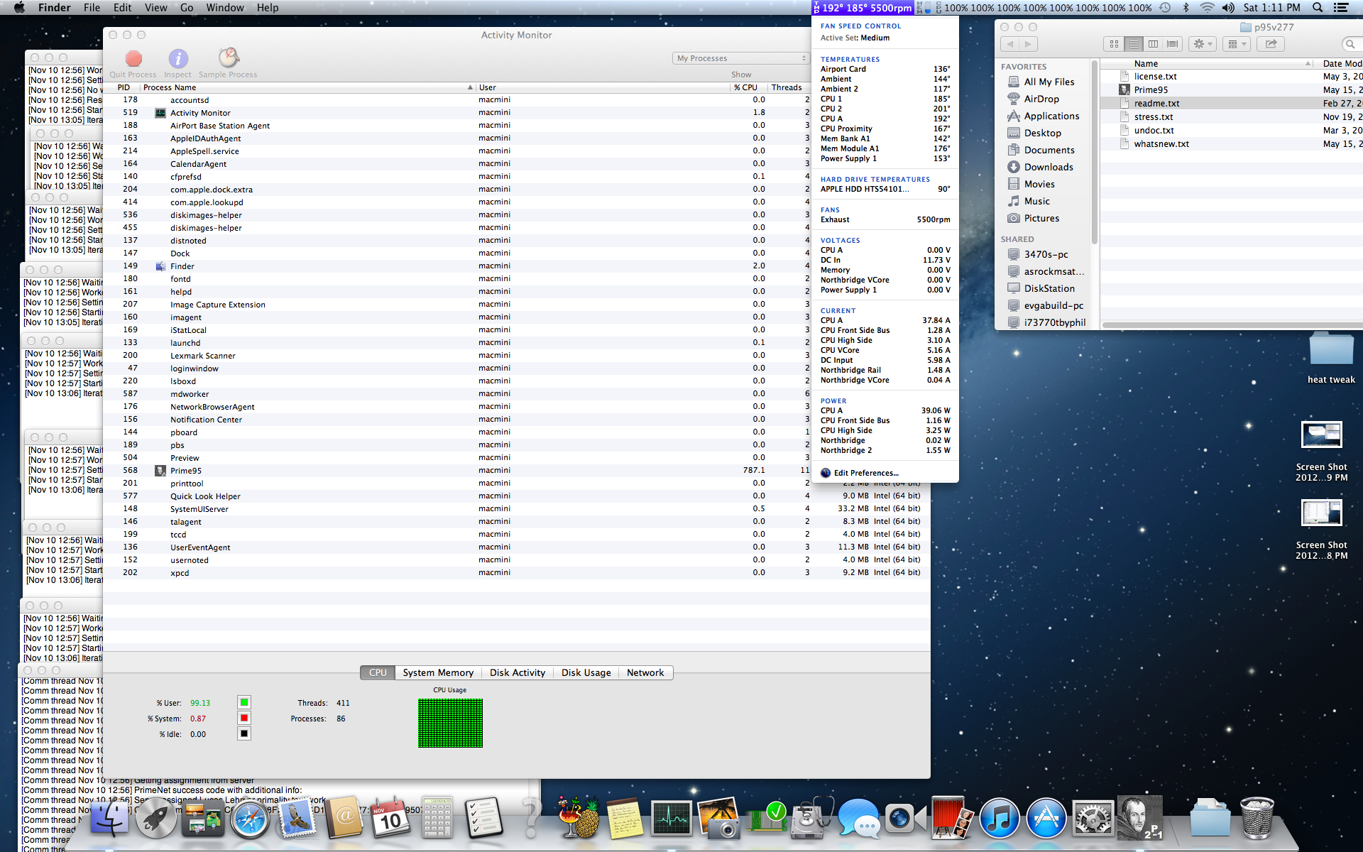

I am 1 hour in.. since all is good I left the black plate off and flipped the mini.

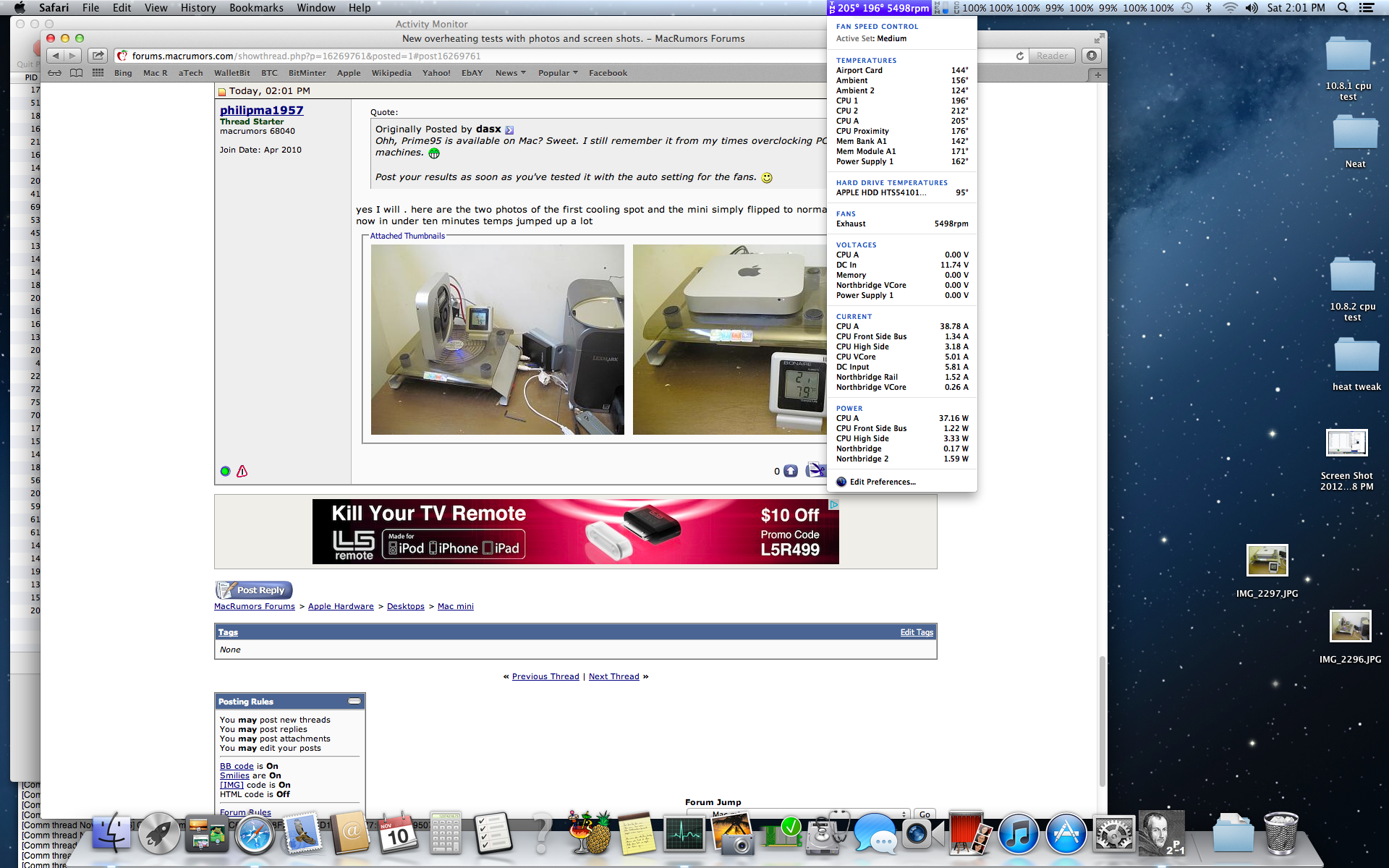

yes I will . here are the two photos of the first cooling spot and the mini simply flipped to normal with no black plate. now in under ten minutes temps jumped up a lot. look at screen shots at 1:51 flipped up and 2:01 flipped down.
down if they don't stabilize real soon this machine will overheat. sitting on an 8 inch fan with no black plate and house temp is 79f.
I am running this same test on a 2010 core 2 duo mac mini wall mounted as i type I am going to check its temps.
it is running at 170f and the fans are only 3600rpm.
but it is wall mounted on its side.

I am now 2 hours in.
here is an interesting tidbit my cpu has had possible hardware errors multiple times even with cooler temps. worker 1 has had more then 1 possible error while worker 8 has been fine.
So my cpu may be a loser
workers 1 2 and 7 have had possible errors.
that is 3 of 8 cores so all my tests may show I just have a bad cpu.
i did quite a few ram tests but I think I am going to put the oem ram back in the mini and re test everything.
one thing is true so far no throttle 2 hours of tests at 995 to 100% with the aid in cooling.
I will put the black plate on right not to see if it gets real hot.
went up a few more degrees still avoided throttle highest temp is 214 to 216 .
but it is sitting on a laptop cooler .
One thing this testing has shown to me is my cpu or my ram or both cpu test and prime95 have a problem.
the possible rounding errors on 3 of 8 cores is not very good. 30 minutes into the test wit the black plate on and I have stopped
at 219f for a max still no throttle. yesterday and the day before I never got past 217 with out the machine locking up or throttle. this was with cpu test not prime95 test. still 219c is about 104c and i am sitting on a laptop fan! I will run this for a half hour more then i will test with oem ram. I would like to know if the ram the cpu or both programs are wrong.
I just put the stock ram back this time 4 cores are failing on the prime95 test.
I am thinking the cpu is defective. which is not good for me . but may not effect other users as much.

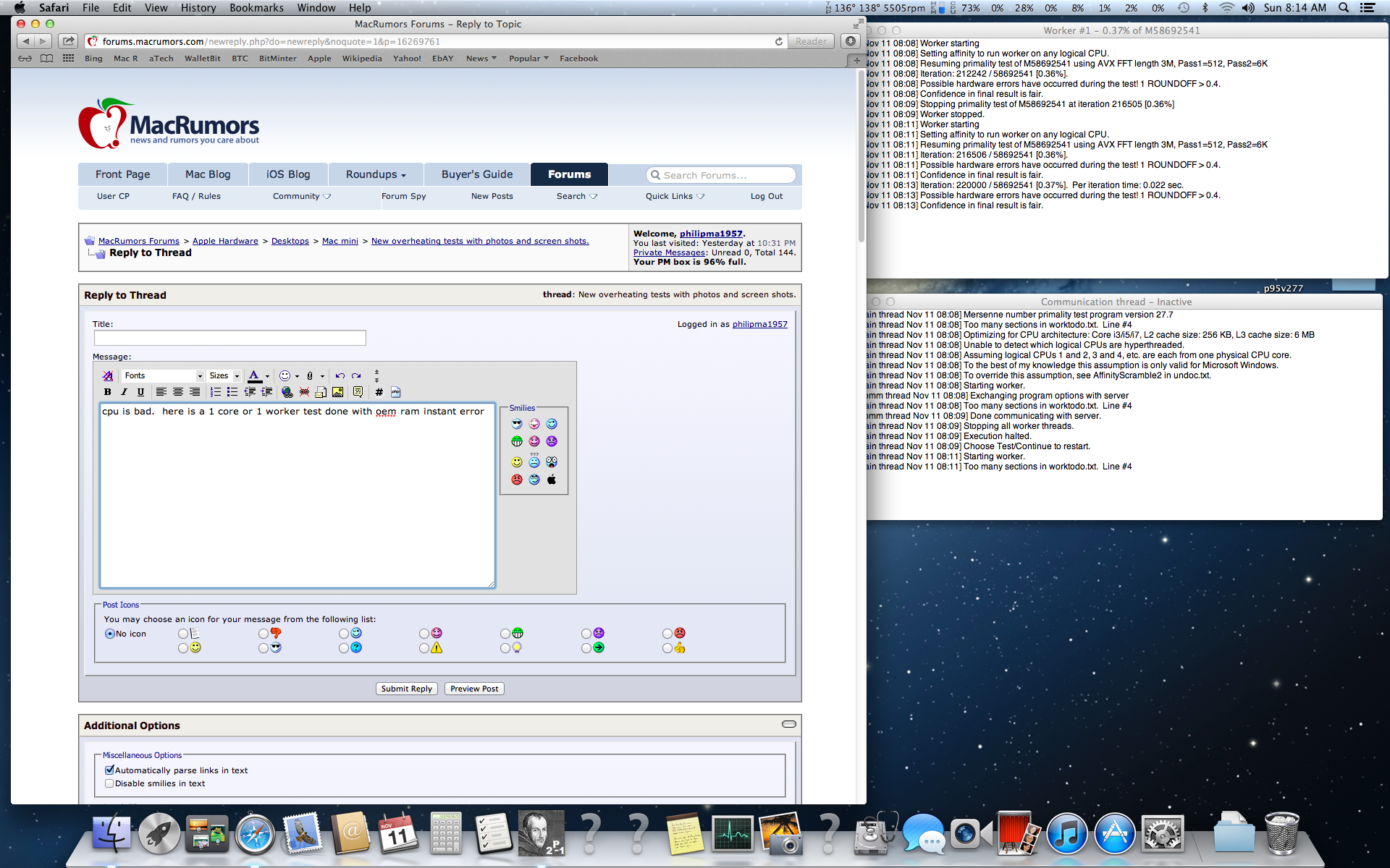

cpu is bad. here is a 1 core or 1 worker test done with oem ram instant error, I set up an appointment at my apple store on monday.
to sum it up
mini fails cpu test
mini fails prime95 test
mini has black screen issue
usb3 has disconnects
usb3 has beach balls used 3 usb cases with 2 different drives
lacies t-bolt has a stutter issue with raid0 or raid1 not jbod same gear works on 2011 mini
used 3 sets of ram for cpu test and prime95 and got the same fails in fact the oem ram had worse results then the kingston.
I purchased at jr.com they don't take returns of opened and used computers so off to apple store on monday.

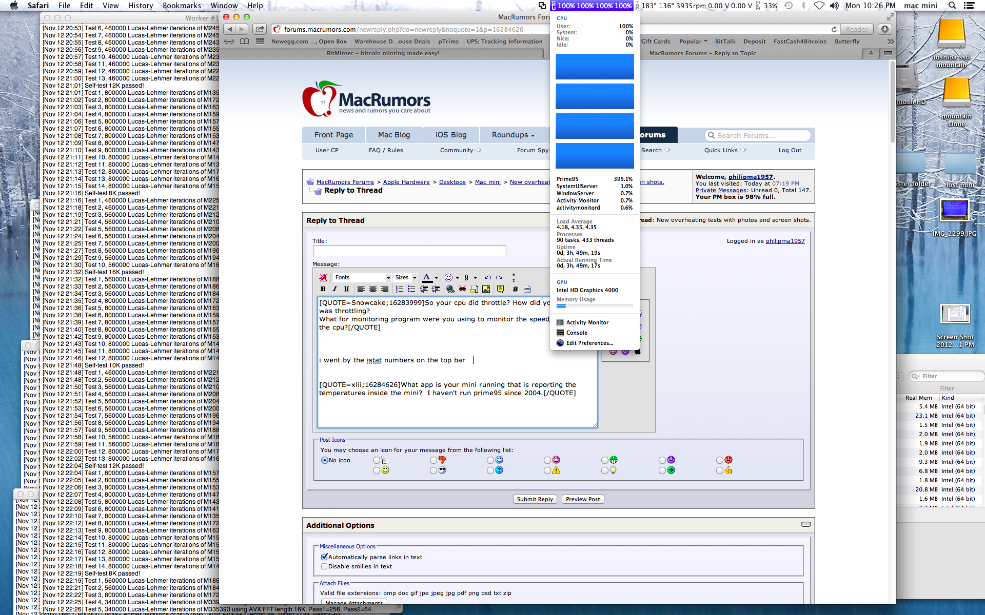

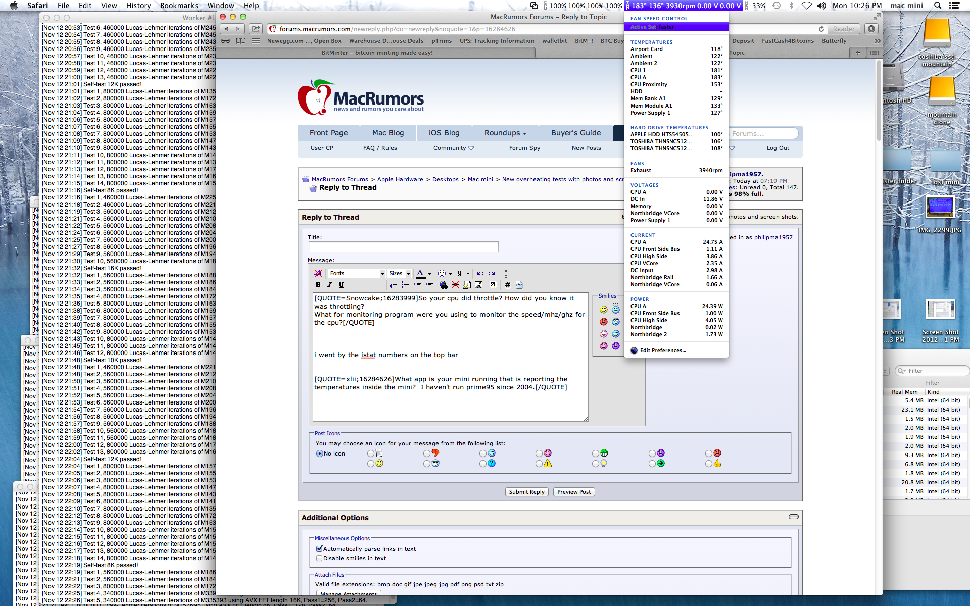

So your cpu did throttle? How did you know it was throttling?
What for monitoring program were you using to monitor the speed/mhz/ghz for the cpu?
What app is your mini running that is reporting the temperatures inside the mini? I haven't run prime95 since 2004.
i went by the istat numbers on the top bar .
the 100% use on the cpu dropped.
the watts on the cpu dropped.
and temps dropped
Since bios is hard to get at in a mac I
inferred that :
1)temp drop
2) cpu use drop
3) watts dropped means throttle.

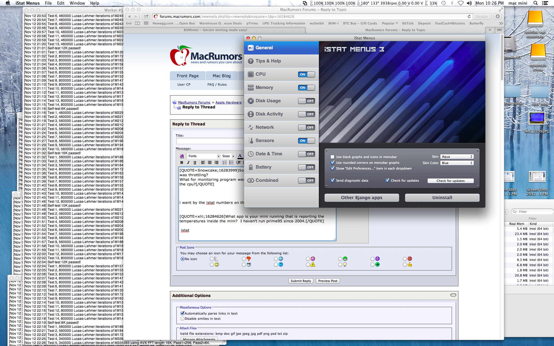

istat menus 3
