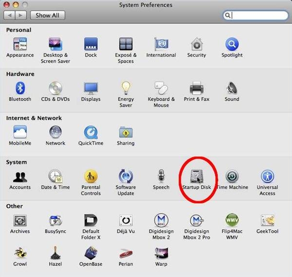

Would anyone recommend carbon copy cloner to make the switch to a Sata Drive?
Also once I've cloned the existing HD how do I go about telling the PPC that I want to use the Sata drive as boot drive? is it the startup page in system preferences?
power cables have arrived so......
CCC or Superduper are fine for cloning.
For startup disk just click on system preferences and click on "Startup Disk" shown circled below. Just select the disk you want to boot from and select restart.
