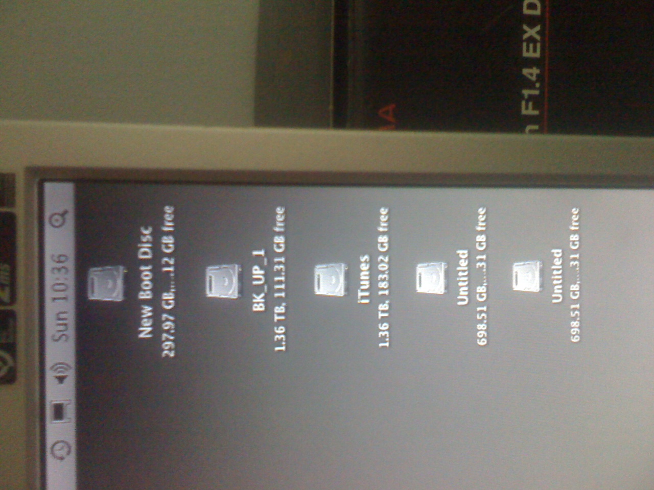

4.8Tb in a MDD
its up and running!!!
4.8 Terabytes over 5 Hd's, 2Gb of Ram, Dual 867Mhz G4 processors and I'm a happy man!

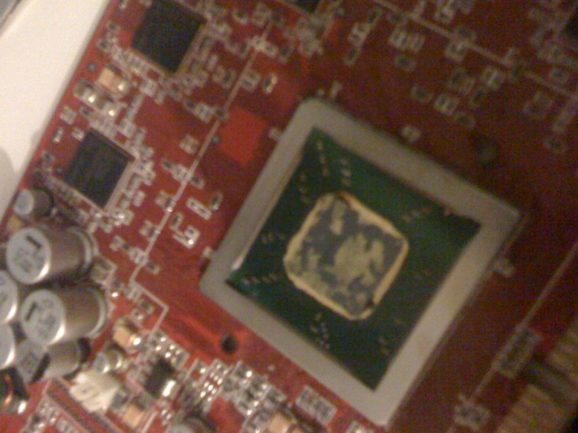

Unfortunately the heat sink/fan has become detached.
Can I use the MX-2 paste I used on the CPU's?
Paste is paste when it comes to CPU and GPU at least. Is the heatsink affixed with the standard double posts on opposite corners with springs? If so just be sure not to crush the GPU because you need to use some decent force to get those posts in the holes. Try to only apply downward pressure on the posts themselves and do them one at a time while also being careful not to move it around so you don't mess up the paste.

well here is the damage.
I cant get the old paste off the gpu as its baked on hard! I've managed to clean the heatsink of the remnants though.
Will applying a layer to the the GPU be enough? Will the remaining contact area of new paste be effective or is it FUBAR?
