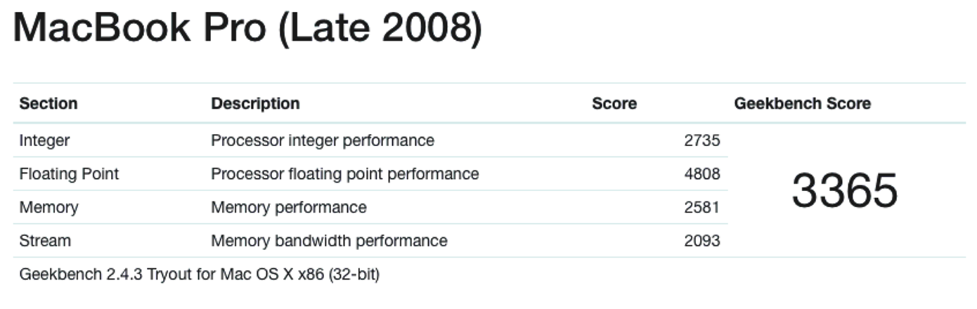

Hi guys, I guess this is the right place to ask...
I just got handed over a MacBook Pro 15" Late 2008, basic spec (c2d 2.4 / 4 / 250). It looks and feels like new, apart from the battery, but I do not need that to work.
I was thinking of replacing the HDD with an SDD, since they have gotten cheaper over the years. Is it worth it? I need the MBP to run El Capitan for some of the apps I use, and the mac struggles with the OS.

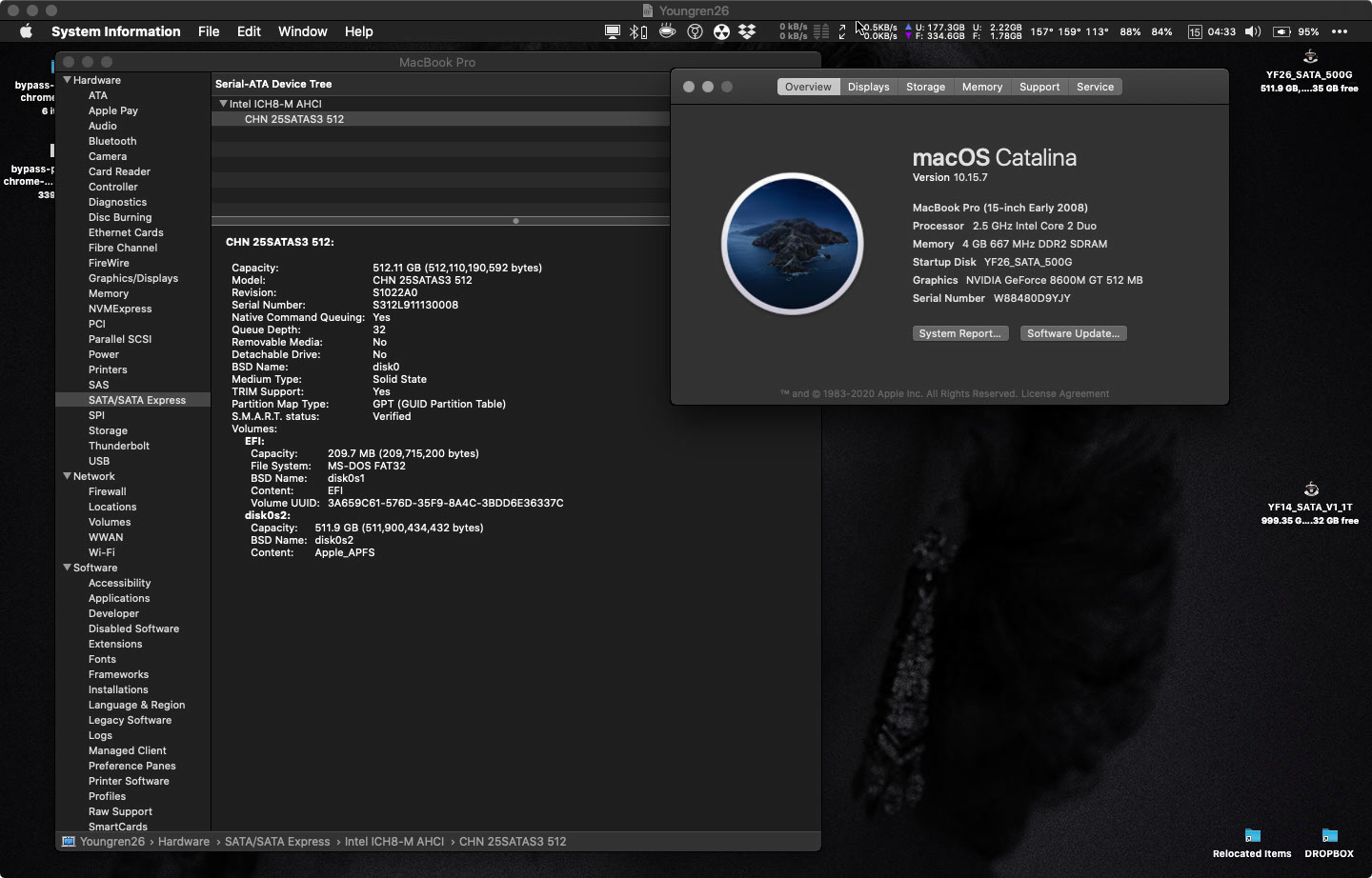

I've got an early 2008 with 4GB ram. It's running Catalina and has a 500GB SSD.
I'm using a Silicon Power Ace A55 2.5" 512GB SATA III and it works fine. Zheino is also a good brand. I have a 1TB Zheino SSD as a boot drive for my MacPro.
Correction: The SP is in my Mac Mini. The SSD in my MBP is a 512GB Zheino.
Might want to max out your ram if you haven't already. My MBP can take up to 6GB ram so yours should be able to do at least that.
