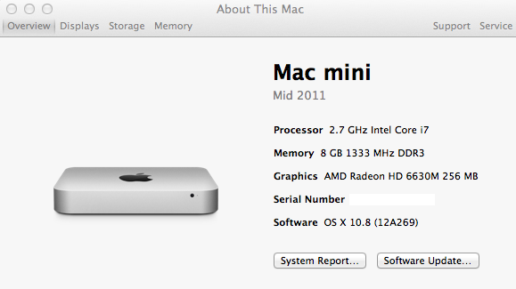

Hey guys.
I've got my Mac Mini-- mid 2011 - see pic for specs.
I already upgraded it from 4GB RAM to 8GB but haven't really noticed a bump in speed like I thought I might.
Just wondering what would be my best bet for upgrading the SSD. I think I can handle it, I found a good DIY video on OWC, unless there are better ones?
Also what size should I go for, 128GB? I don't do a ton of crazy stuff, just some photoshop/lightroom so I figure I can put most my apps on the SSD and could I still use my other 500GB drive as an internal drive or would I have to use it as a USB external?
Thanks for any advice and tips guys! 😀

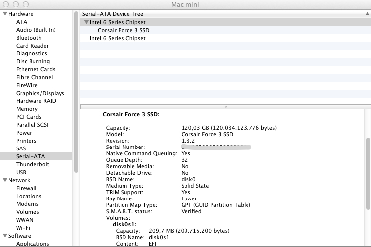

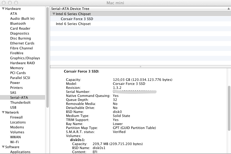

You can enable TRIM on any SSD in Lion.
I did it with my Corsaire Force 3 series SSD, just do this:
http://digitaldj.net/2011/07/21/trim-enabler-for-lion/
