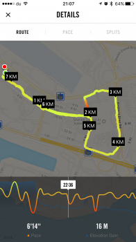

I've just got my new Apple Watch series 2 Nike+ last Friday and used it for running. Used the Nike+ Run Club app (and not the Apple Workout app). Did run without iPhone, so used Apple Watch GPS.
But.... when I go the activities in my Nike Run Club app (new version) no map of my route is showed....
Does anyone do see a map?

I've run 6 times with the Nike app and 1 time the map didn't come through so I can understand how frustrating that is. I would advise (assuming you're on WatchOS 3.1 and iOS 10.1) that you let the Nike app take it's time syncing, as it seems to be ever so slightly delicate. Meaning that if you interrupt the sync, you could lose the mapping info. Just my observations.

I did a run this afternoon and the map did show up this time.
But only in Nike app, and not in Apple Activity app.......
Good that it now shows.
Note, if running with Nike+ app, at present the map will only show in the Nike+ app. Everything seems to be ring-fenced unfortunately. I did manage to get the map exported to Strava, using RunGap, but that's a paid-for option.
The only time a map will show in the Apple Activity/Workout app is when you actually use the Workout app on the watch. The GPS data is stored within the Workout app itself and not Apple Health. That is the reason why you can't export the GPS data from the Workout app to Strava, Garmin Connect, etc. It is also why other apps like Nike Run Club cannot write GPS data to the Workout app.

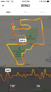

OK. It does show for me in the NRC app post run (red line) and gets exported to Strava using RunGap:
And this is what I get. No heart rate info
Are you running with the phone, or standalone with Series 2 AW? I am assuming with the phone since you are getting elevation data.

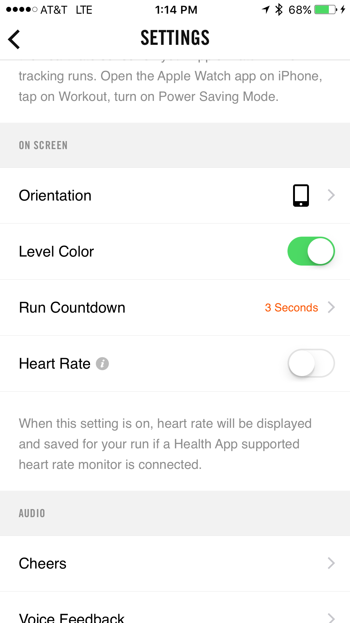

There is a setting in the app to turn on HR if running with the phone. I have it off since I don't run with my phone and it is on by default on the watch.

Is your chest strap linked to your iphone or watch? I've only had success when the strap was linked to the watch.
Make sure you have the "Advanced" button turn on in the NRC app on the watch.
