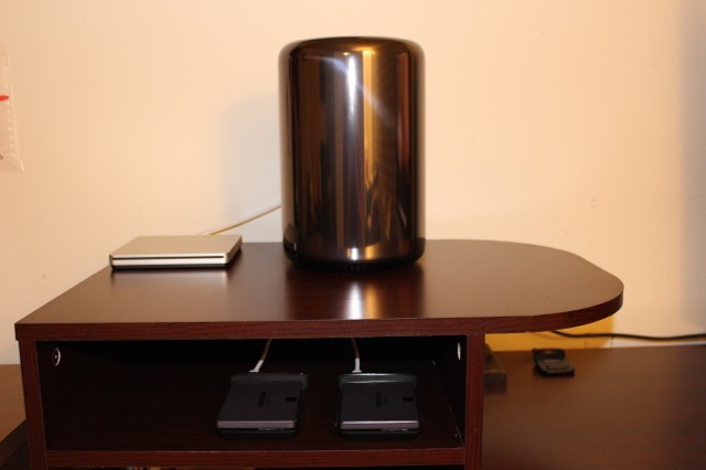

I use a Synology DS212J for my main storage... but I needed additional local storage to supplement my built-in SSD (I ordered stock 6-core). So I ended up using 2 Samsung SSDs (840 EVOs with 250 GB each) on a Seagate Thunderbolt Adapter to supplement my built-in SSD. I'm using symbolic links to redirect my local files (along with my Win 8.1 Parallels file). I've been impressed with the speed so far (but I only received my nMP on Friday).
