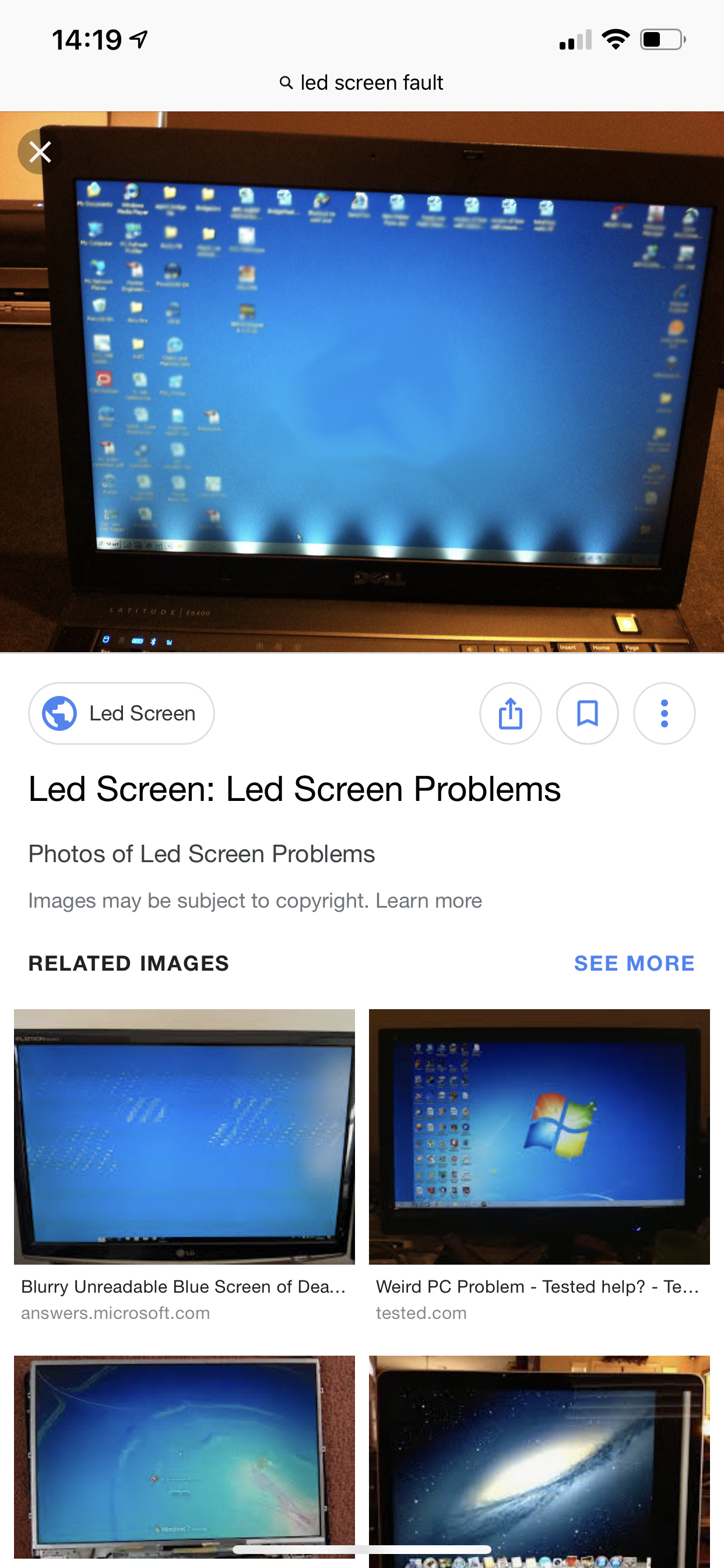

Prior to this, the display also had, what I would describe as, a wave like backlight bleed along the bottom. This occurred about a month prior to the no backlight issue. I didn’t get a chance to take a picture of this but I’ve uploaded a picture I have found with a similar problem.

Because it's 'Apple', you will get ripped off with repair prices. The LCD is a ****** to replace and as such, a replacement screen assembly is the most commonly sought answer. It could also be a combination of things, blown backlight fuse, faulty LCD driver IC, PCH faulty - not sending backlight enable to LCD driver IC (LP8550), lcd flex cable or even the LCD itself.
Cost wise, you could be looking at anywhere between £200 - £400 depending on replacement parts and labour.
Good luck in finding a good quality repair shop who will not butcher your machine because they do not really know what they are doing.
