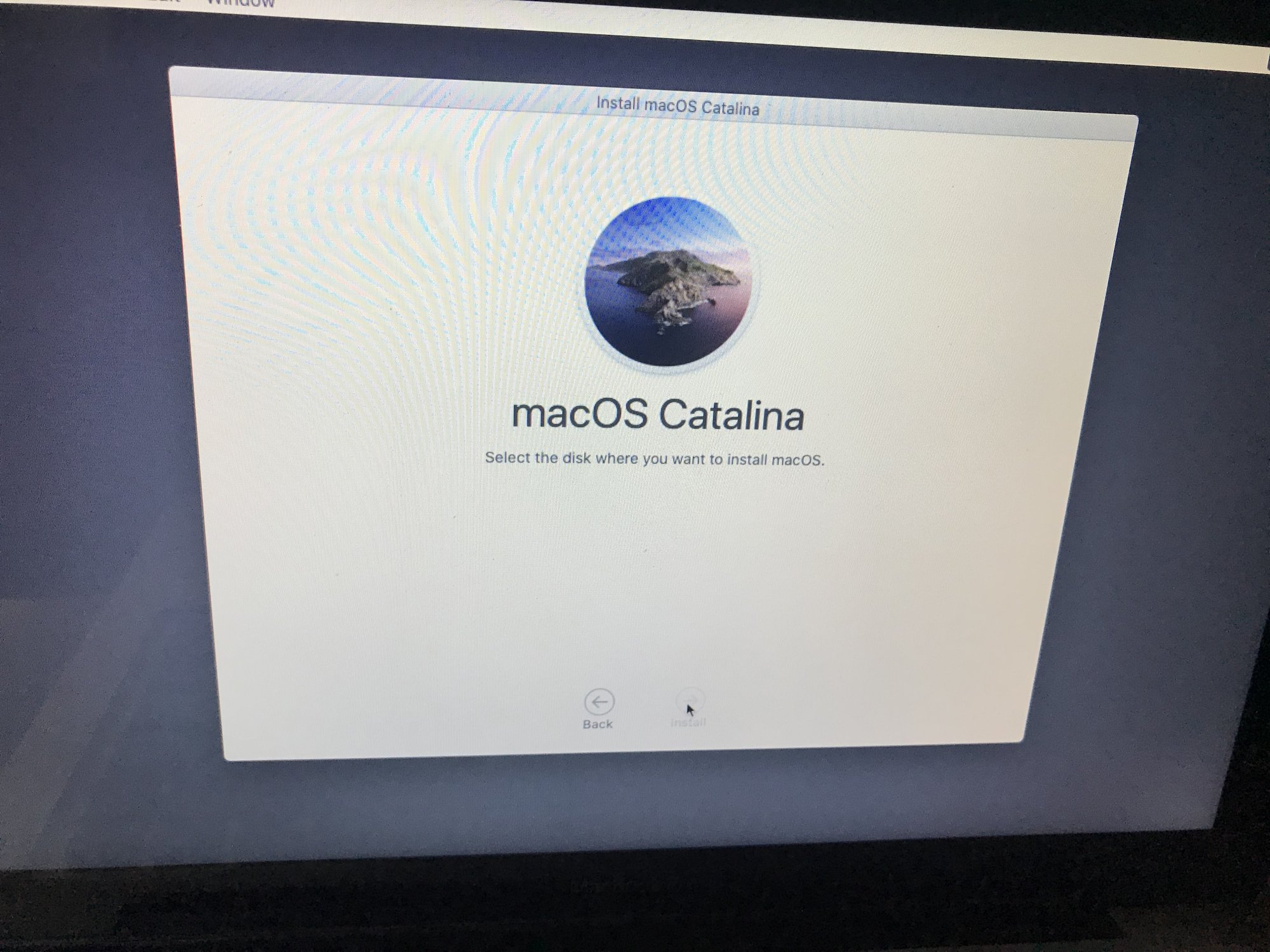

Looking at the second pic you posted (Apple SSD SM0256G Media)...
... What happens if you click the erase button?
What format you erase to depends on what year the MBP was made, what OS it came with, and what OS you're trying to install.
That's why we need to know such things.
Thank you for the reply Fishrrman! I clicked erase again, and lo and behold, when I went back to reinstall OS X, the disk appeared! It is installing now, and hopefully I won't have any further issues 😀
Just in case it might help anyone else reading this, this is a mid-2015 MacBook pro, it would have originally come with macOS 10.10.2 or 10.10.3.

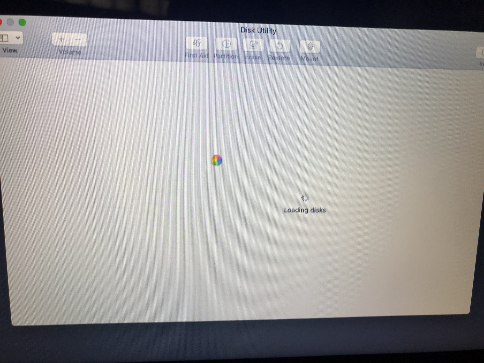

Hi, my MacBook Pro Mid 2012 crashed last night as I was working but has refused to load beyond the boot page. Before stumbling on this, I have tried using the recovery mode but experienced the same the issue as the OP(image attached).
I have tried this but I keep getting loading disks when I try accessing my drives(image attached).
What do you suggest I do?
Thanks
Mrtuscan wrote:
"Hi, my MacBook Pro Mid 2012 crashed last night as I was working but has refused to load beyond the boot page. Before stumbling on this, I have tried using the recovery mode but experienced the same the issue as the OP(image attached).
What do you suggest I do?"

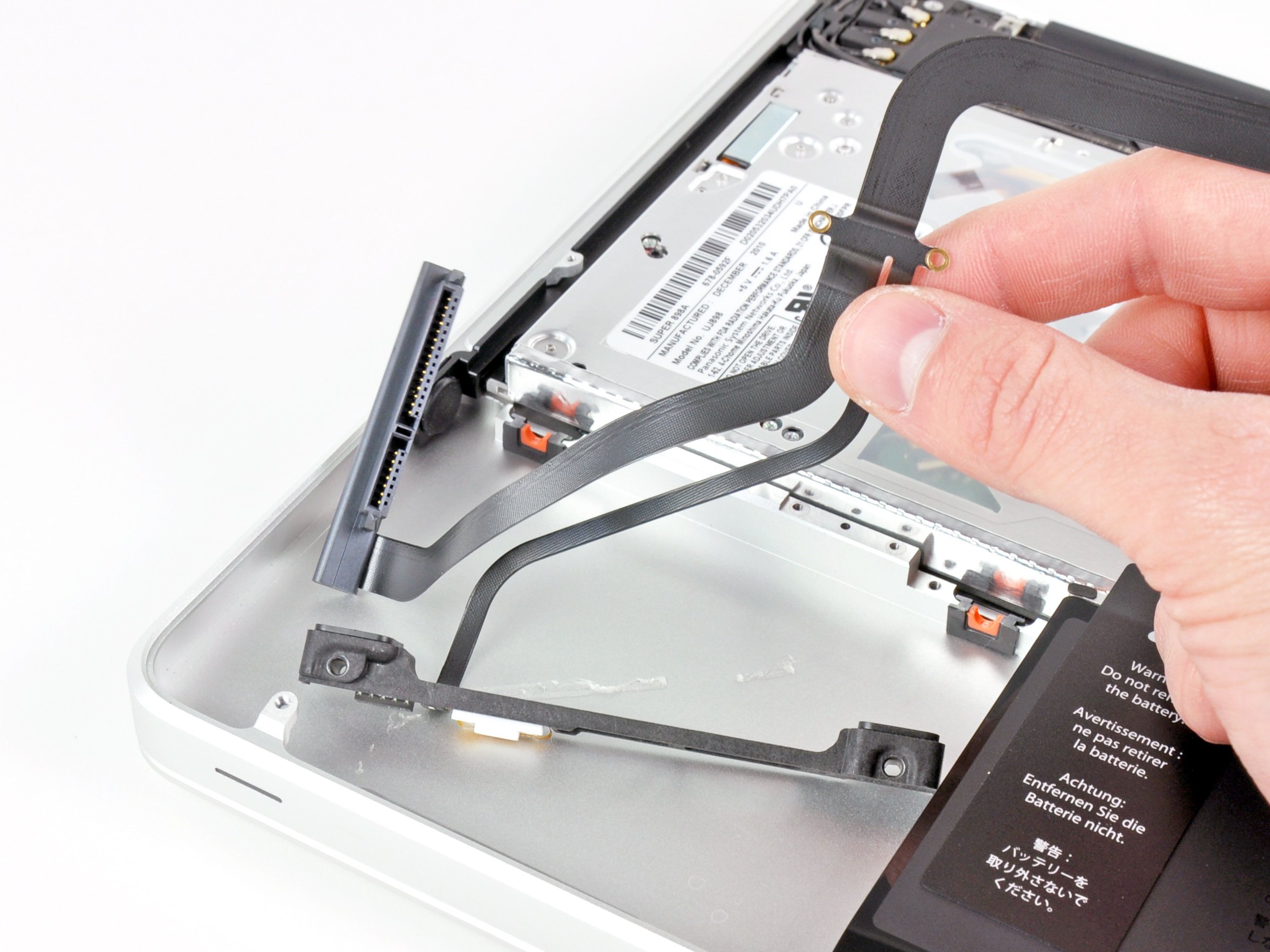

IMPORTANT QUESTIONS:
Is this a NON-retina 2012 MBP?
The one with the DVD drive on the right?
If it is...
Then it may not be the drive itself that's gone bad, but rather the "ribbon cable" that connects the drive to the motherboard. When the connection goes bad, it looks to the Mac (and the user) like "there's no drive there" (even though the drive is still ok).
This is a VERY common problem with 2012 Unibody MBPs.
The cable is cheap and easy to replace yourself.
You'll need a Phillips #00 driver to remove the screws on the back.
See this repair guide:
You can get the cable part number from ifixit.
They may sell it,
or
Find it on ebay or elsewhere.
I reckon there's a good chance that replacing the cable will bring the MBP drive "back to life"
