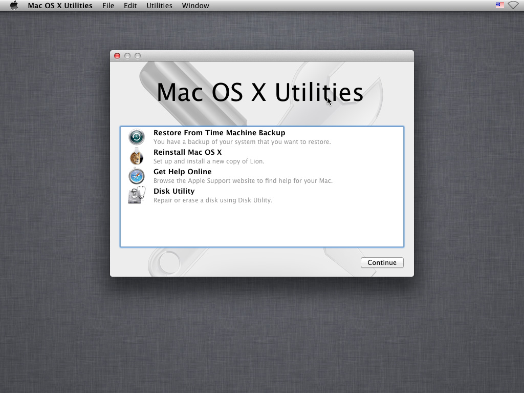

If you've put a new hard drive in, when you get to the recovery screen, go to the menu and get into Disk Utility and format the drive, then reboot again to the recovery screen and you should see the disk.

You should have the OS X menu bar at the very top of the screen, no? That's where you'll find the Utilities menu and Disk Utility.
