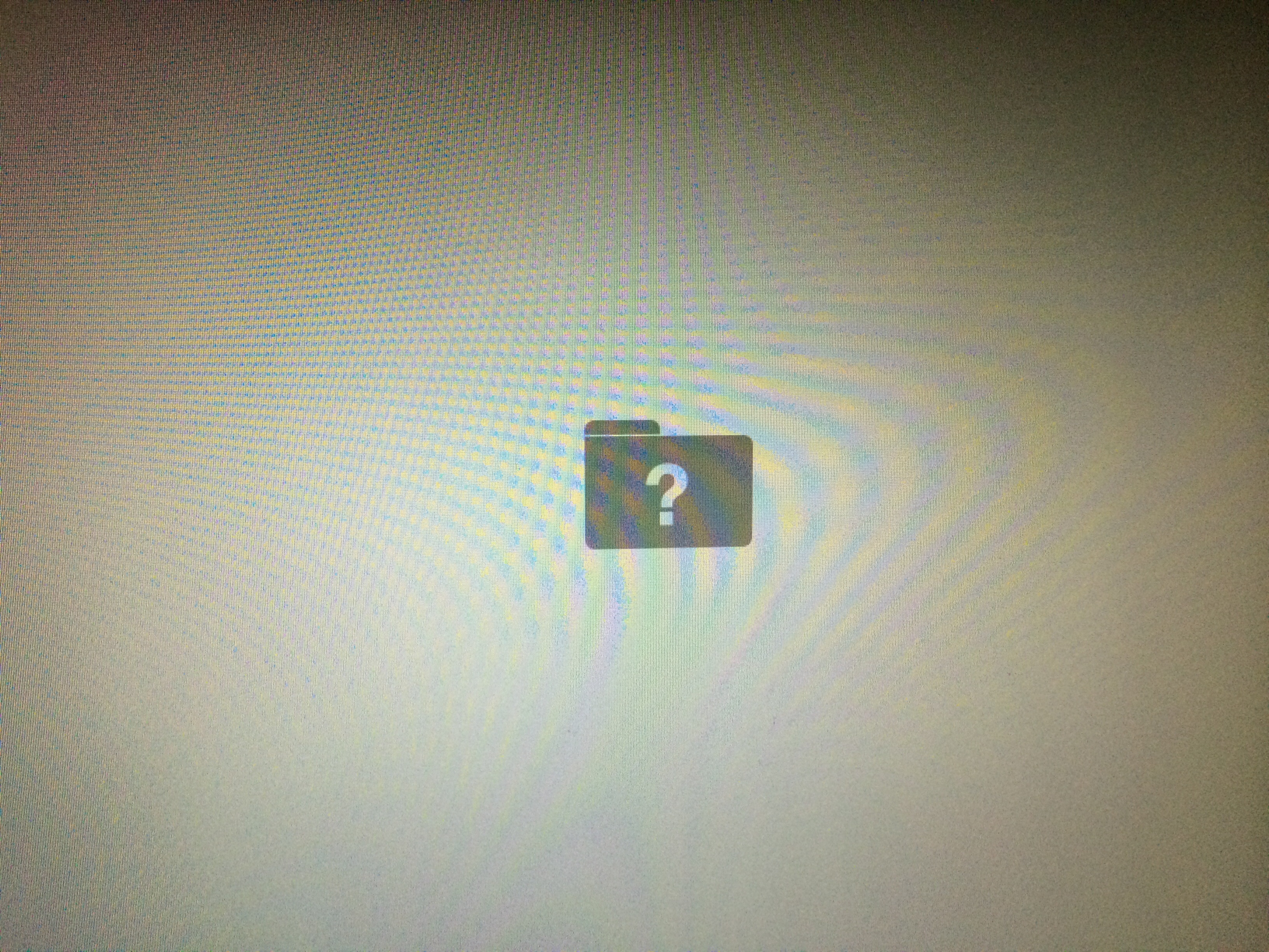

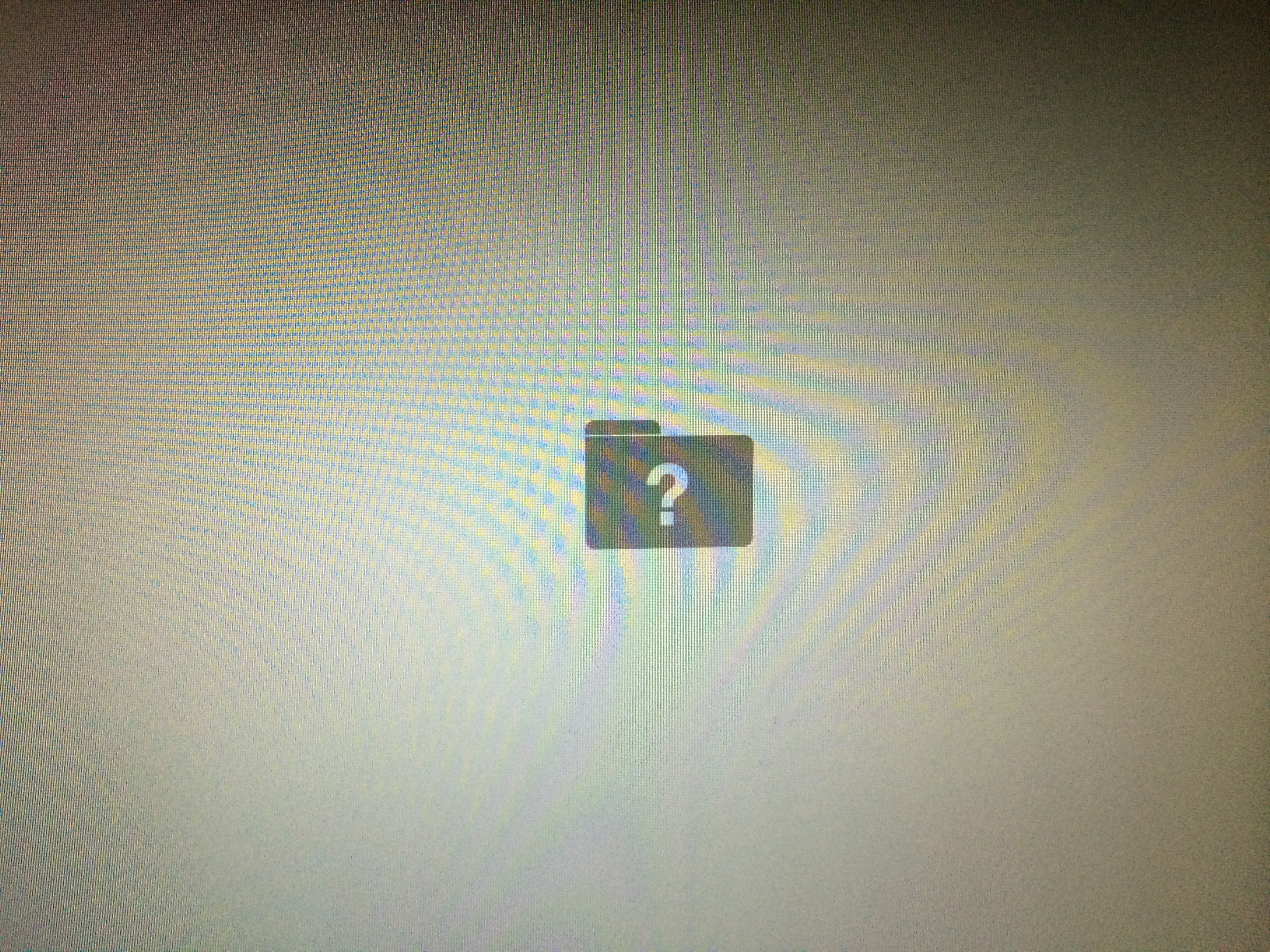

1. Fitted the new Samsung 840 Evo.
2. Booted into Internet Recovery.
3. Partitioned the drive.
4. Started the OS install, selected disk, agreed and accepted everything.
5. Downloaded the components, installed and then rebooted.
6. Shows the attachment.
Seriously, wtf?
Edit 1: I will note that this has happened twice now. The first time I decided to google the issue and seen people mentioning the Startup disk and it not being selected which makes sense. I then booted into IR again, opened Select Startup Disk and it wasn't there. Since then I have just reinstalled and the same thing has happened. Can someone help me out before I hit the single malt; HARD.
theEconomist;18999909... I then booted into IR again said:

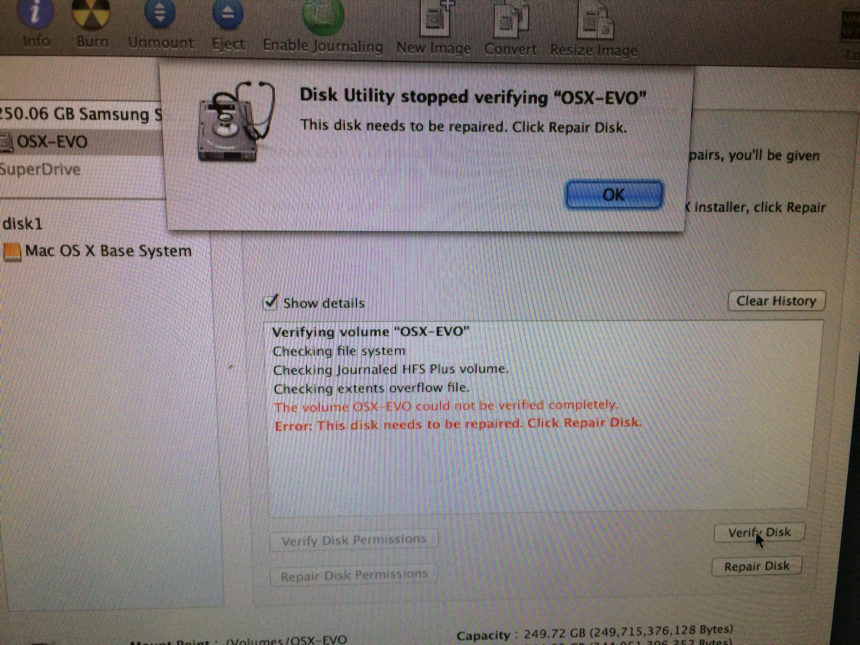

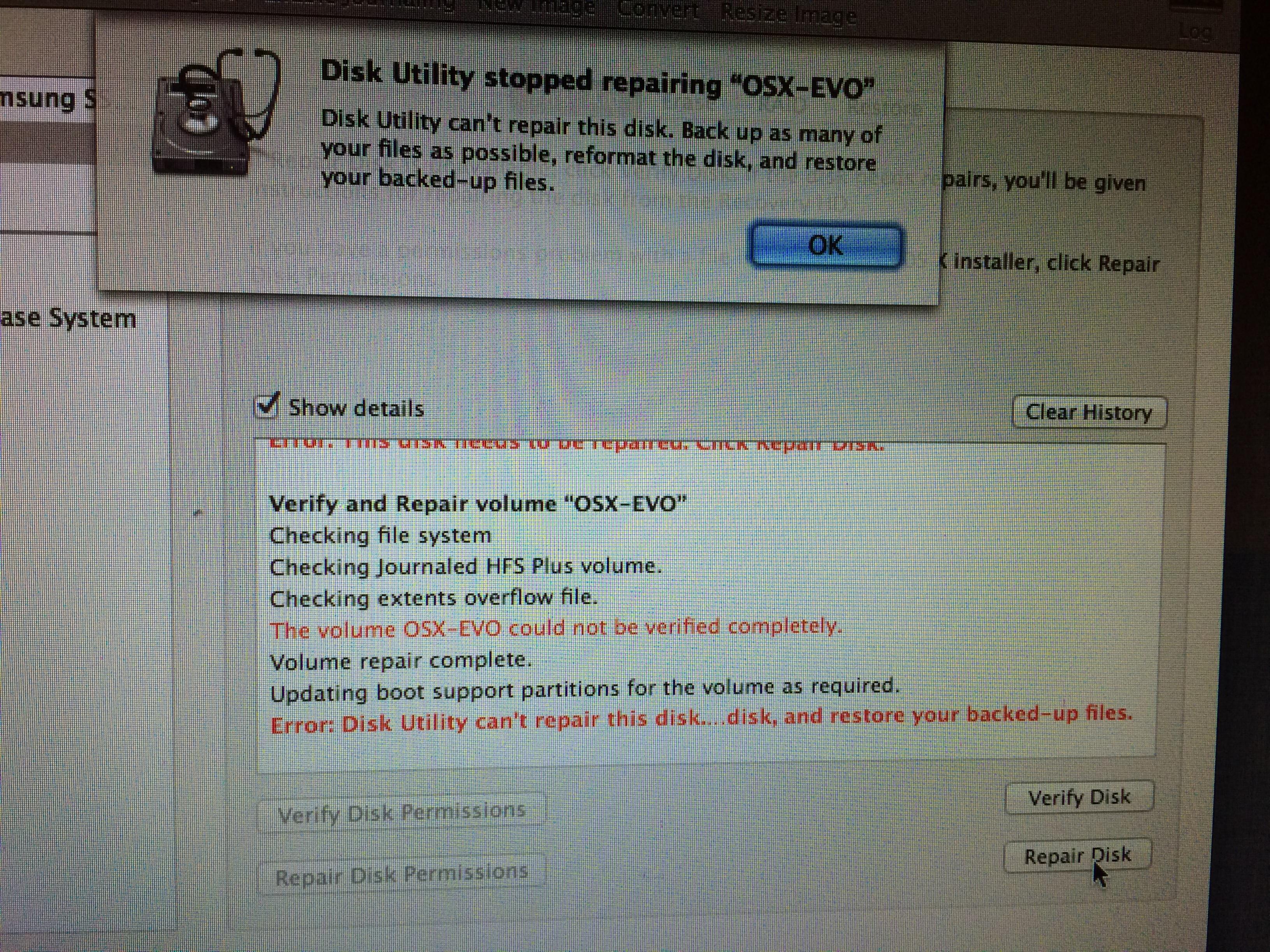

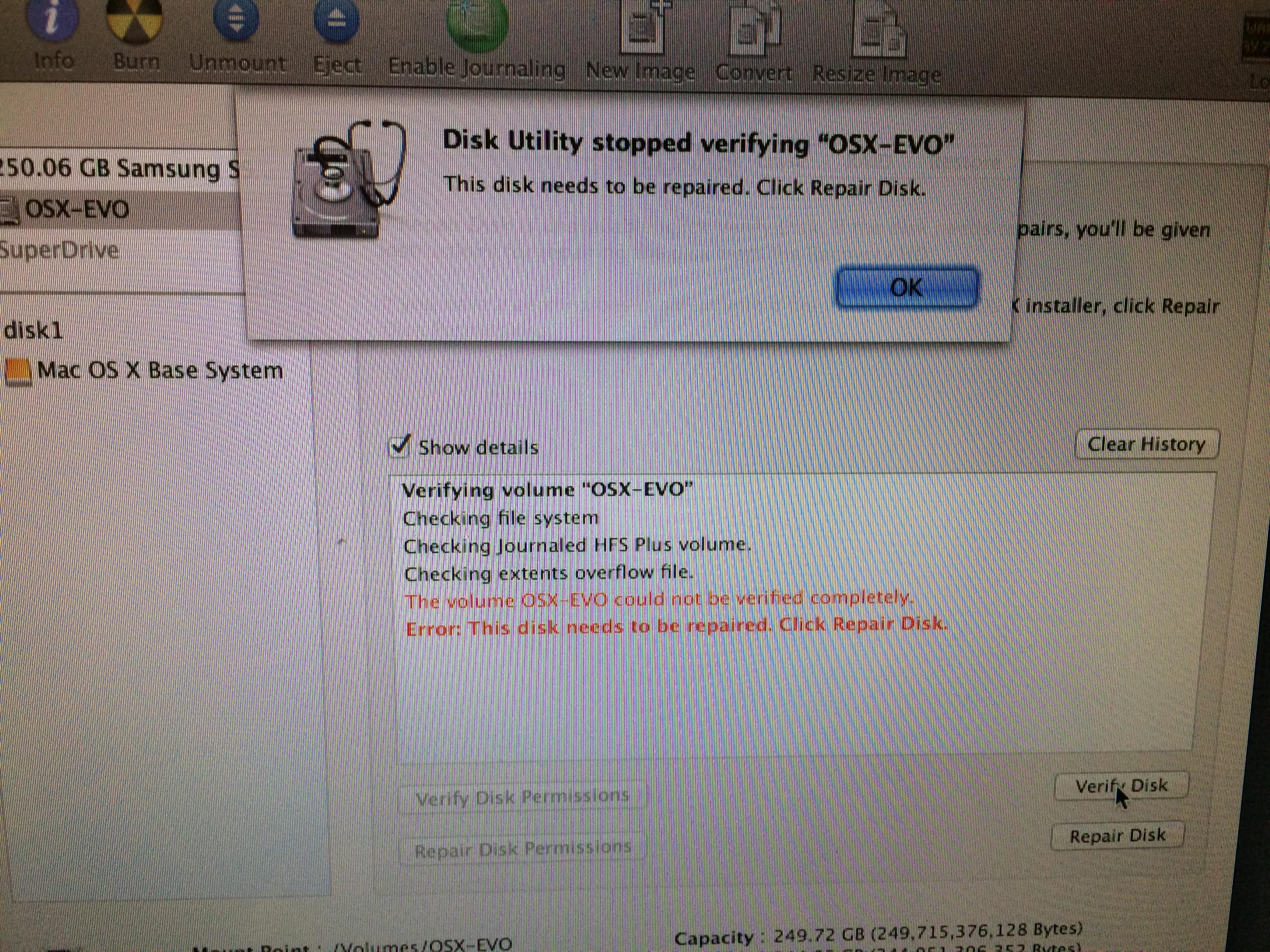

What is the result if you boot to IR, then Disk Utility?
Select the Samsung disk, choosing the line that has the disk name that you gave it. Click Repair Disk (different from Repair Disk Permissions ... )
Please see the attachments. Note that it I checked this before the second install and it, eventually, repaired and verified fine. Do you think this could be the Mac rather than SSD?
It may be the Logic Board SATA controller or potentially a degrading cable...
