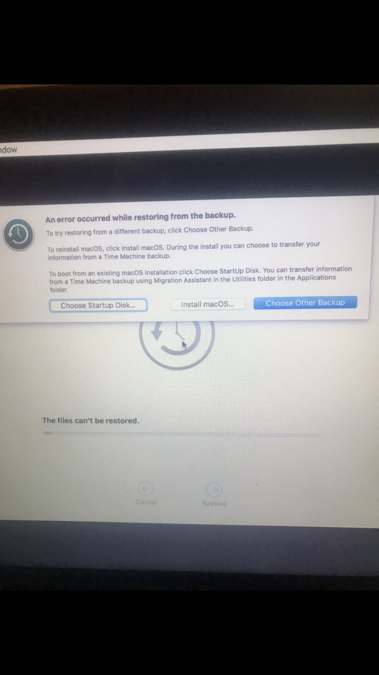

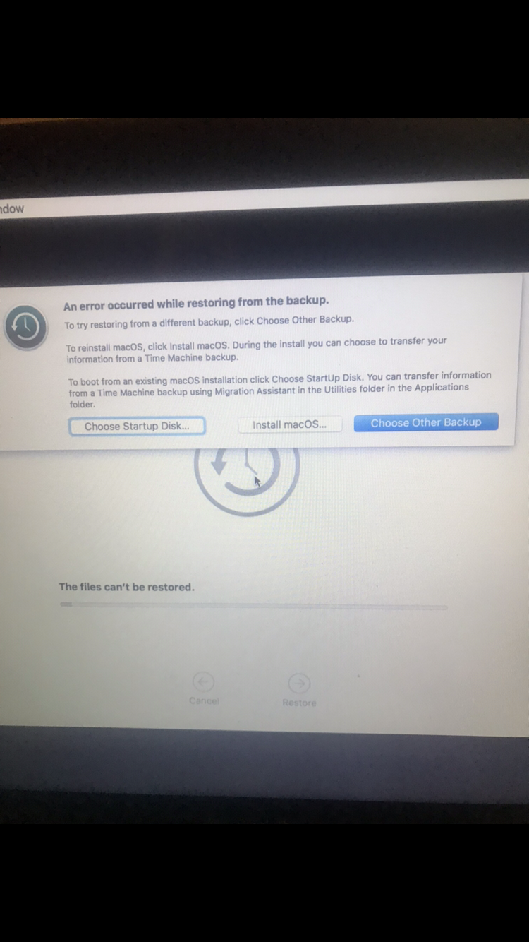

Soo now it says an error occurred..I don’t have another backup..should I reinstall online or should I reboot and try to restore using the same usb external hard drive?

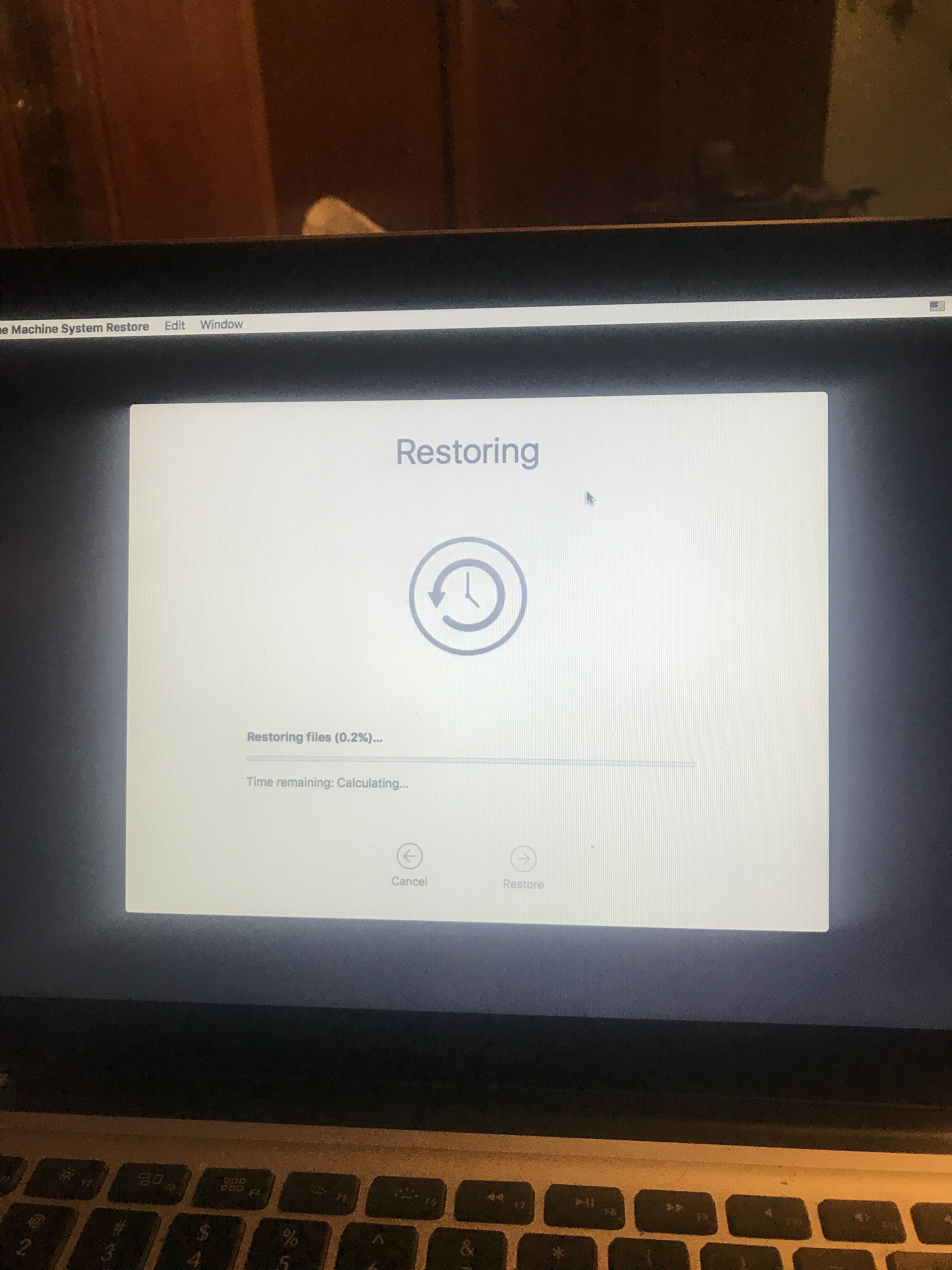

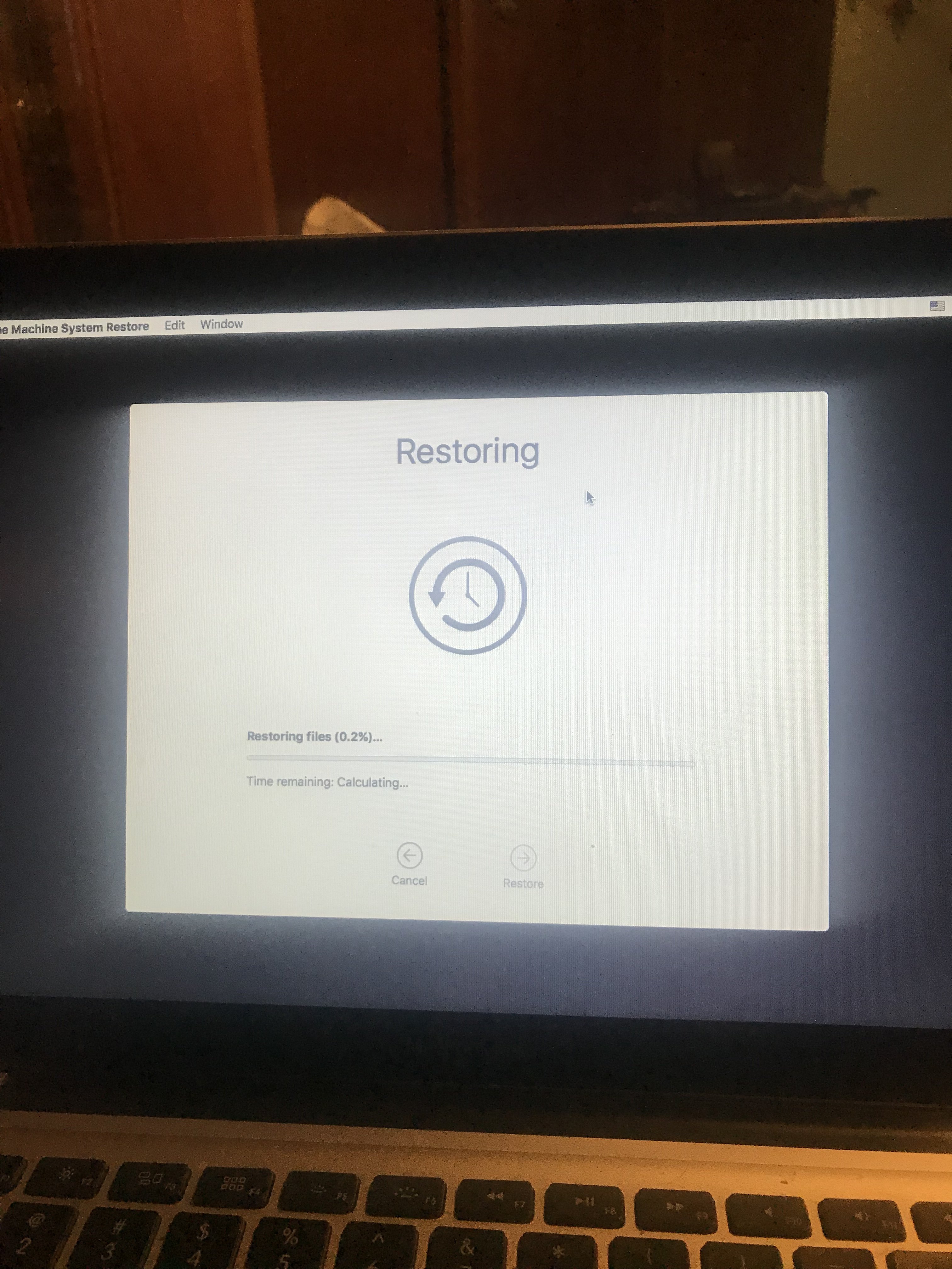

Yep... that looks good. Now just relax and have a beer while it finishes. 🙂
So now it shows this message and after I restart once and tried to use the backup drive..same thing

Did you install a new drive? If so, as @Apples555 mentioned, you likely have a bad drive cable.
Hi thank you for replys guys..no I didn’t install a new drive.. I hadd the same ssd for past year and it suddenly happened while I was watching Netflix .. should I open my mac and check the cabales??
Observation won't help you. The way to test is to put the internal drive in an external enclosure. If MacOS fires right up, it's the cable. What MBP is this?
I have had three HDD cable failures on my 2010 13" 2.4 MBP. I've put tape on the parts of the aluminum enclosure touching the cable, and everything seems fine so far. I remember when they failed the SSD would refuse to boot, but an equivalent HDD would still boot (albeit with errors). Never understood why.
