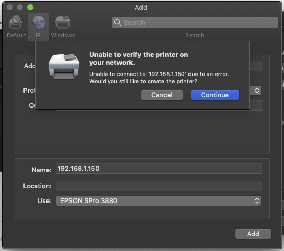

clicked 'continue here'

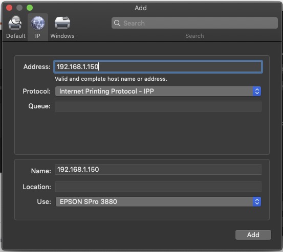

[doublepost=1555342738][/doublepost]Checked all the numbers - A-OK!
Just ticked 'Share this printer on Network' - made no difference.
Turn on Bonjour (on the printer)
Also, using the browser of your choice, see what happens if you type "192.168.1.150" in the browser's address bar.
You might be taken to some screens that make the printer setup easier.
Scanning through these posts....the fact that the printer did not get a DHCP IP could be a sign of a network issue. There are several other clues, including "unable the verify printer on network".
If there is a network issue (bad cable, bad NIC, etc.) no amount of manual configuration will fix that. You will just be chasing your tail.
I would suggest consider focusing on why the printer is not visible nor getting an IP. If you have a spare network anything (computer, printer, etc.) you could:
1. unplug the 3880 Ethernet cable
2. plug in your test device to the cable that came out of the 3880
If your test device works correctly: gets an IP and behaves correctly...then the issue would likely be the printer itself.
If your test device does not work correctly...then that would point to the cable, the port on the switch, the switch...or something else, including the router itself being the problem.

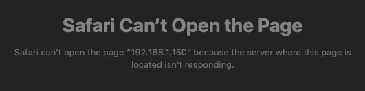

Tried 192.168.1.150 into my browser🙁
