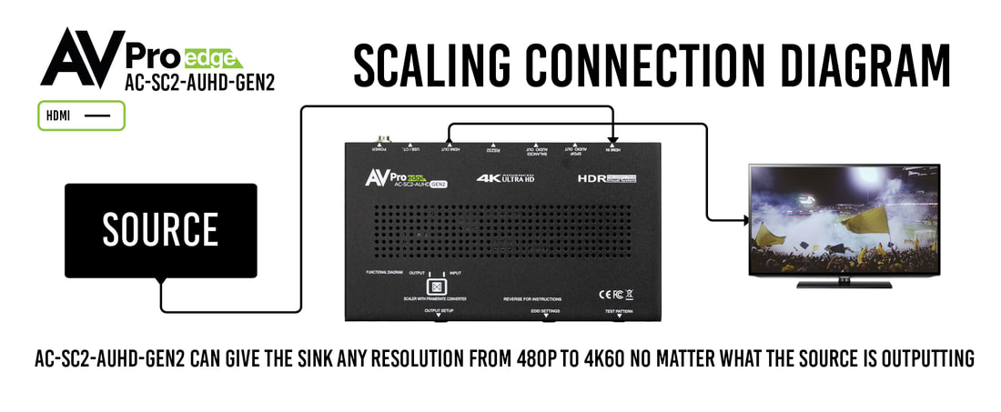

I looked into the article. Where would I put that device? Between ATV and my receiver?
Click on the photo to see how to connect. BTW: this device is NOT needed, IMHO.
