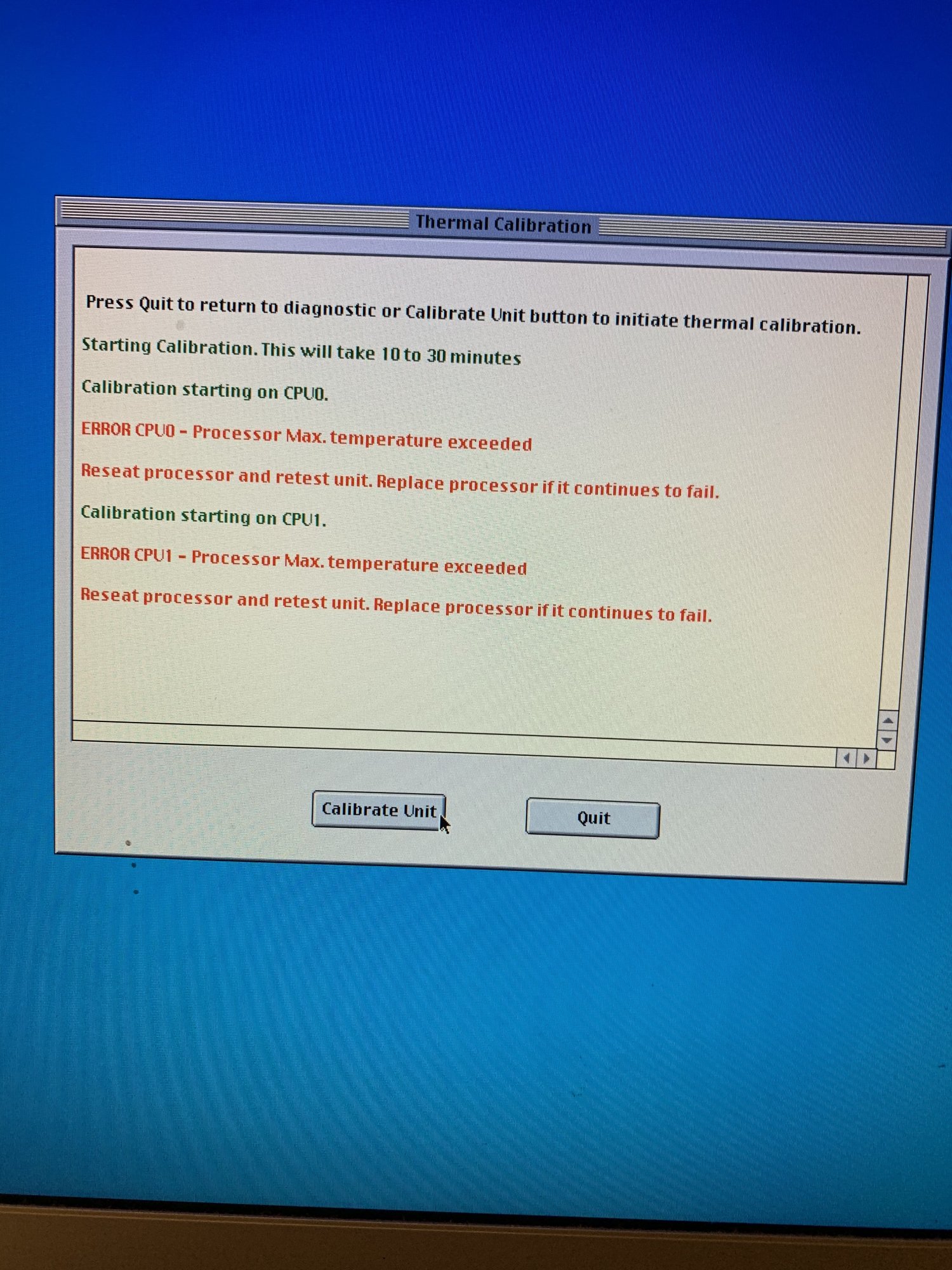

Hi, I own a PowerMac G5 Quad. It is very very noisy! I tried to execute the ASD calibration but nothing has changed. I tried to unplug all the fans to understand the cause of the noise. So the noise came from the power supply or the LCS system. Remove the power supply from the case is very difficult, so for now, I'm investigating the LCS system. I have the Dolphy LCS with two pumps. It is possible that the LCS system has some problem and the noise came from it? Can you suggest me some methods to understand if there are few liquids inside the system? I read some threads about the Air conversion from the 2.0 dual heatsink, what you think about it? Heatsinks are really enough for the G5 Quad?

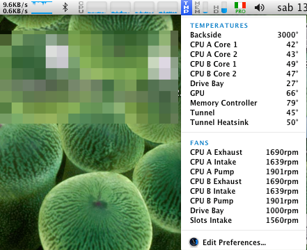

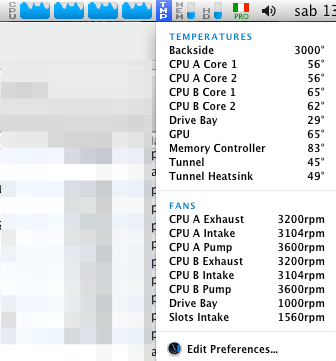

From my point of view, i don't think the LCS has failed. It doesn't perform as new, but it is far better thank a leaky one (this conclusion was only from the temperatures).
First of all, check if the backside sensor is interfering with ASD calibration because it has obviously failed and reports 3000 degrees celsius.

I find your CPU temps actually quite low, no worries at the moment.

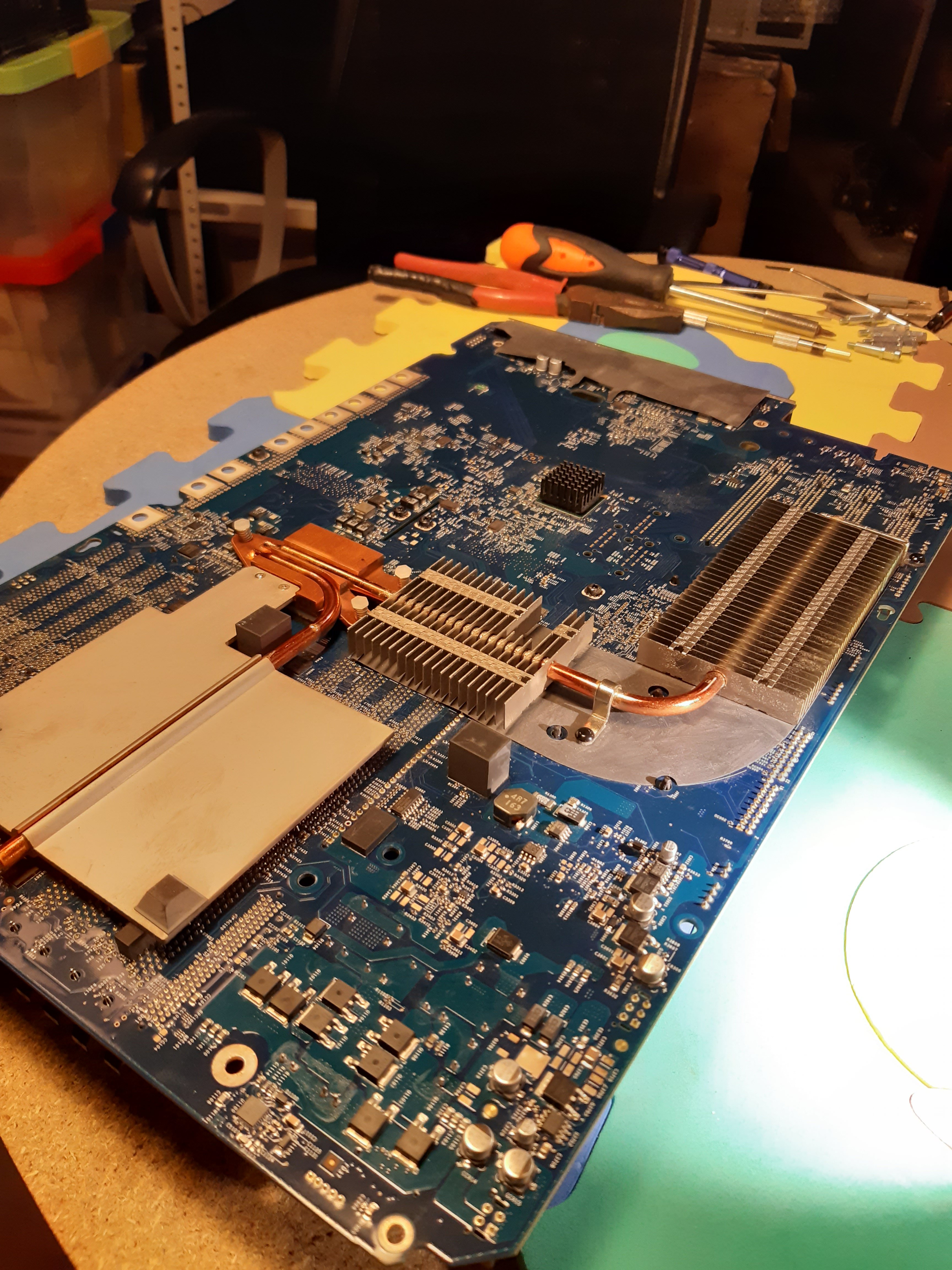

I would say that memory controller is at a high temp. I had that too and did a an overhaul and repaste. I completely disassembled my quad to get to the backside of the logic board but was absolutely worth it.
i was going to say the same thing. Mine runs 60-70C. And it definitely needs a rebuild.

Even if the ASD test is ok in macos the backside sensor fails.
Do you think I can solve this problem or disable this sensor (in macOS or in Linux)?
I don't think that this is possible, but maybe someone knows more about that!

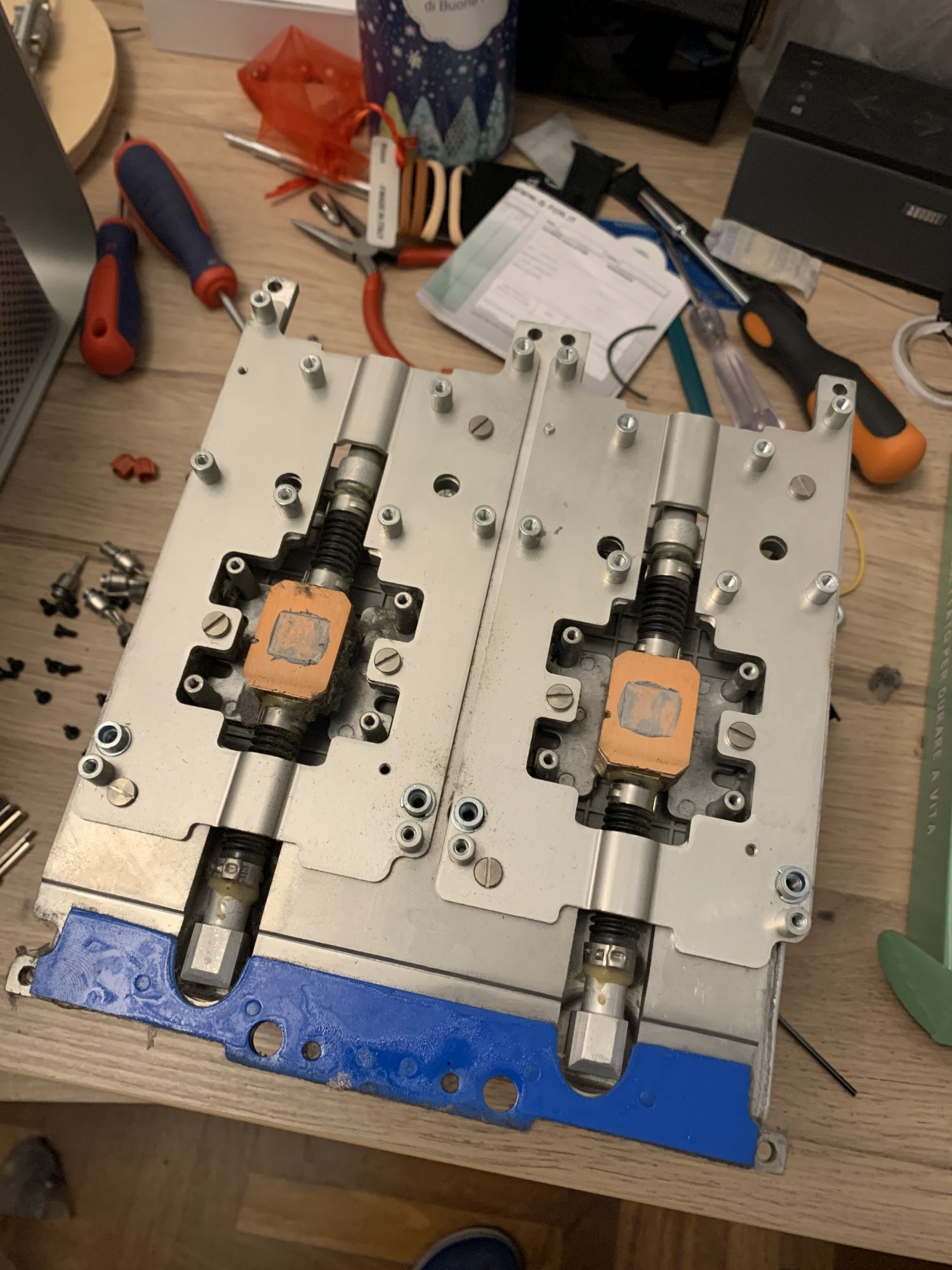

There's no visible leakage so far and I suspect the thermal paste is bad.
I have seen a few tutorials on how to service the LCS but never about just renew thermal paste. Is there any where I can find such tutorial?
This is a conversion video, but it will help and show you also a location where the cooling circular can leak (you only need the first 6 mins. on min 9.00 is cleaning and thermal past).

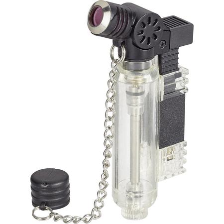

To remove the CPU cover you must remove a little plastic pin. A good solution is a lighter like this:
Look the video first before start working (between 6:00 and 9:00 is a convertion path where parts must be destroyed, dont do this)

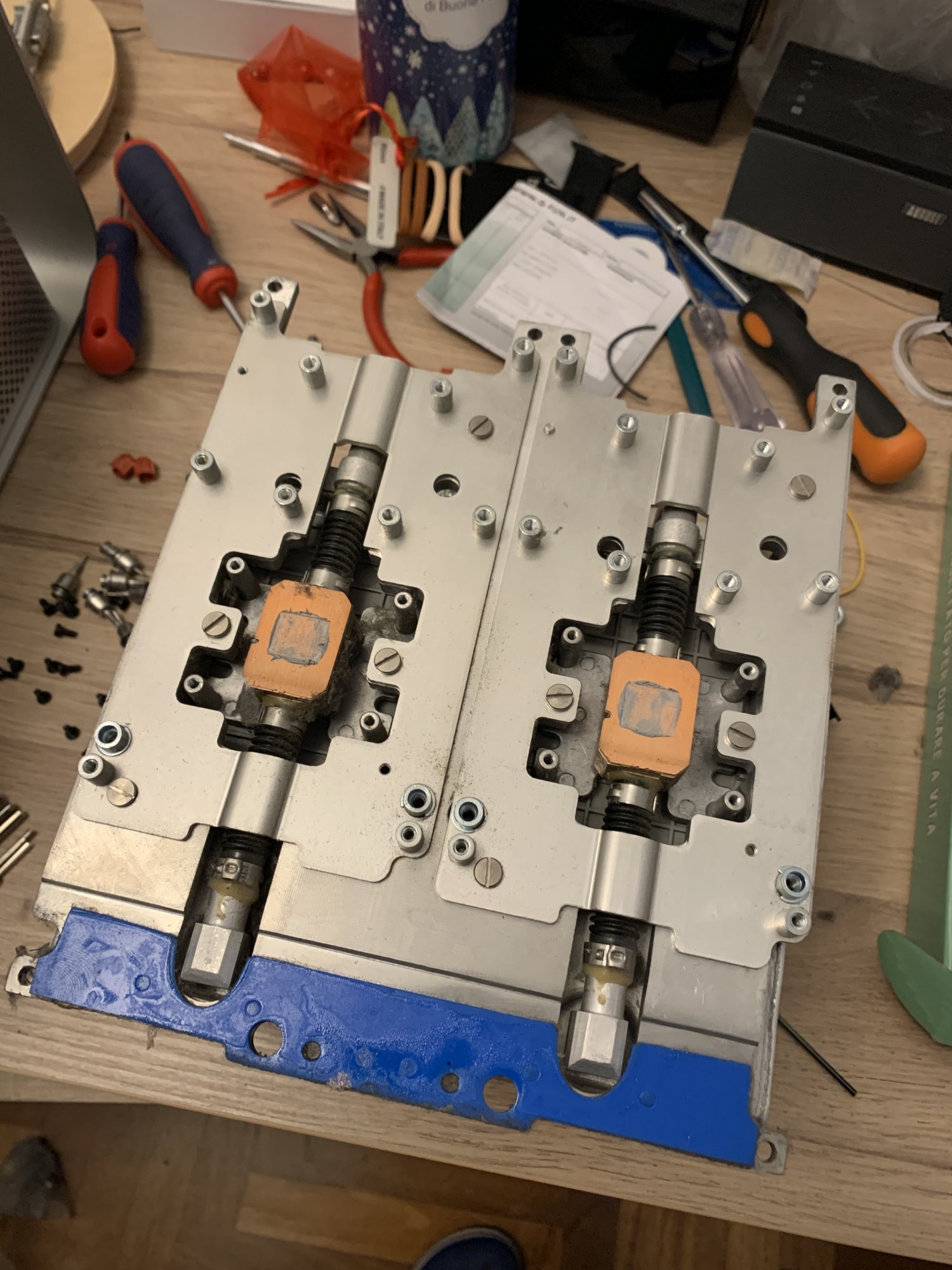

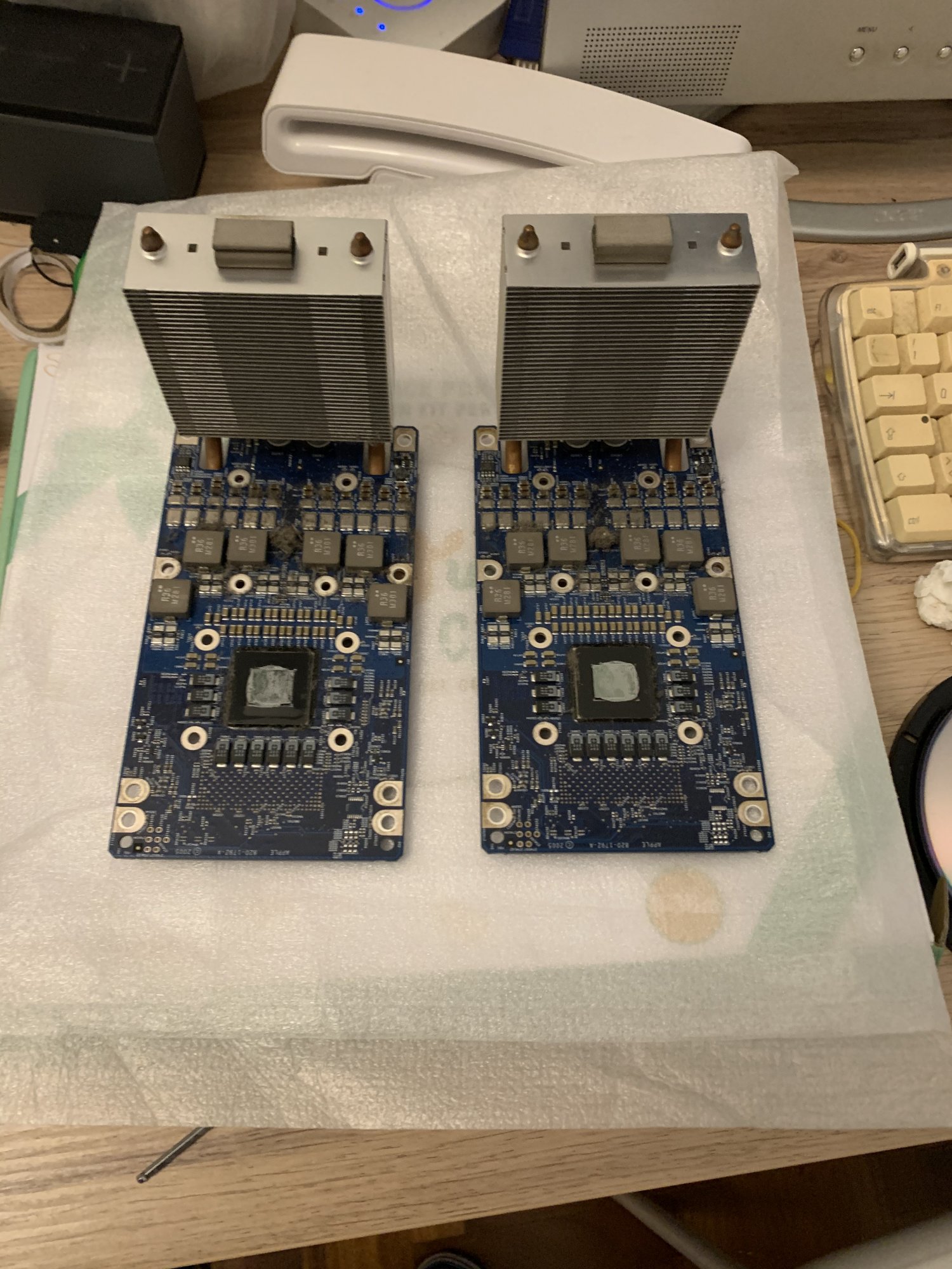

Good news no leaks!
Ok, I repasted CPUs.
And I reassembled all components.
Now PowerMac don't want to boot. If I press Option the boot menu is shown but in few seconds it stucks.
Any ideas? Tomorrow I will try to disassemble it again.
thanks
Don't overtighten the processors screws, check for bent pins, check if it seated evenly and correctly!
Cheers, Nikola!
Good news no leaks!

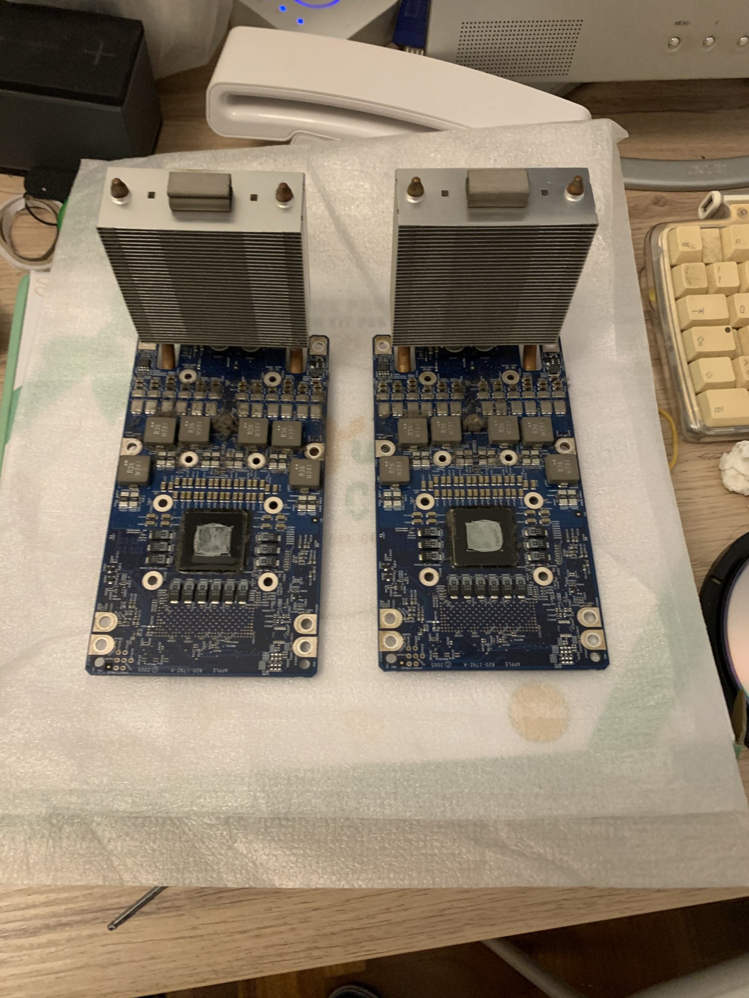

View attachment 916394View attachment 916395
thanks
CPU A must be CPU A, and B must be B. Sure that you put both CPUs to his old place? Did you add the thermal paste correctly? What paste did you get? I hope the paste does not conduct electricity.
