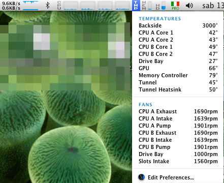

MacOS starts for a few seconds, and CPUs are correctly detected.
CPU A temperature is 40°
CPU B temperature is 90° in idle... so I think that pump B is not working.
I will try to buy another LCS for QUAD and I will retry...

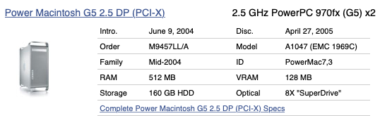

  • Can I use an older LCS model with one pump? A friend owns this model:View attachment 915966 and he can give me the LCS. Do you this it is ok for G5 Quad?

NO ! Totally different. The PCI-X models had a different water cooling system. Quad uses dual pump - less reliable, though you'd think 2 would be more, but its not - single is most reliable according to xlr8yourmac.com - don't know if they are still around, maybe webarchive.

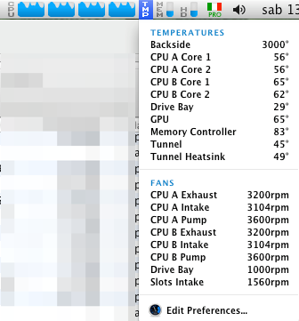

Idle:
This is the noise in idle -> Idle Noise
Full load
This is the noise in full load -> Full load noise

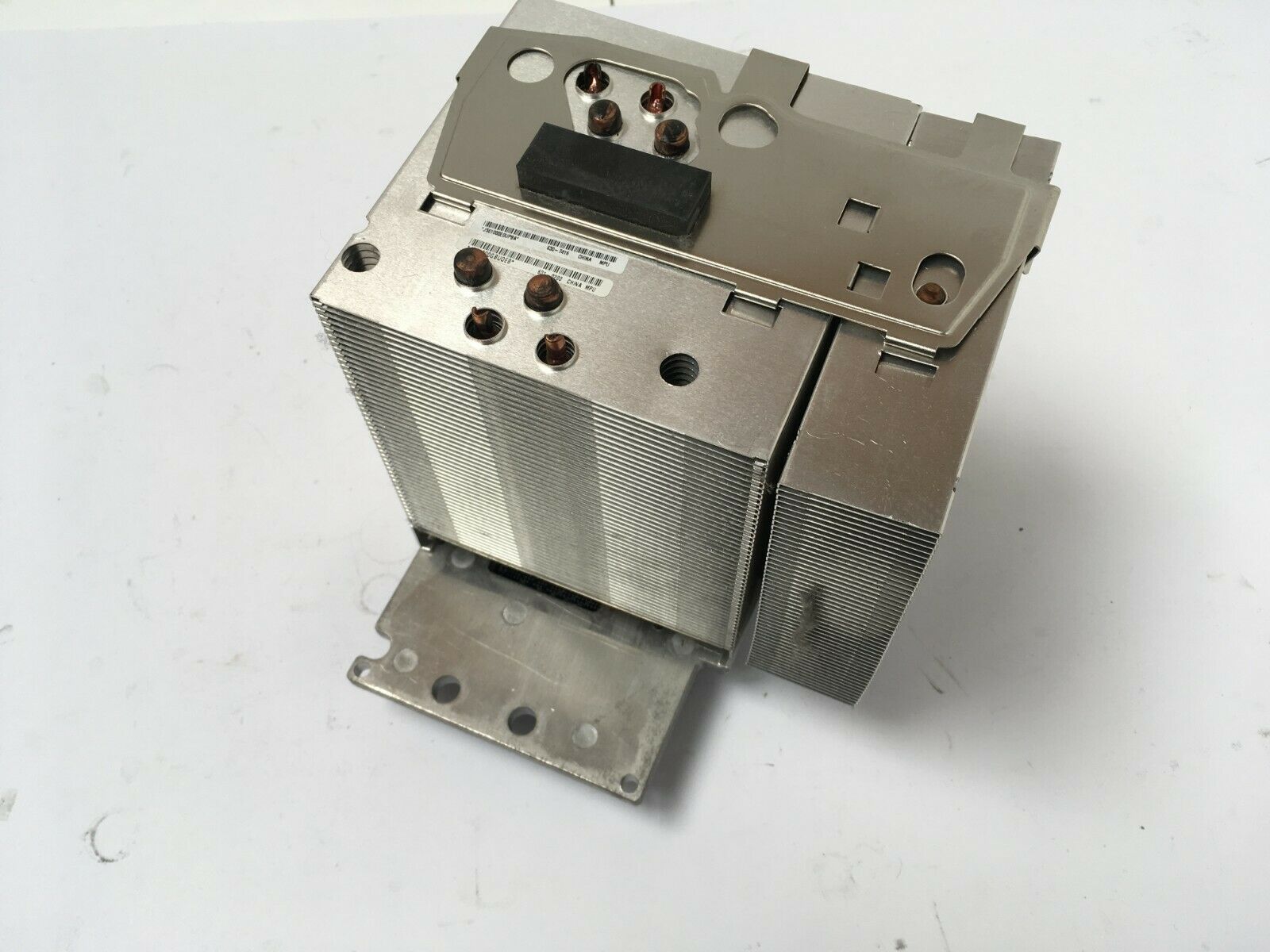

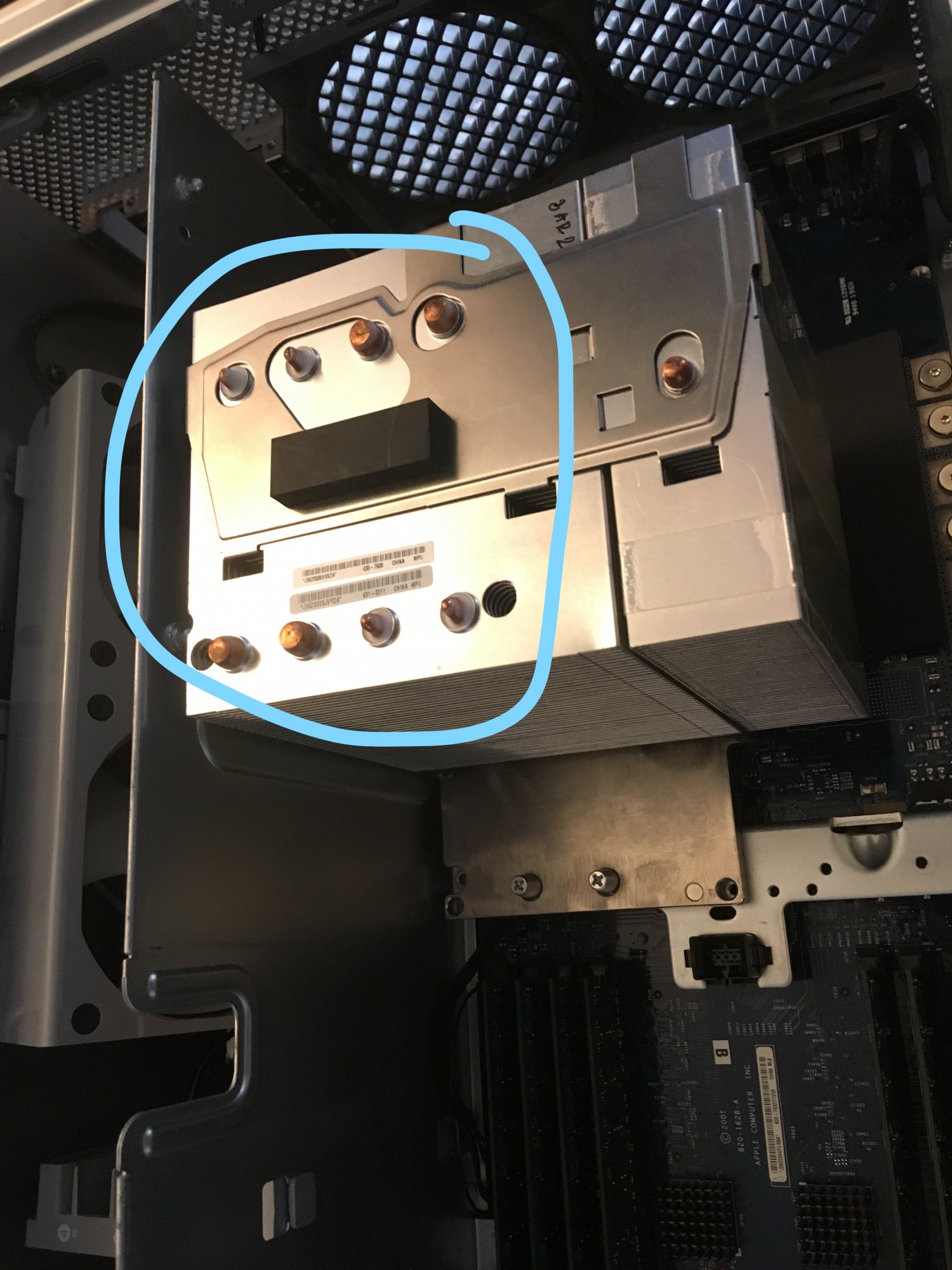

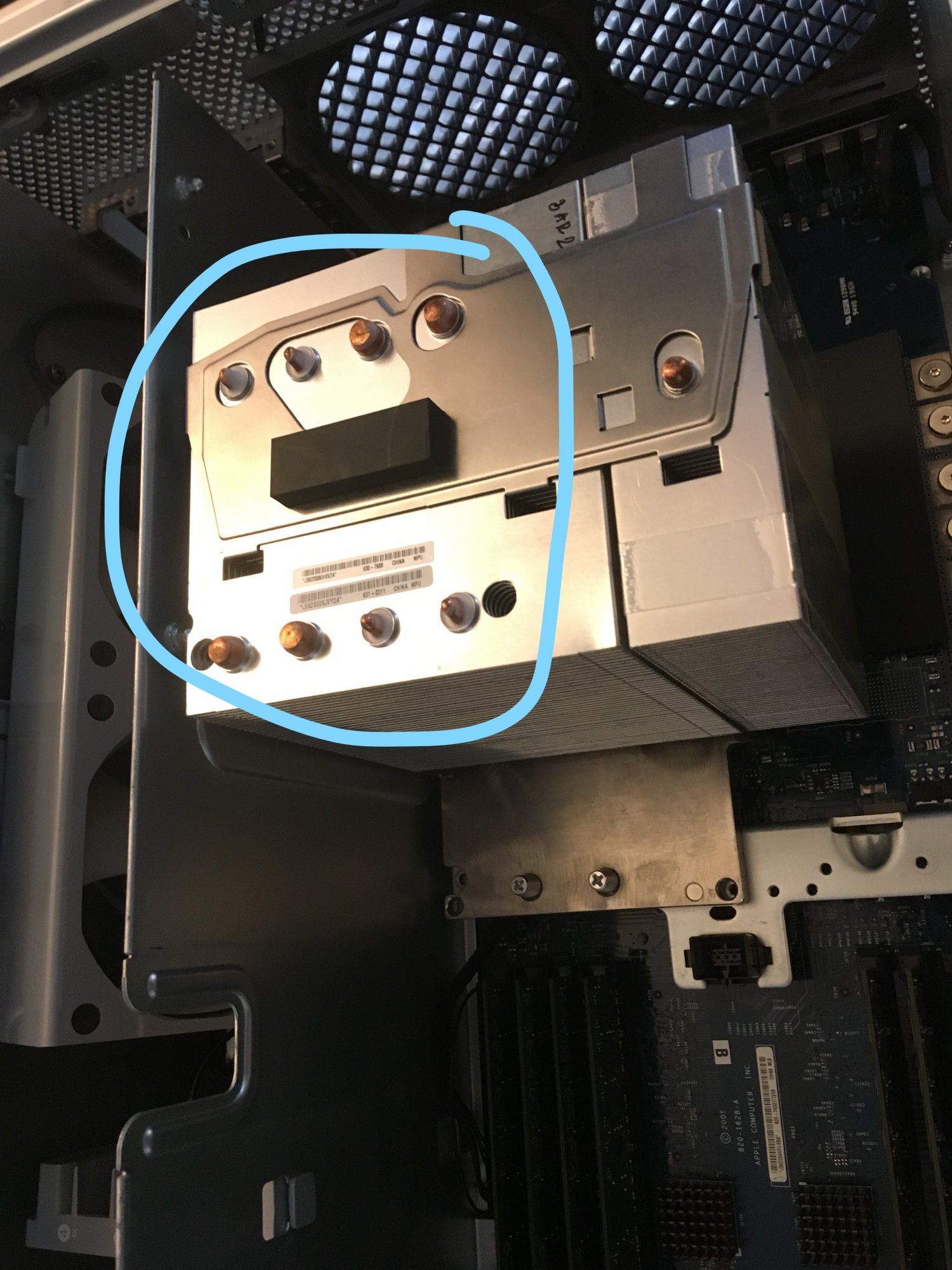

Temp will reach 70c celsius and above with the 2.0hs (fan rev high/max under stress). Its a crap heatsink, I dont recommend it.
Temp will reach 60c celsius and maybe a bit higher (63c) under load with the 2.3ghz heatsink. Fan dont rev high, the G5 is happy. Its a very well made heatsink compared to the cheap 2.0 one. Also in the meantime, if you get a 2.3ghz heatsink with the secondary hs included ( like this picture with the side hs), you can use your quad with one 2.5ghz cpu in place. Hope this help.
Adding to the discussion, so you advise not to do this at all ?
This is not what I said. I made a quad air cooled for myself. I'm just advising NOT to use the 2.0hs. When I discuss the temp under load, its under 100% load using powerfractal. The OP SHOULD USE the 2.3 heatsink.

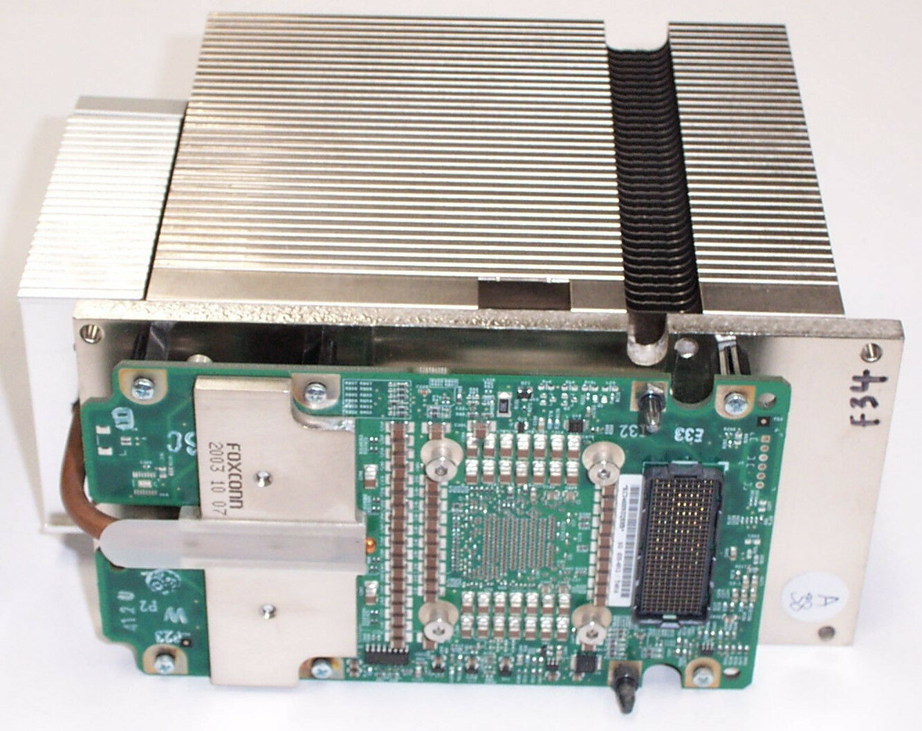

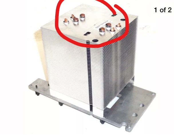

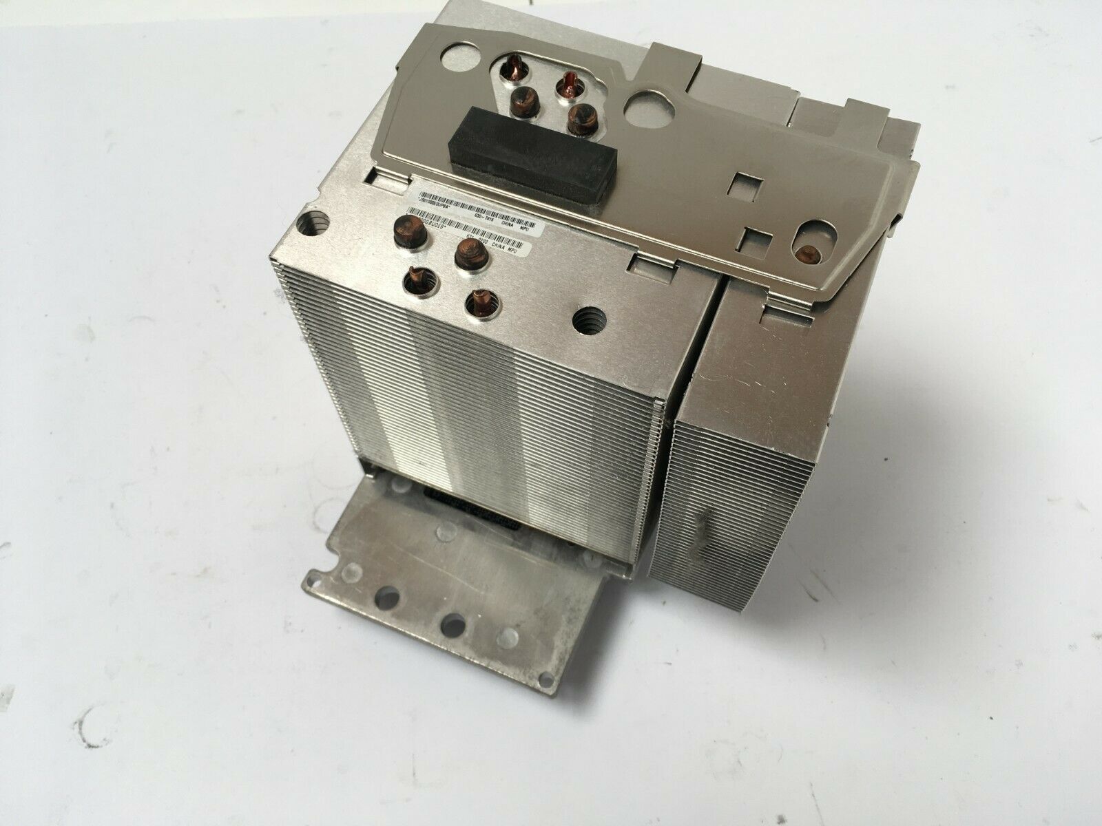

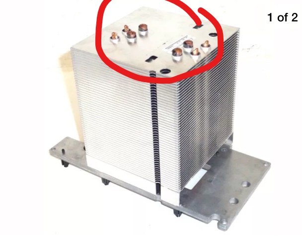

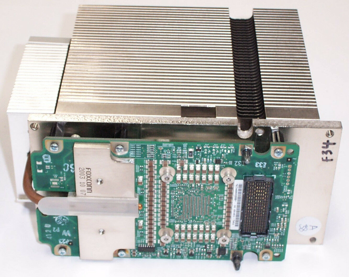

Online I found two different Heatsink used with the 2.0ghz:
The first has the memory heatsink behind:
The second has a lateral memory heatsink 630-7416:
The second is very similar to the one used into 2.3dual.
Do you think it is good enough?
The first hs you posted is not compatible. It got a nickel baseplate and is not enough to cool a dual 2.5 chipset. One member posted some research he did on a quad on air, a while ago, using these a and from memory he said the temp were high and he was unable to screw the hs in place. These one are use in the 2003 and 2004 and use totaly different mounting screw compared to the 2005. The second hs you posted is from a 2.0ghz late 2005 and yes, while it can be installed alone, or if you machine both of these to put them side by side, it is not enough to cool a single dual core 2.5ghz chip, or two dc 2.5ghz chip. Do some research, read my thread about a quad air cooled. Ive tested these (2.0hs)... What you want is the one I recommended. Since I doubt you could find a shop able to do ‘edm wire cutter’ you should focus on fixing your clogged lcs. I decided to mod my own quad because, like you, my lcs was clogged but I’m a cnc machinist/cnc programmer and I have access to a machine shop, including a edm wire cutter. And I had a lot of time to thinker with my quad. All the info needed is in the thread I made. Anyway, its my last reply, I’m starting to repeat myself. Have a good day.
In your opinion, it is possible to cut with an angle grinder using diamond discs?
Thanks
Thanks
With hand tool, what I can figure would be to mount the heatsink into a vise ( mounted not to crush the hs, the other way) then place wooden shim to prevent the fin from moving too much. Then cut with a fine metal saw and finish with sand paper if needed. You could try with a angle grinder but a hs is fragile. Maybe a small air powered one or a small blade from a dremel would be better. Its a lot of work imo compared to servicing your lcs. But if your up too it and accept the challenge why not! Some people make xbox 360 laptot with only hand tools!
