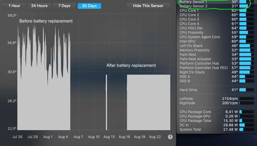

Just a question for those who already replaced the battery of your rmbp.
Recently replaced mine with one from OWC (newertech).
I took a look at the istats menus and the battery sensor 1 and 2 are showing constant values since then.
this values are from SMC with respective TB1T and TB2T codes.
I suppose that's because this is a non-oem battery and don't have those sensors but still showing something constant ?
Anyone with the same ?
If you do diagnostics by pressing D at boot what is the result?
it always passes the apple diags because it never reaches the threshold, the outputs are steady values ~30ºcelsius
here's a reddit user u/brakepump, i hope he doesn't mind i use his screenshot with the exact issue:
source :
Don't worry too much if it passes apple diagnostics test. Also monitor charge/discharge rates. There shouldn't be any sharp jumps. Here are the results from my battery info. You can compare with yours and see if there are any big differences:
