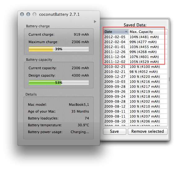

So after about 3 months, the new battery failed (Health ~50 %). This is exactly what happened:
  1. The battery charge was around 30 % and I put the MacBook to sleep
  2. When I woke it up after about 15 min, it showed the normal password prompt
  3. The screen went blank before I entered the password
  4. I brought it back to life by pressing the power button and plugging in the charger
  5. It started from safe sleep and the battery charge was 0 %
  6. I got the same "service battery" message and my battery health was 53 %
  7. I restarted, but that didn't change anything
  8. I reset the PRAM and that didnt change anything
  9. I reset the SMC and that didn't change anything
  10. So I just let it charge and after it was about 40 % charged, I unplugged the charger
  11. After letting it idle for a while, the battery health was reported 95 % and charging was 71 % (even though I had unplugged the charger at 40 %). The "service battery" message was gone
There was no problem with the new battery so far and it's health was > 99 % all the time. I had purchased the battery on 26th November and I have taken good care of it (plenty of charge-discharge cycles and monthly calibration). I was given a 90 days warranty by the AASP (which expired on Feb 26th).
So what am I supposed to do now? :( Do I need to replace this battery too and waste more $$$? The battery health is now reported at 95 % and it appears to be normal. I will calibrate it today. Also, there is no swelling on this one.

It is odd, I've had my MacBook Pro for 4 years with no battery swelling or issues, apart from the expected life depreciation. I wonder if the problem is in the battery management on the Mac itself?
You posted earlier that you always charge up to 85%, then disconnect the charger and discharge to 65%. That sounds like you go from 65% to 85% to 65% once an hour. If you are really doing that, then I can assure you that you are destroying your battery. Charge / discharge cycles are _not_ good for your battery.
No. I first thought that was a good idea. But other people in this forum said that it was not. So I just used it normally. I used the battery every day and unplugged the charger when the battery was fully charged for a long time. I think on an average, I made a charge cycle every 2-3 days. I also calibrated the battery every month to be sure that the capacity is correctly reported.
I haven't yet calibrated the battery since yesterday, and the health is still reported as 95% with so "service battery" warning or swelling. I think it may be a software bug. I will post again after I calibrate the battery.
You shouldn't calibrate your battery that often. Once every month or two is enough.
