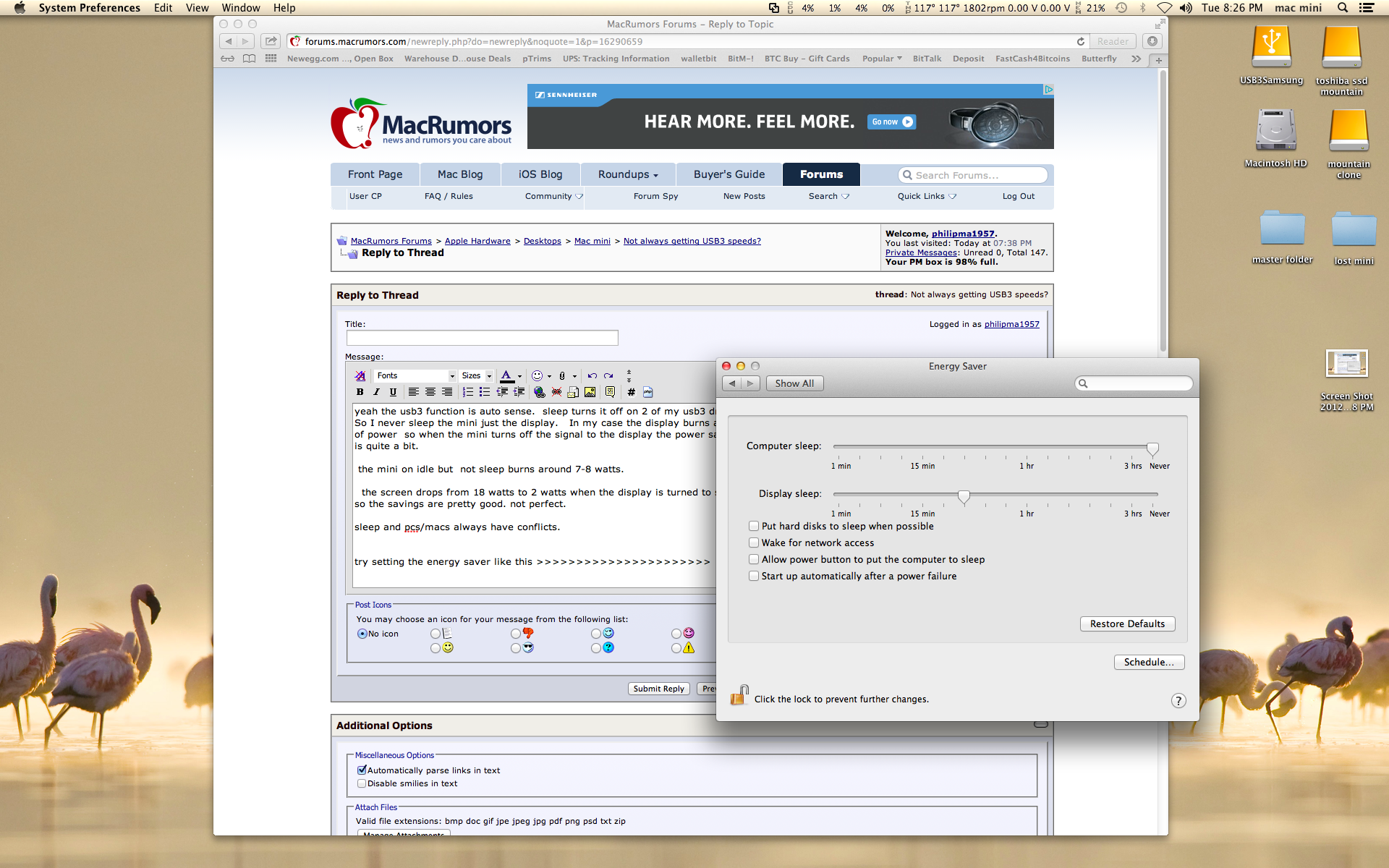

try setting the energy saver like this >>>>>>>>>>>>>>>>>>>>>>

That's what I always have, I just used to sleep it myself when going to sleep etc. kind of annoying. Hopefully an update will cure this?

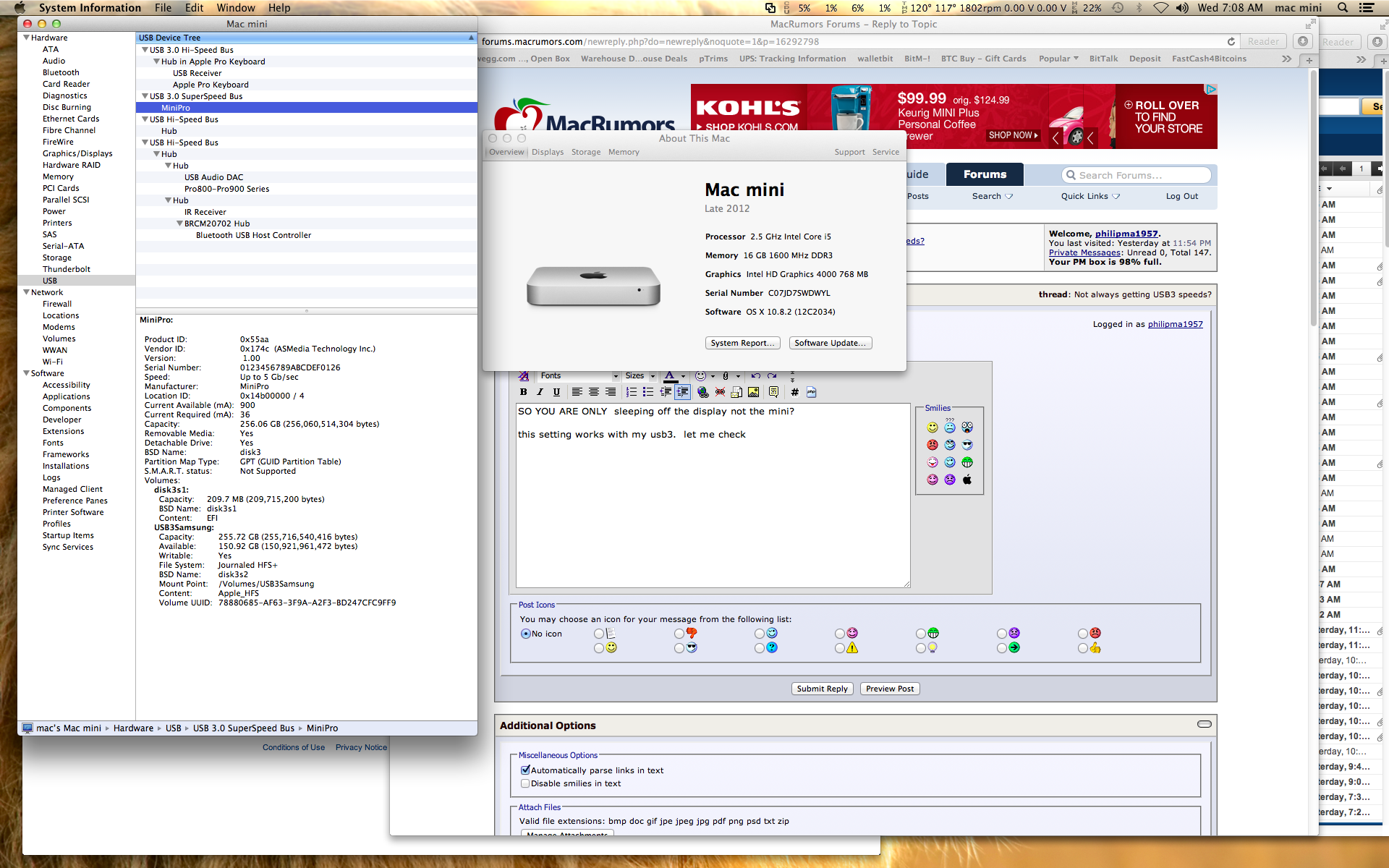

SO YOU ARE ONLY sleeping off the display not the mini?
this setting works with my usb3.
let me check.
yeah I don't lose the usb3 when just the screen sleeps.

No, I meant when putting the whole thing to sleep. At the moment I have no devices listed under the USB3 part, but Touro 3.0 under USB Hi-Speed Bus.
If I un/replug it it's listed under USB 3 SuperSpeed Bus and I get USB3 speeds.
