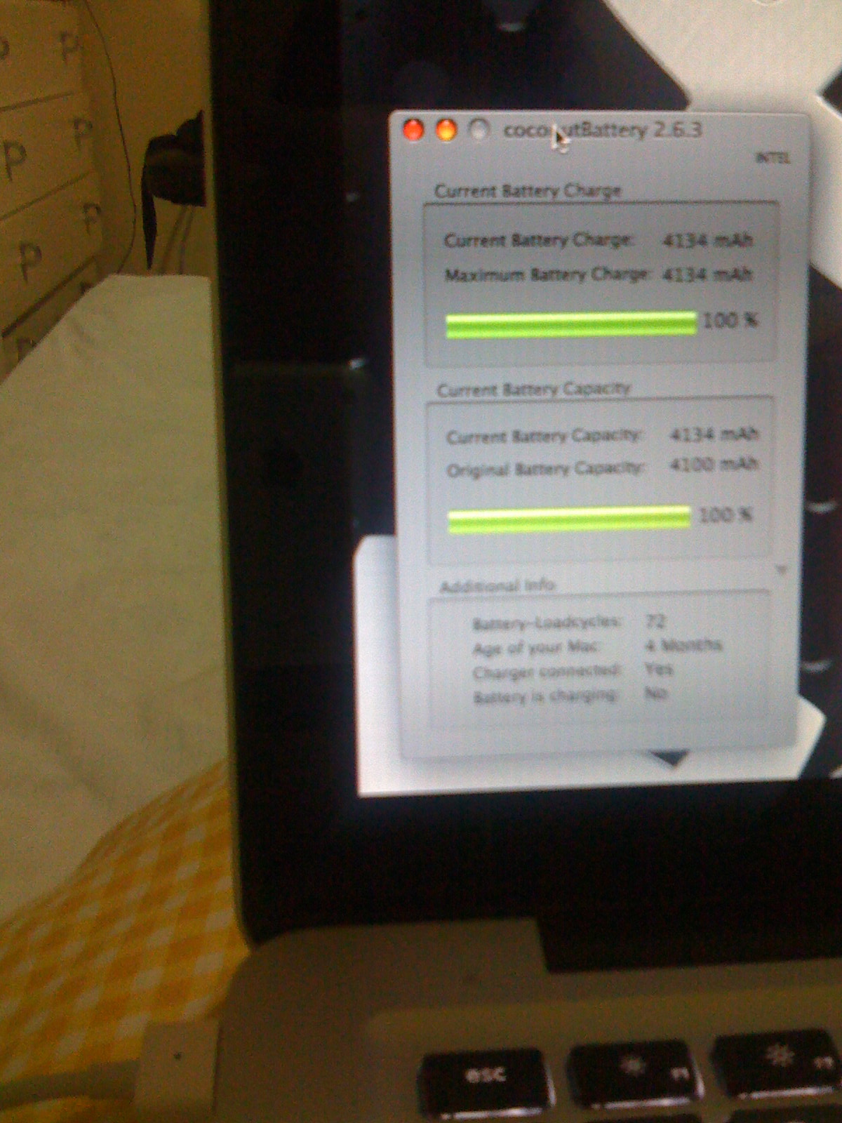

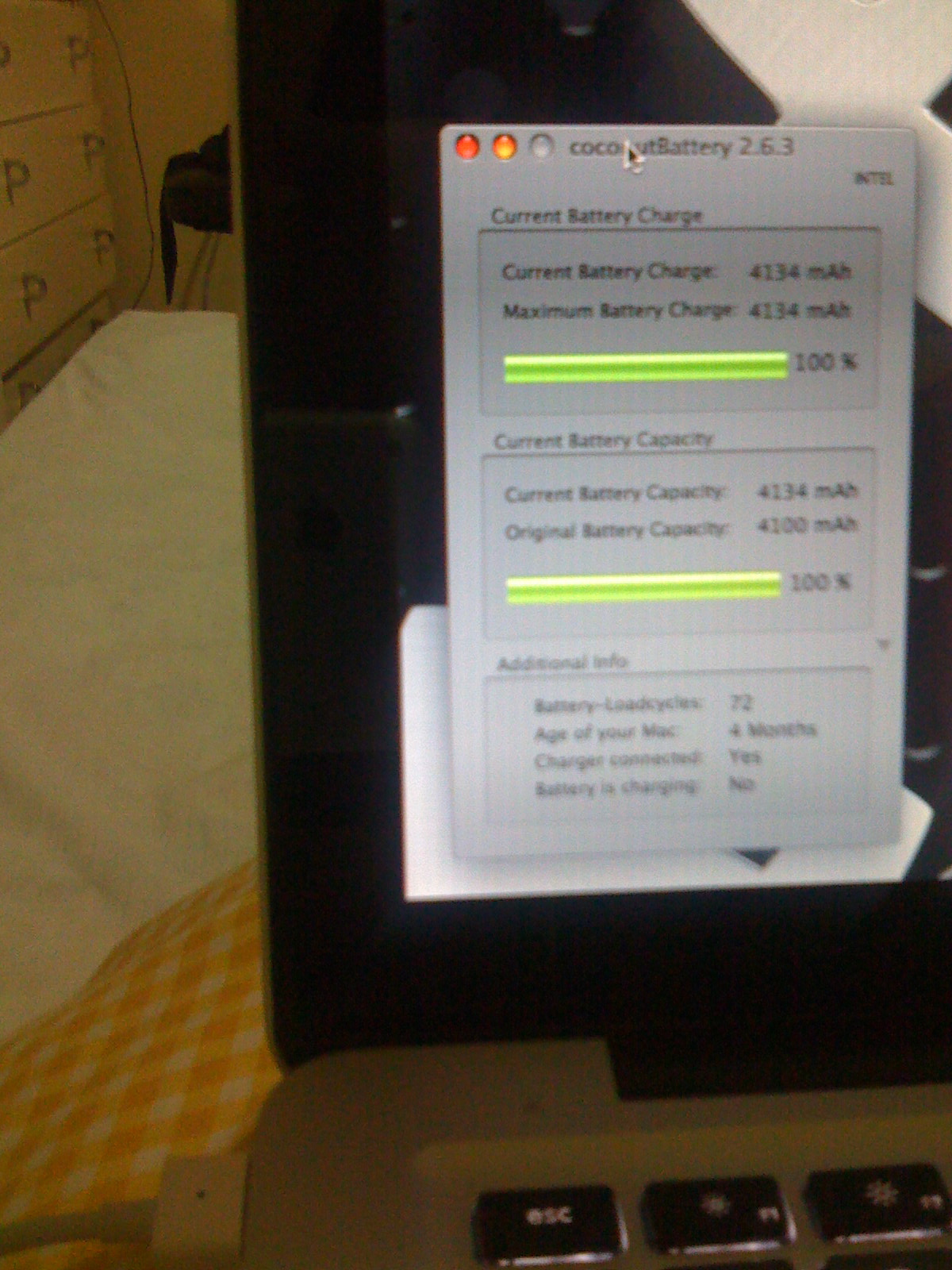

And as a side note, that still won't explain why my magsafe adapter light isn't on right now, when it IS charged. See picture attached that I just took right now:

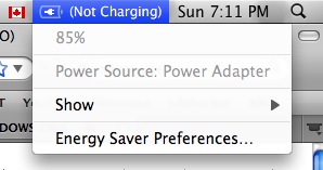

I'll take a picture when it says Not Charging when its below 90% when I drain it a bit.
And here is a picture of the problem.
And the light on the magsafe flickered when I first popped it in, and now its off...

Umm...don't tell me what I'm seeing. It's NOT between 95-100% when it says Not Charging, because it has happened plenty of times, and it is NEVER, I repeat, NEVER between 95-100%.
