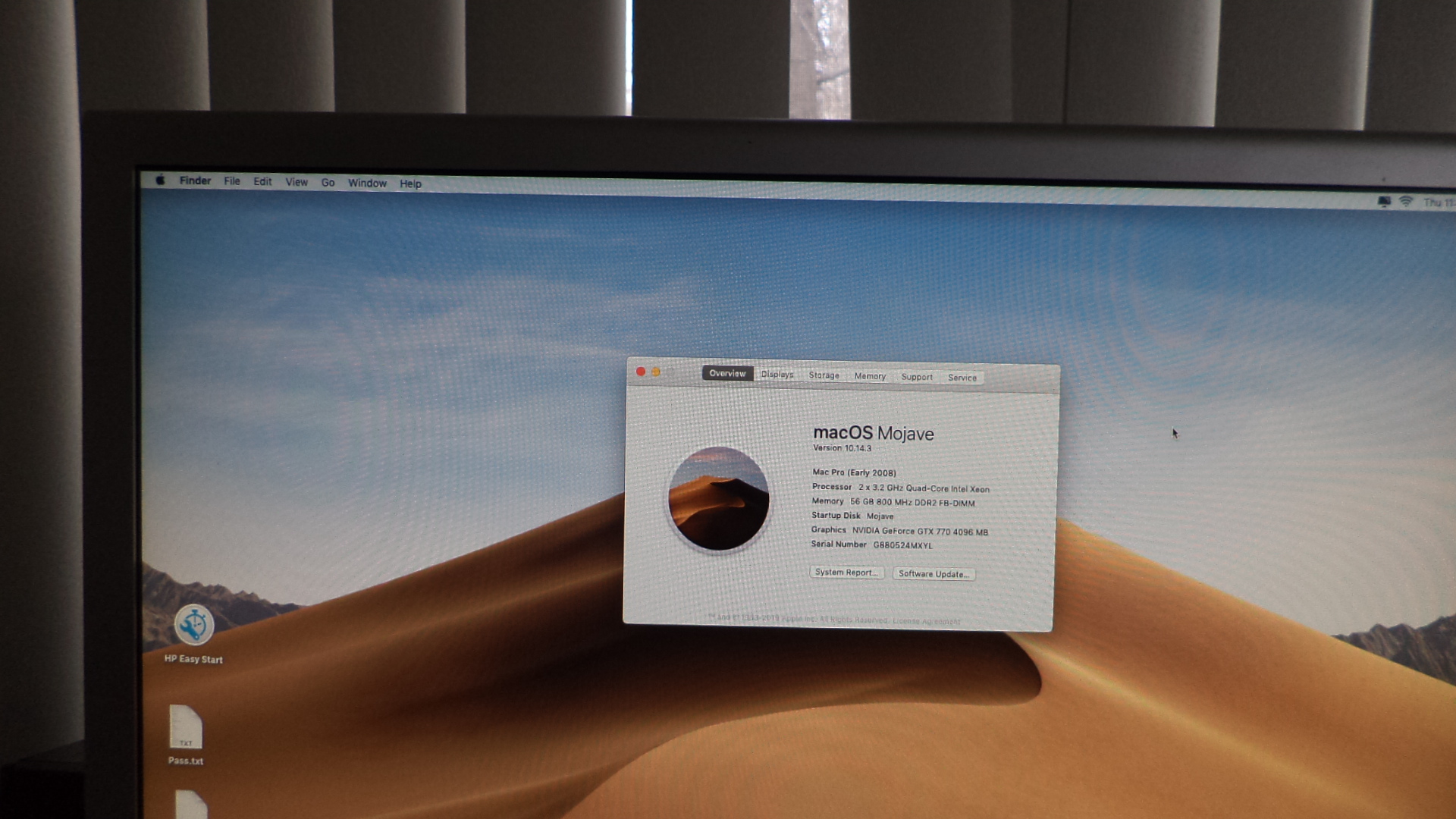

Post screen shot of Disk Utility showing your 3.5" SATA HDD (running Mojave) and your SSD.
If you get to that point, there are several options.
Oh, I've already installed Mojave on a 3.5" hard-drive.. I'll take a pic of the screen eh???..
Here's the Pic, and looks like one of my 8GB Dimms is not working Red LED is lit up (Dimm 2)..
