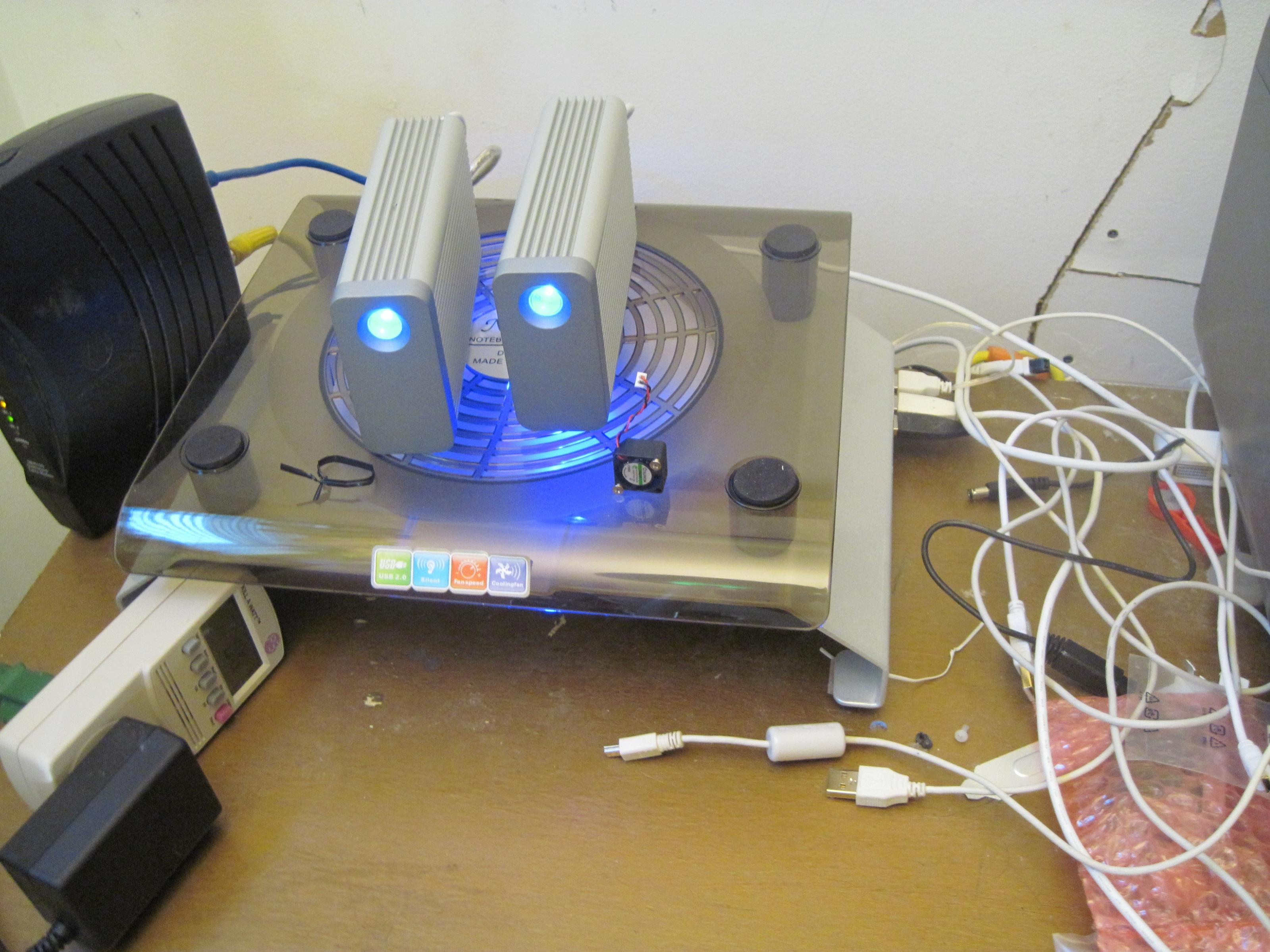

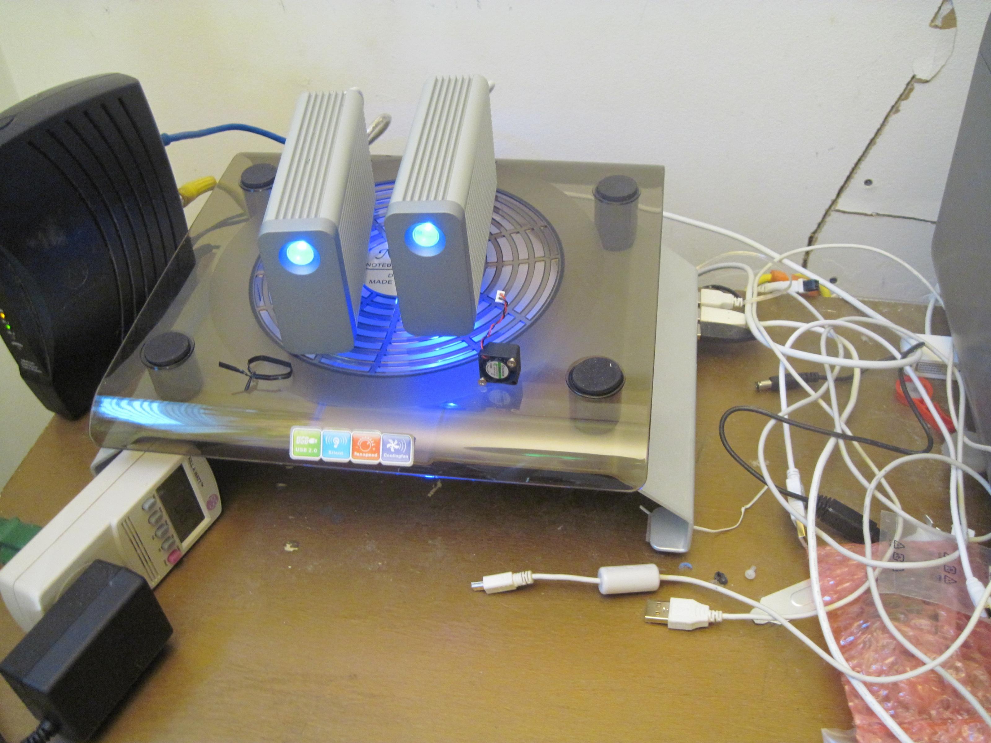

yes here is the lowest cost one. note I am using it to cool lacie little big disks off. As I have done some extensive testing with them. I am looking for purchase link. Personally most mac mini users do not need it. I do many mods and test many fan less setups so i have one.
purchase link
http://www.amazon.com/gp/product/B001LIHGFC/ref=oh_o03_s00_i02_details
purchase link
