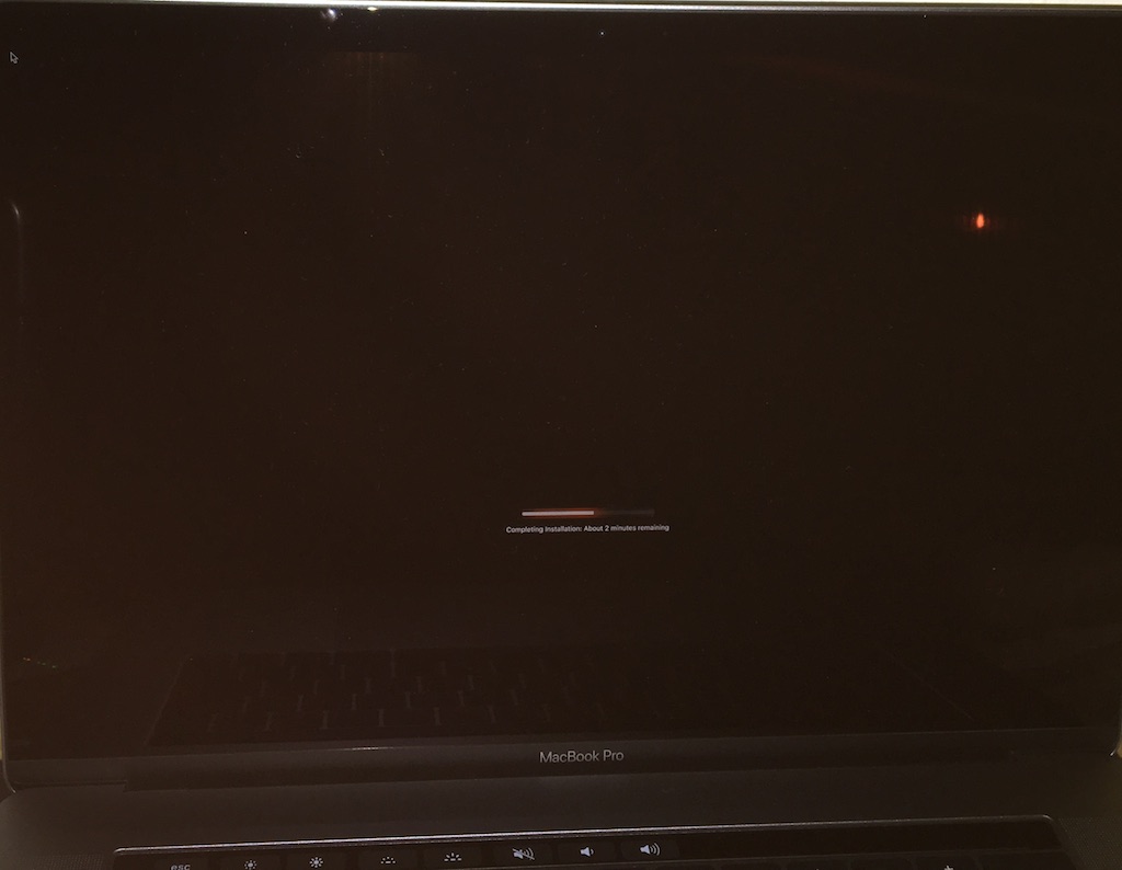

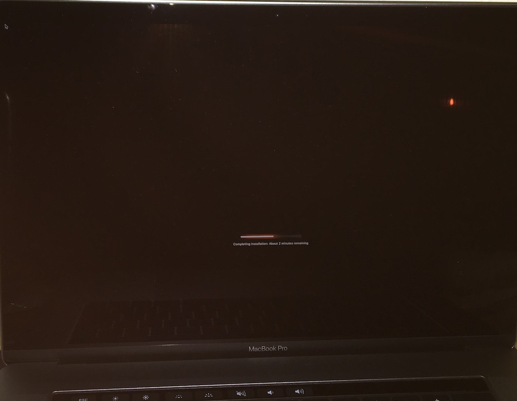

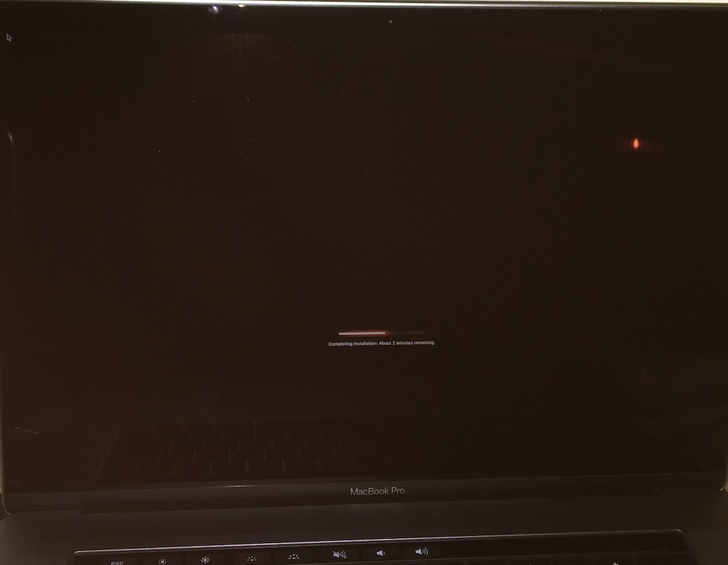

Before I packed it up, I took a photo of another display issue. This has happened on every boot since I scaled the display to 1920x1200:
What you're seeing is the display having gone black during boot, all except the progress bar, the accompanying text and a small halo of the desktop picture around it (the content of the text is another issue, one that existed before this issue presented itself).

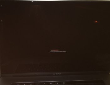

I noticed the same thing, but is it really a hardware problem? It only occurs while in 1920x1200 resolution, so seems to me like a software bug.
