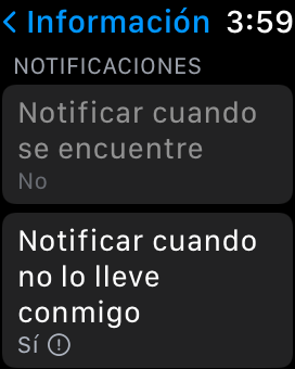

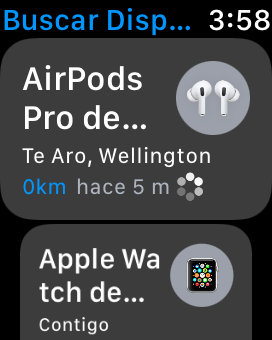

I have been searching for months for an answer to this, and my curiosity lead me to check the find my app on my Apple Watch... After tapping on my AirPods Pros in the Apple Watch app, I saw the option for the notification and enabled it! (Apologies my watch is in Spanish, but the English options should be pretty self explanatory 😅)

I checked my watch and it's on there too.. Wonder why it's not listed on my phone? I never enabled it for my APP's but it shows enabled which is also odd..
