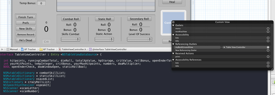

Here is a photo of my connection. I declared my Instance variable in the header file of the TableVewController which most of the code is written in. Then to get and set the image, the code is performed in the Implementation file in the awakeFromNib Method. TableViewController is a subclass of Entry and Entry is a subclass of NSObject

I think I found what I was doing wrong. I was using an NSCustomView and that was giving me the error with setImage. I then did a search in the library for NSImage and Image Well came up. I deleted my NSCustomView and replaced it with an Image Well, atttached the code and the photo appeared.
Sorry for the confusion folks. I guess I misunderstood what the NSCustomView is for. But the image Well seems to work.

Your sample project doesn't work because you don't have an NSImageView anywhere in your nib, nor is your imageView outlet declared as an NSImageView. If I put an actual NSImageView in your nib, change the NSView outlet to an NSImageView, and hook the two together, everything works fine.
