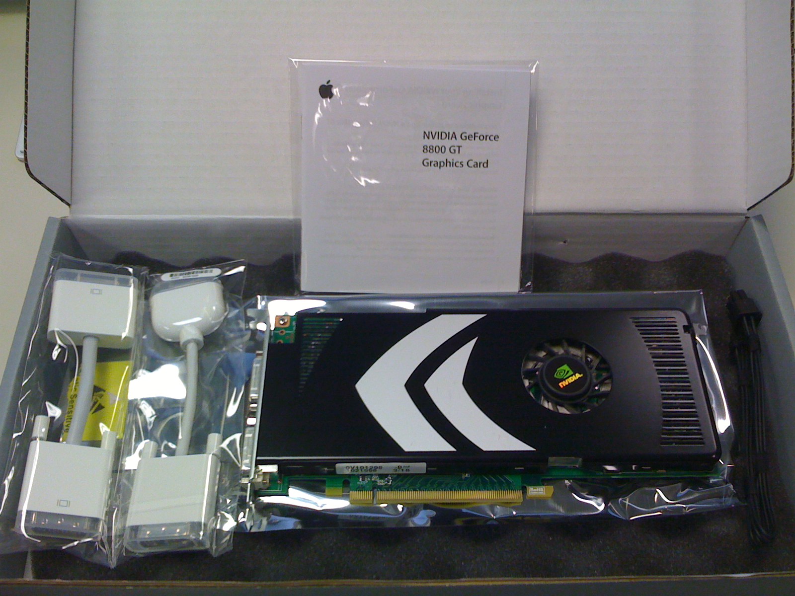

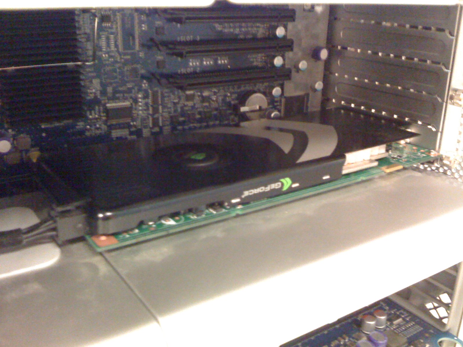

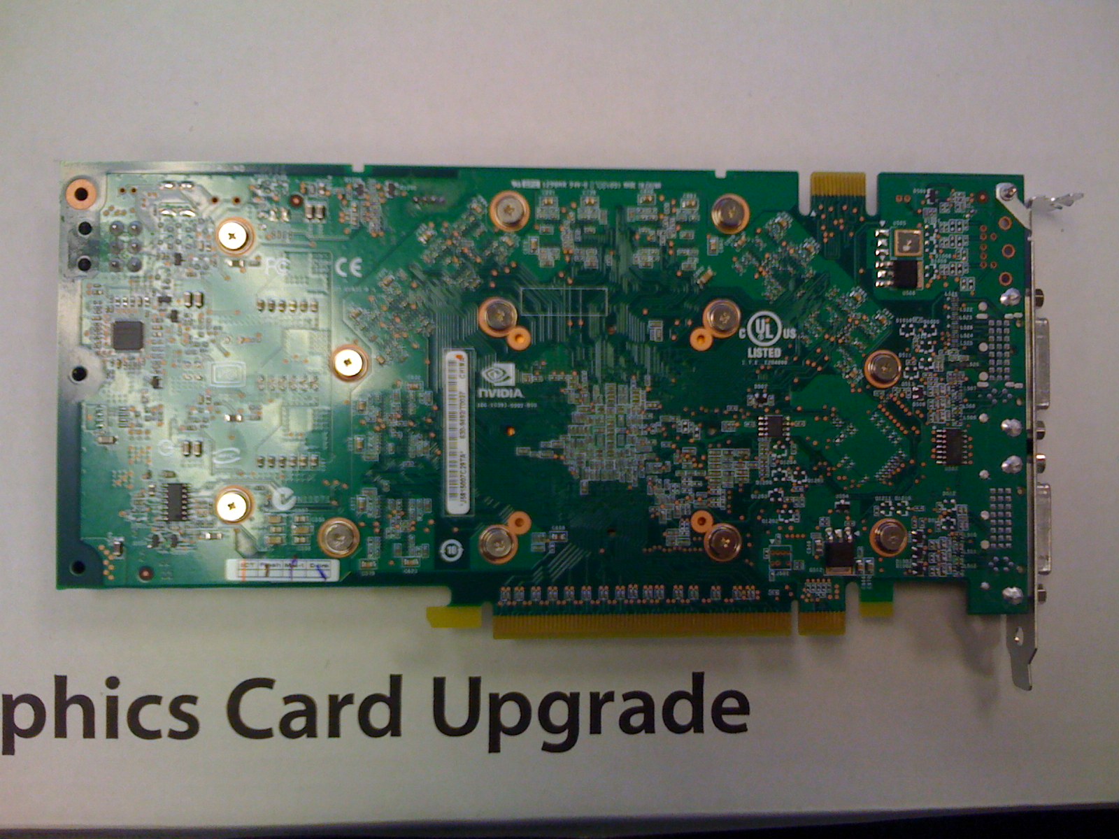

Well i just got mine and installed it. No more vacuum cleaner at startup.
System Profiler shows...
NVIDIA GeForce 8800 GT:
Chipset Model: NVIDIA GeForce 8800 GT
Type: Display
Bus: PCIe
Slot: Slot-1
PCIe Lane Width: x16
VRAM (Total): 512 MB
Vendor: NVIDIA (0x10de)
Device ID: 0x0602
Revision ID: 0x00a2
ROM Revision: 3233
Displays:
DELL3007WFPHC:
Resolution: 2560 x 1600
Depth: 32-bit Color
Core Image: Hardware Accelerated
Main Display: Yes
Mirror: Off
Online: Yes
Quartz Extreme: Supported
Rotation: Supported
Display Connector:
Status: No display connected

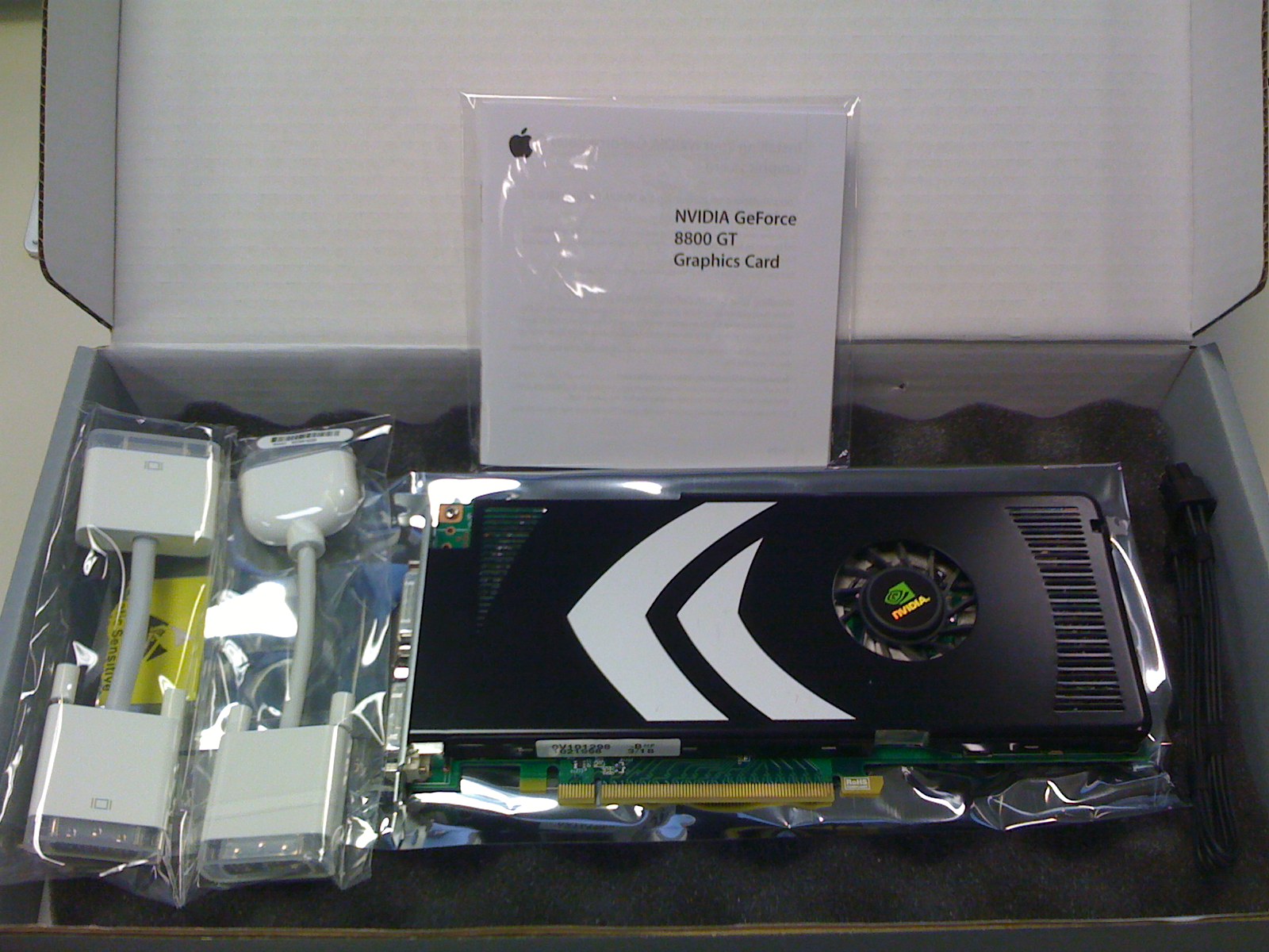

Type: Display
Bus: PCIe
Slot: Slot-1
Device ID: 0x0602
Revision ID: 0x00a2
ROM Revision: 3233
Displays:
DELL3007WFPHC:
Depth: 32-bit Color
Main Display: Yes
Mirror: Off
Online: Yes
Rotation: Supported
Display Connector:
