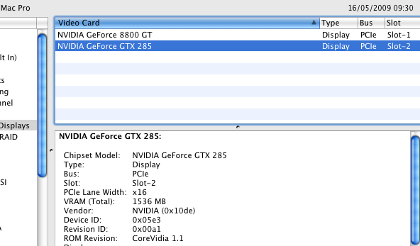

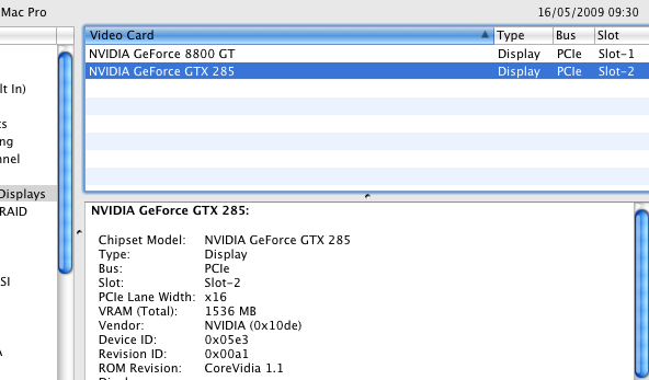

PC version now coming out of coma
Given the ghastly price of the Mac edition I played a bit with Core Vidia this morning with my PC 285, as per my short thread here:
https://forums.macrumors.com/threads/694694/
I used 10.5.7, CoreVidia 1.1, set the memory to 1536 (I have 2G card but cannot do 2G yet), also edited the CoreVidia plist, pasting in an NVCAP setting from an NVFLASH ROM dump with NVCAP maker and adding the 0x05e3 PCI ID, and after a LOT more fiddling around, have got this far. No QE/CI, Link Speed 2.5, not 5, and CUDA is not working properly, but it illustrates it might be a pure driver issue. My Reward/Effort on this is very low - we really do need to see know what is on that driver disc, and even that I do not know if I will get it totally up without a ROM flash.
