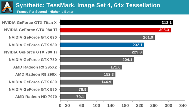

Full review at Anandtech: http://www.anandtech.com/show/9306/the-nvidia-geforce-gtx-980-ti-review

According to the reviews, this card comes within about 3-4% of the performance of the Titan X, which is a $1000 GPU. Considering that, the price is actually very reasonable.
The issues is the x80 and x80Ti keep getting more and more expensive through the generations. I do agree that it's a budget Titan but that's not saying all that much either.
