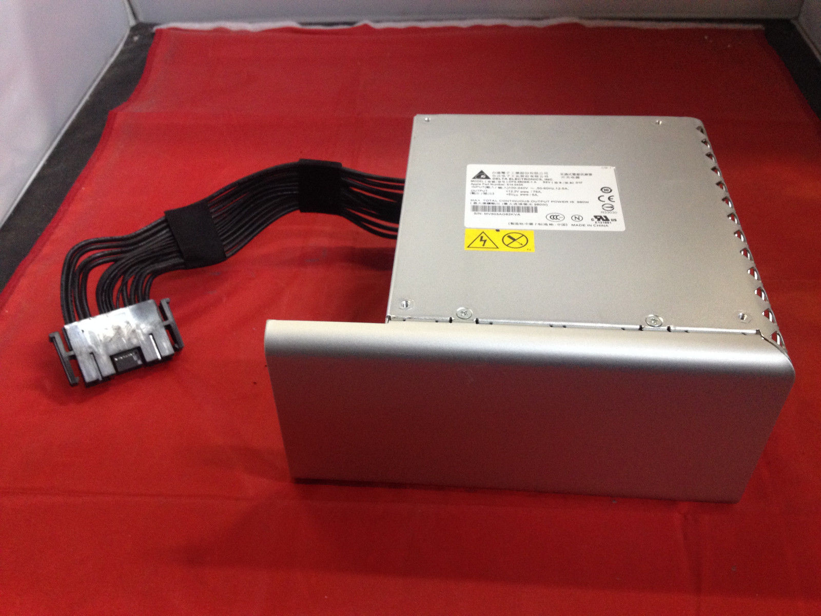

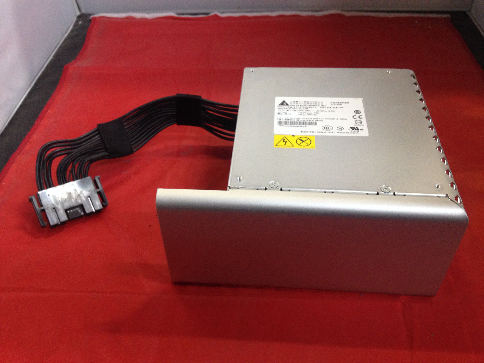

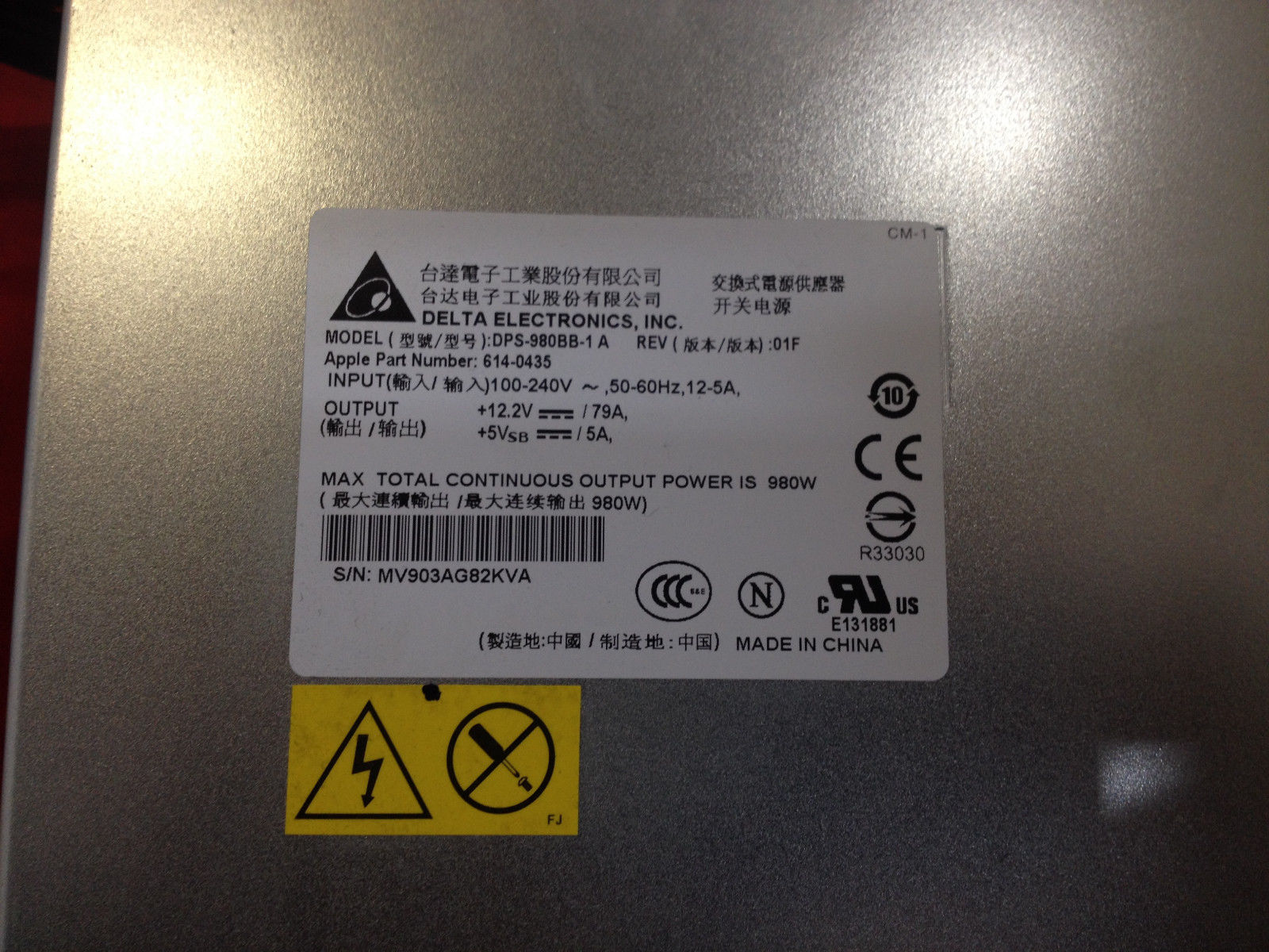

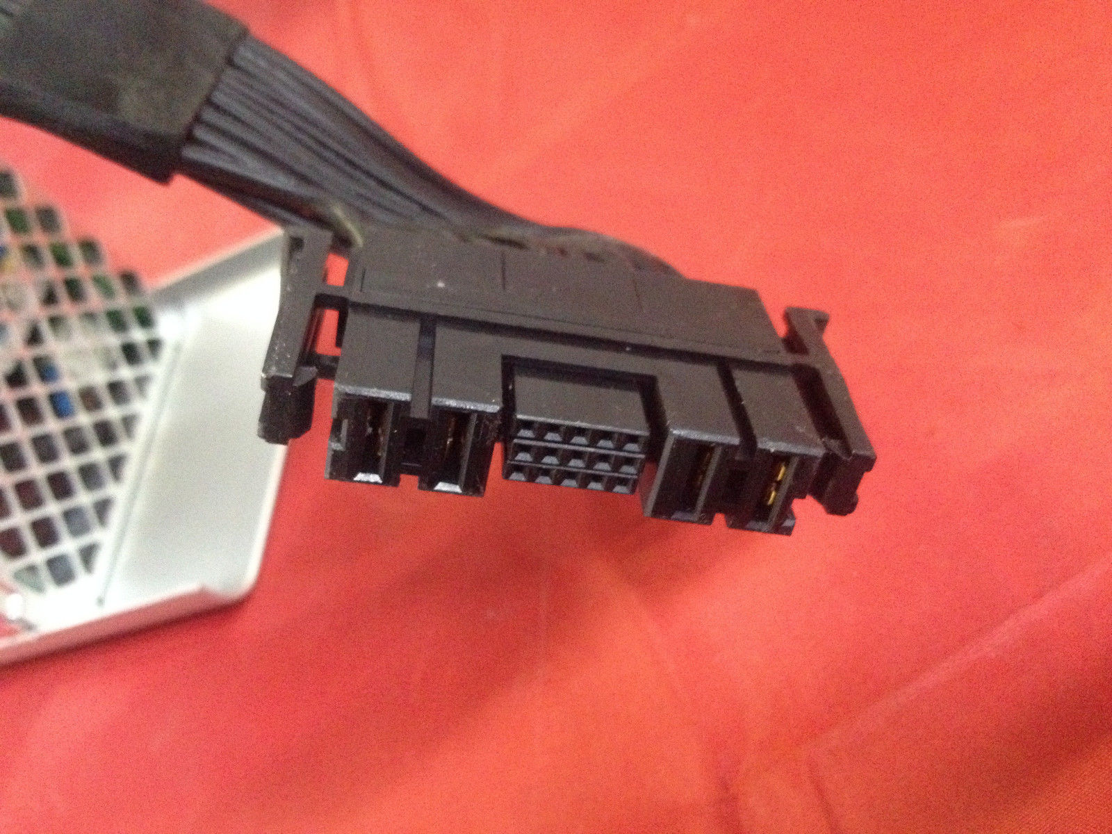

This is interesting, I looked up the PSU in the 5,1.
That 12.2volt 79amp rail is really strange, I never saw a computer PSU setup like this one. I guess the trick is just tapping off the right wires, to create the 150 watt 8pin cables.
A time ago i have seen an other sticker on a MacPro PSU with 5 rails, but i think this was a 2008 PSU
For 4,1/5,1 there's a way to draw power directly from PSU, entirely omitting backplane board. It's possible (and safe) because PSU in these has single 12V rail with 80 Amps. Been there, done that.
In my main machine I have 2 fully powered 8-pin cables and I can use 2 6+8 pin GPUs without underclocking/volting and such stuff. 8-pin ones come directly from PSU, 6-pin ones are connected to backplane.
With 2008s and 2006s it's more complicated because these have multiple rails with much lower Amps each. And you don't know precisely from which rail it's safe to "steal" the juice. If you'd choose the wrong one, there will be not enough current to feed CPUs for example.

Here is the guide:
– disassemble the PSU
– solder 16 copper cables (18 AWG at least) to 12V and GND lines (you gotta know 8-pin plug pinout obviously)
– route cables through "cable hole"
– crimp and put plugs on
and it's done.
