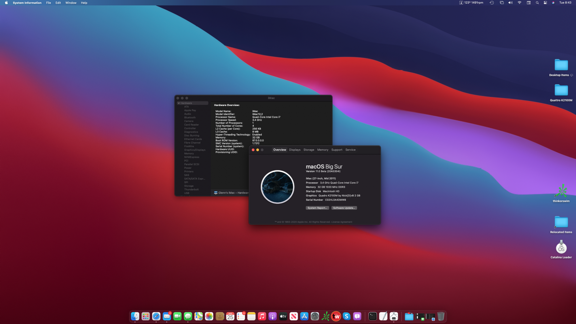

Got mine in and flashed. Install to Big Sur Beta 5 went down tonight. So far, so good!
