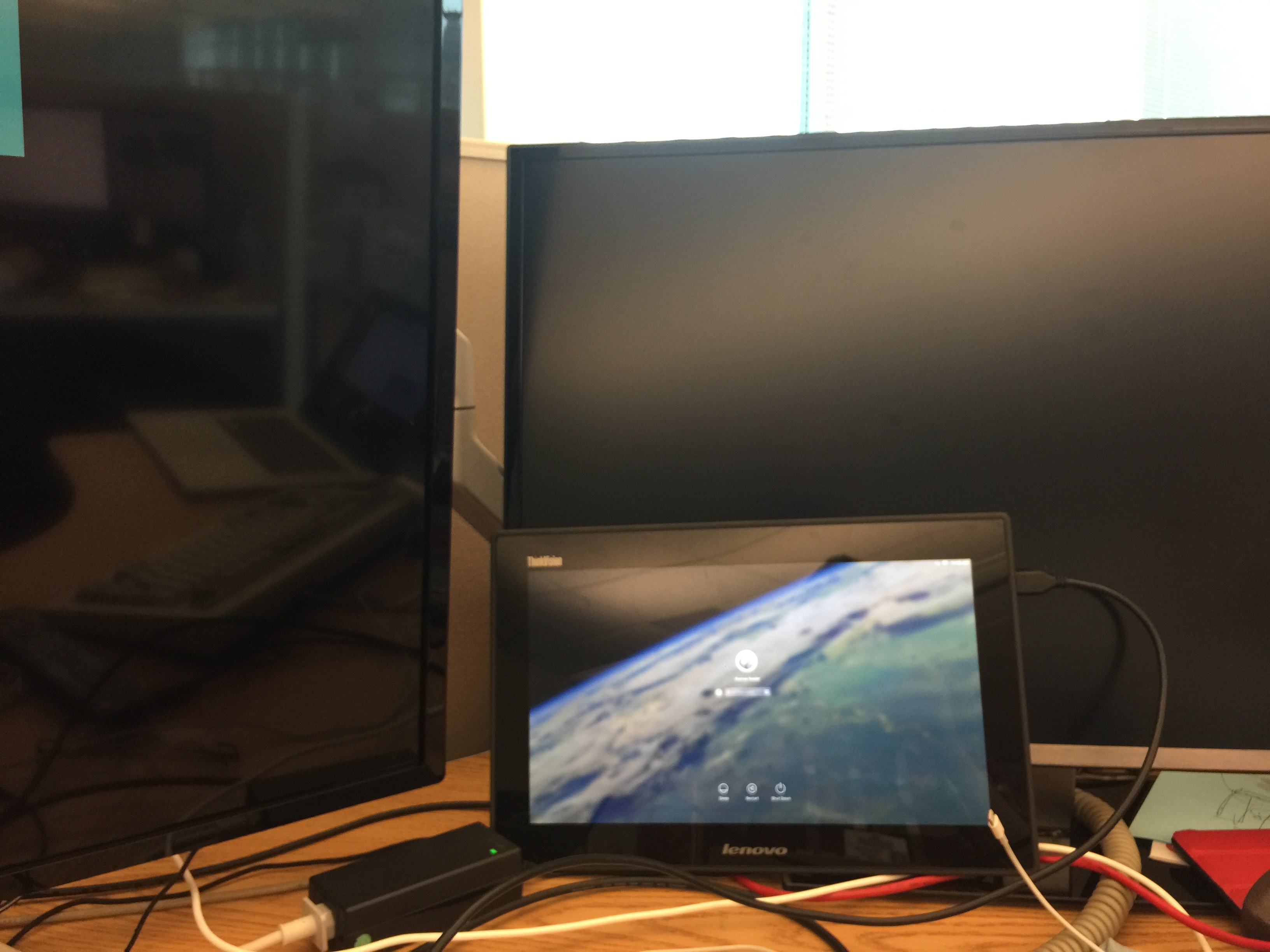

Rather than swapping around PCIe Devices, a USB 3.0 display was an easy way out install Nvidia's latest drivers.
Although logging in appeared to hang, replugging the usb display cleared the issue.
After the install of the Nvidia drivers and a reboot, all is happy again with a non-flashed gtx 970.

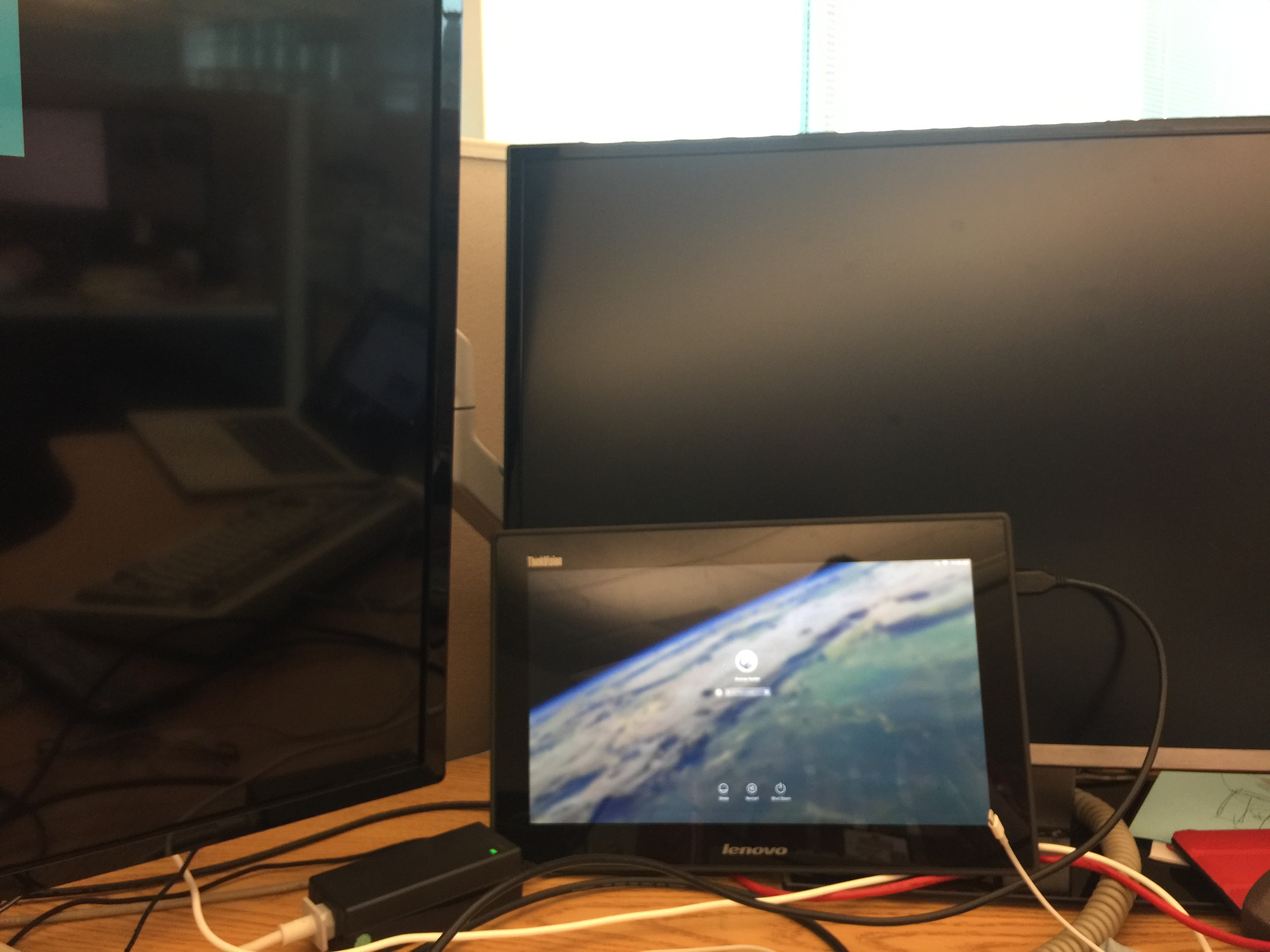

The USB DisplayLink Drivers load in the boot process and becomes active before the login screen appears. Cheap USB 3.0/2.0 display adapters can be picked up for $40 or less, USB Display's start around $80. Either make a great fall back in case of a Nvidia driver snafu.
Personally, I'm using a Lenovo Touch Screen / Pen device that comes in handy for iOS/Touchscreen development.

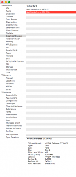

I was given an Asus GTX 670 2G (2 x 6 pin) that works without problems in a Windows PC but installing it with the correct two power lines from my Mac 3,1 motherboard running 10.9.5, or 10.11.4 or 10.11.5b1 produces no video at all at any of the video out connectors. The MacPro RAM posts, and the card fans are running but no video at all even after waiting 15 minutes for the log-in screen, which remains black. I thought 10.9.5 and 10.11.4 supported this card OoTB but am not surprised that 10.11.5 does not because there are reported driver problems even with the GTX 680 Mac edition. Is there anything else to try, like installing the nVidia web drivers for 10.9 and 10.11.4?

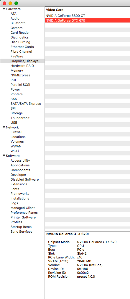

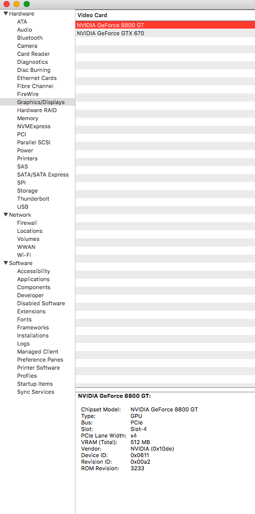

I dled them and installed using an nVidia 8800 as the video card (slot 4). To see what was happening, I installed both the 8800 and the 670 (slot 2) with the 8800 powered off the MacPro motherboard and the 670 powered off an external PSU with video connected to the 8800. In this configuration, the gray progress bar got half way across, stopped, the screen went black and the Mac rebooted. This reboot happened a second time too and a third and so on.
Next, I booted in Safe mode and the gray progress bar went past the previous stop place, paused at 2/3rds and then finished up and I got to the log-in screen.

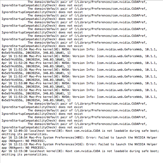

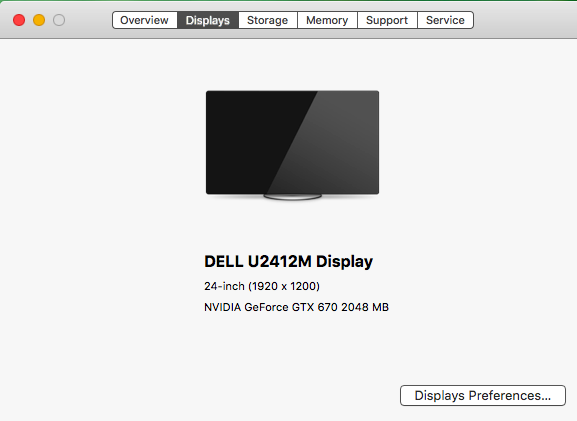

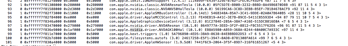

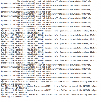

Here is where it gets weird—remember the display is connected to the 8800. I switched the video to all the 670 outputs and nothing. About this Mac—Displays shows the correct presence of the 670 with 2 MB as driving the display BUT it is not. See upload pic 1. Next, More information shows the presence of the 8800 and the 670 correctly (pics 2 and 3). Kextstat shows the loaded nvidia drivers (pic 4). So the system knows the 670 is there but there is no video out.
Last, I tried to launch the nVidia Sys Preference but it won't load because the Mac is booted in safe mode (pic 5).
To me, this suggests there is a drivers problem and not a video hardware problem.
I don't know if this helps anyone.....
Suggestions?
The Nvidia drivers built-in to OS X should work fine with Kepler cards. You should not need to make any changes nvram. All the versions of OS X that you tried should just work.
The Nvidia web drivers should also work but are NOT needed for Kepler cards. They are entirely optional.
I know it SHOULD work but it does not. There is no output from any of the 4 video outputs on the card backplane—see my posts.
The card works fine in Windows 7. No idea what the problem is but I have exhausted all the test avenues I can think of.
Have you tried a clean install of OS X? Have you tried without the 8800 GT installed?
I think something is preventing the drivers from loading on your system.
If I remember correctly, MVC mentioned that (some) GTX 670 causes trouble, that's why he's not offering them in his shop, avoiding ASUS cards anyway.
