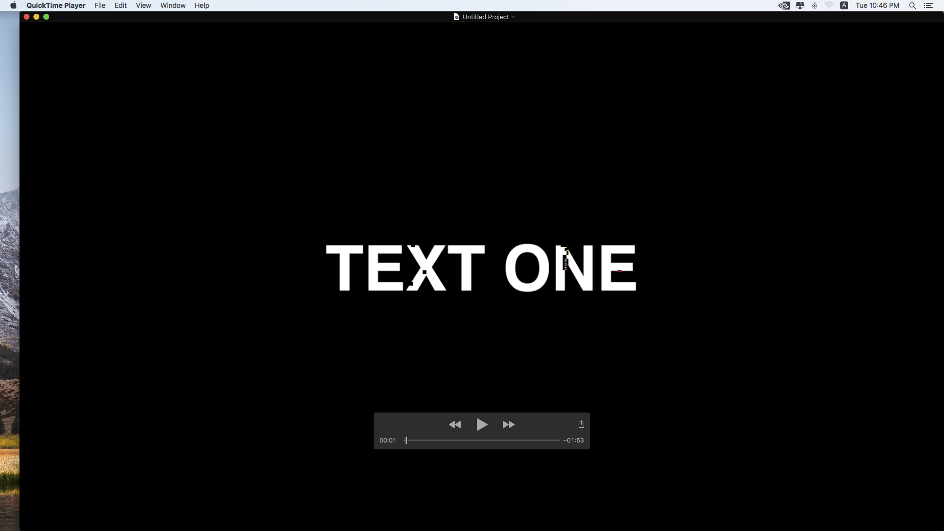

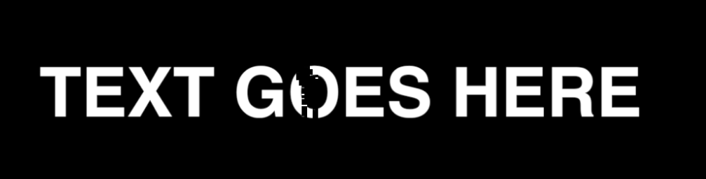

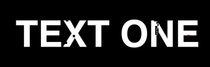

After the updating to HighSierra 10.13.4.
there was new trouble and bug too.
gtx970 GPU
nvidia webdriver 387.10.10.10.30.103
Mac OS High Sierra 10.13.4
Final Cut Pro X 4.1
mismatching on those of factors make my FCPX be glitched.
here's the result of bug after rendering
1) Disable SIP
2) run the following command in terminal to roll back the Nvidia web driver (V378)
Code:
bash <(curl -s https://raw.githubusercontent.com/Benjamin-Dobell/nvidia-update/master/nvidia-update.sh)
3) Reboot
This is a known web driver (V387) issue. The above steps should clear it.

New Web Driver released today:
https://images.nvidia.com/mac/pkg/387/WebDriver-387.10.10.10.30.106.pkg
Another member, h9826790, posted that the FCPX problem is fixed.
Lou
I've been seeing similar and reproducible color artifacts with my GTX 970 in the Finder when resizing a window (and elsewhere and in other situations) that also seems gone now with in the 387.10.10.10.30.106 driver.
This version is also supposed to fix the user interface lag that some has been seeing.

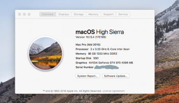

Not sure if this is the right place but I am also seeing the same issue... my setup
2009 Mac Pro 4,1 upgraded to 5,1
Installed a Zotax GTX 970 on slot 2 of PCIE lane (have a custom backplate for cooling)
Upgraded to the latest nvidia driver 387.10.10.10.30.106.
I can hear the boot chime and notification sounds but I see black screen. I put back my GT710 and it would show the screen.
So I am wondering if I am doing something incorrect as I really want to use my 970 on this Mac...
Thanks in advance!!
