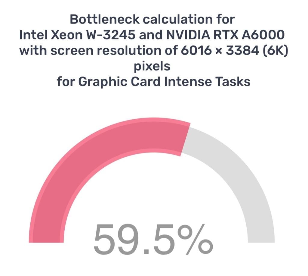

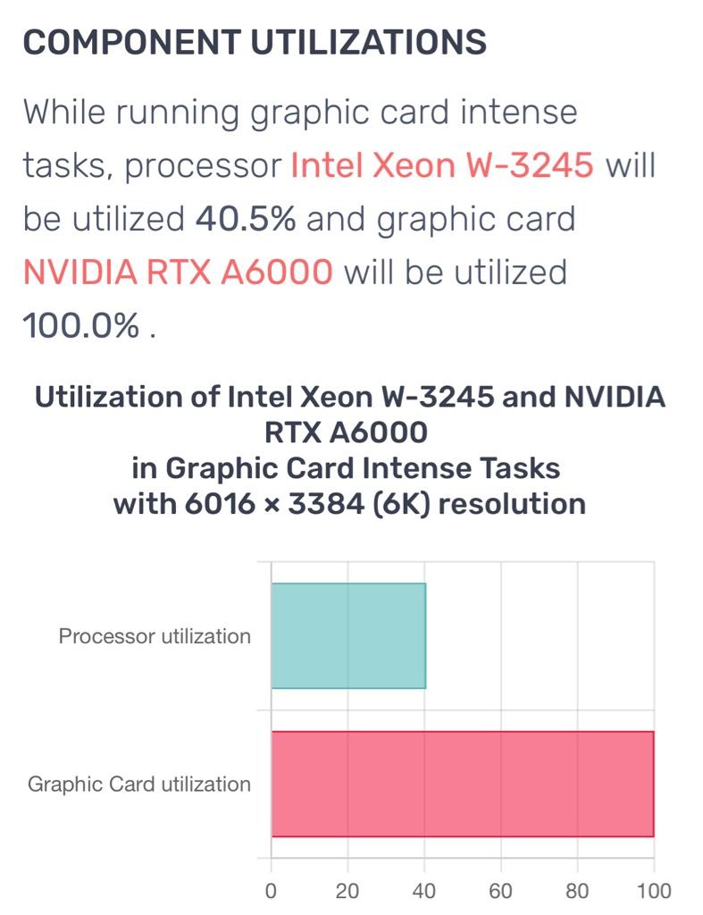

How does one understand bottleneck? Is the 16-core CPU inside the Mac Pro (2019) using the A6000 to its full potential or not?
