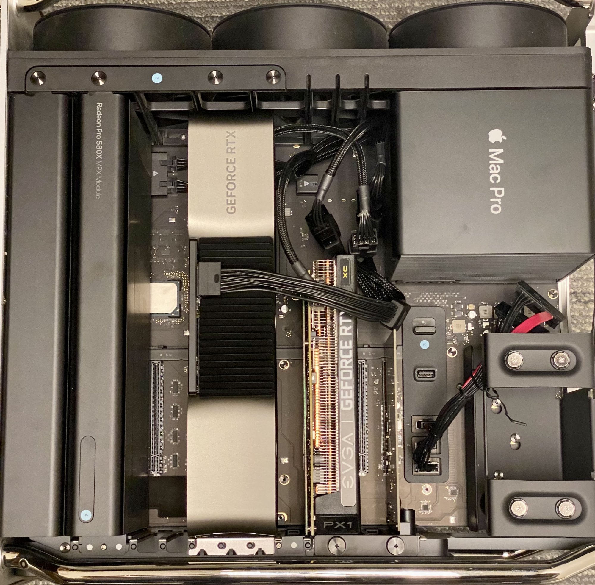

I finally nabbed a 4090FE and put it in my 7,1 2019 Intel Max Pro. In the picture, I have a 3 pcie power plugs going to the 4090 and one going to a 3060. I removed some pcie slot covers so the hot air from the GPU can be pushed out. Works quite well in windows (obviously). I haven’t gone back to MacOS yet though. For that I usually just use my laptop. View attachment 2244105

The RTX has a single 12 pin to dual 8 pin connector If I'm right.
Where is you get the 8 pin to mini 8 pin for the motherboard if you don't mind?
Hi.
Belkin sells a Mac Pro kit. You can also find individual cables on aliexpress but sometimes you’re rolling the dice on that site
I think the RTX 4090 FE adapter uses 3x PCIe 8-pin cables, fyi. That'd leave 1x 8-pin and 1x 6-pin in the Mac Pro.
4090’s have adapters with 4x pcie 8-pin sockets. They can work with just three plugged in though

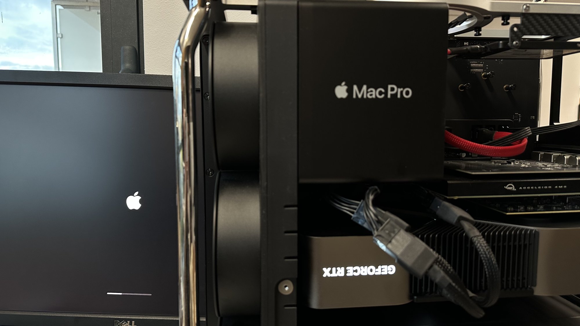

I use either W5700X or 6900XT along with 4090. I have installed a separate PSU to accommodate for 4090. Whenever I go to Windows I turn on the PSU switch to use 4090, and whenever I go back to Mac OS, I turn it off to avoid kernel panic whenever it goes to sleep. Now it's working flawlessly.
By the way, correct you won't have enough power for 4090 + 6900XT. I used to have 3090 and that was fine with 6900XT.
Hope this helps.

I hit one peculiarity though: I had to move the RTX to one slot above my MPX W6800X. Otherwise during boot I was getting the PCIe card error behavior (orange LED flashing two times).
If Mac Pro encounters an error with a PCIe card, the status indicator light flashes amber twice and repeats until the computer is turned off.
I tried swapping the source of PCIe power (1&2 + 3, 2 + 3&4 and other combos) but it didn't help. Moving up – did. I also used the MODDYI "ATX 3.0 PCIe 5.0 600W 12VHPWR 16 Pin 90 Degree Angled Extension Cable" (B variant) in order to be able to fit everything inside the case. No external ATX PSU needed, phew!
The fans on RTX spin with minimum speed, so no noise here, great. On Windows though I had to create a configuration where I boost the fans on both RTX and intake fans, as the system seemed unstable under load (BSODs).
I connected my TV to the HDMI output of the RTX (and I use it on Windows 11) and my two LG monitors to Thunderbolt outputs of the top PCIe card of the MP (on MacOS).
