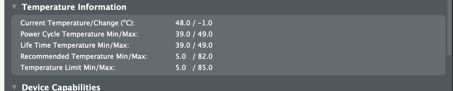

This is the temperature of the SSD after running BlackMagic for 5 minutes:
Reactions: zalle

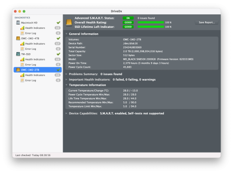

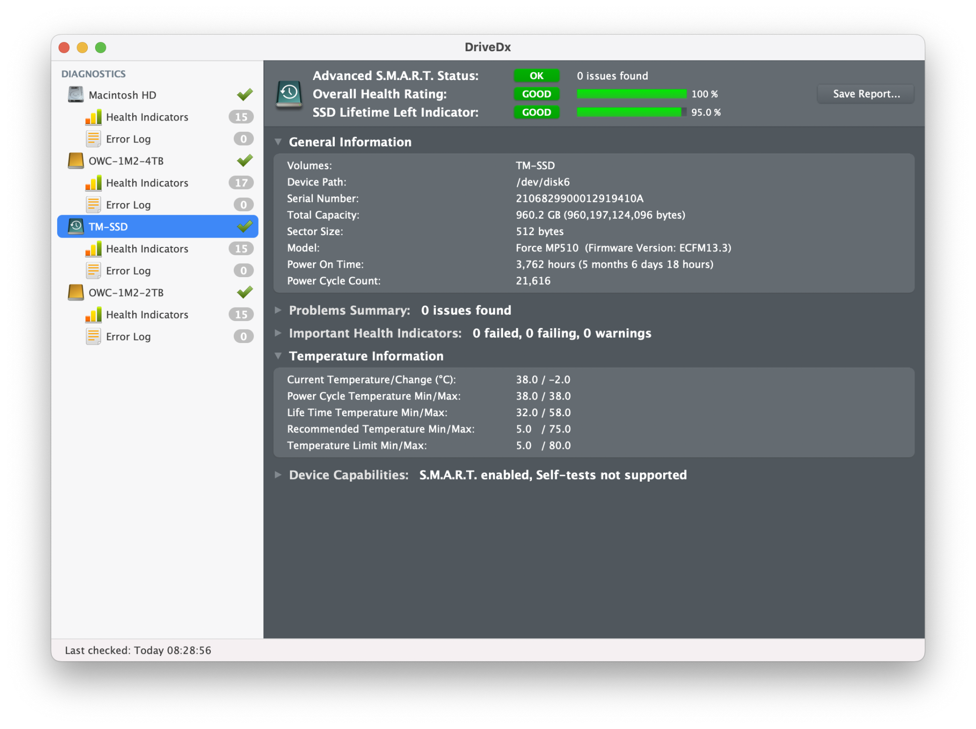

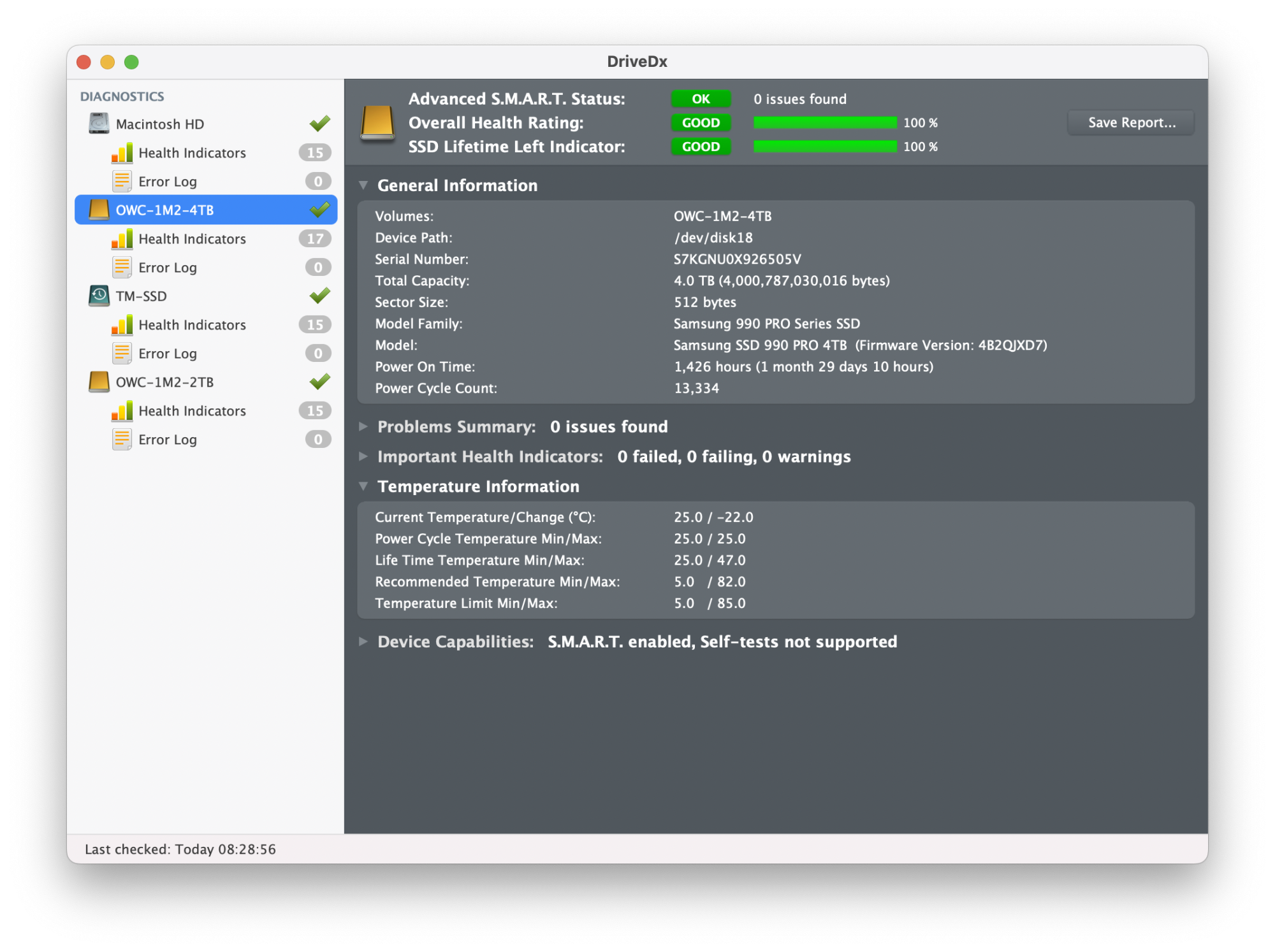

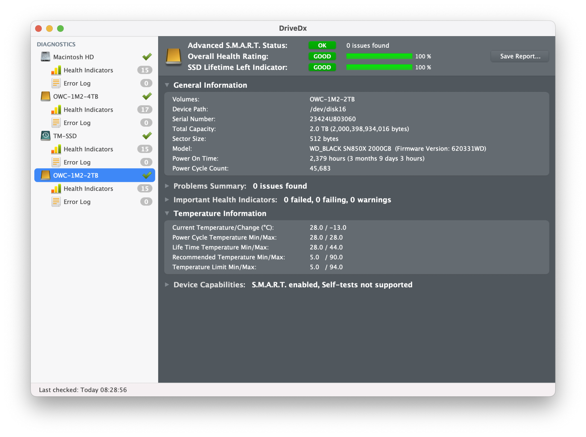

Those temps seem much more reasonable. FYI, you should be able to see the drive’s temperature threshold (“Temperature Limit Min/Max”) in DriveDx.
Here are mine:
The TM drive runs a little warmer, most likely because the enclosure doesn’t have quite as much surface area as the OWC 1M2. Room temp varies between ~21ºC and 27ºC.
