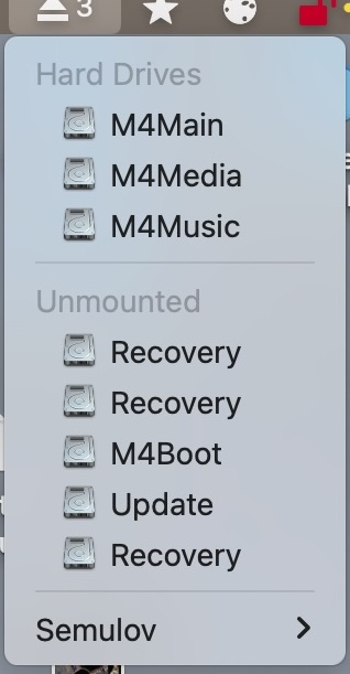

Maybe my words did not sound as expected. Now that I read it again it sounds I was being sarcastic, but I was not. It was a real question "just ignore it?". I installed Semulov, I've tried it, and will be using it. Look at the print screen, it's on!
Thanks for the time you took to help me, and sorry for the misunderstanding.
