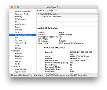

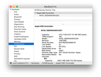

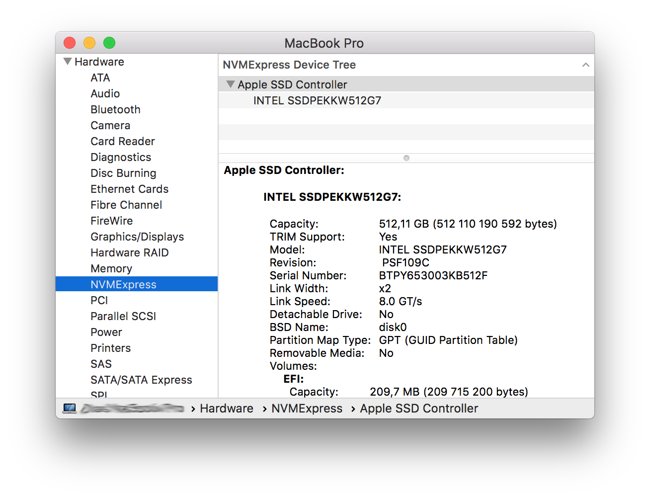

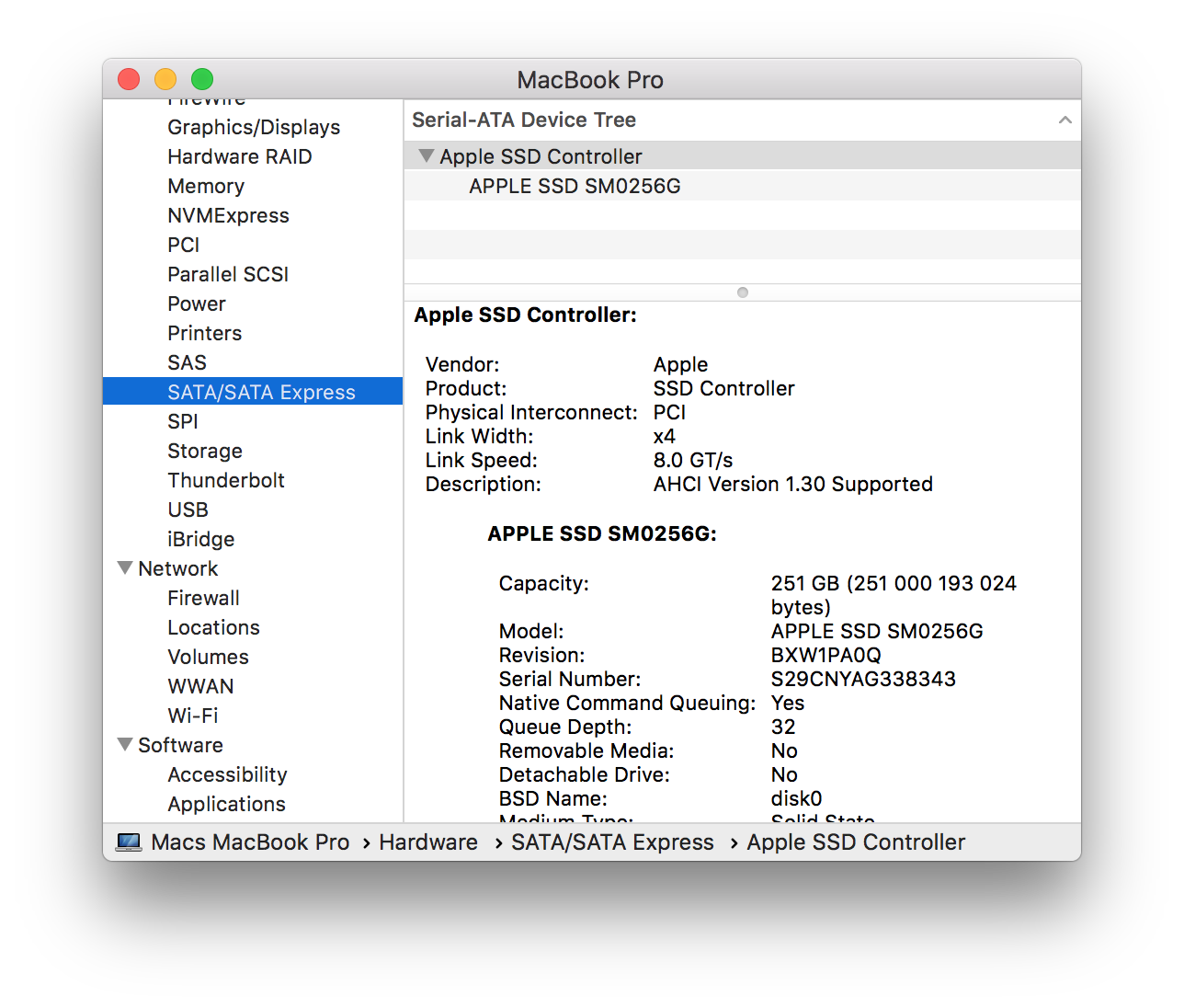

@jerryk I read that article before posting and I could not understand how Apple can achieve such speeds with PCIe2.0, yes it is 3.0. It is strange that the SSD in System Profiler shows under SATA/SATAExpress and not under NVMExpress. And yes it must be PCIe 3.0 because it says Link Speed: 8.0 GT/s. I was confused because when I put in an Intel P600 (with adapter) the ssd displays under NVMExpress. The Intel P600 is PCIe 3.0 but shows as only 3-lane in System Profiler. Still not so very fra from advertised speed! So I am still confused why the Apple ssd shows as SATAExpress while it is NVMe. Also some NVMe drives with PCIe 3.0 x4 show as 5.0 GT/s (PCIe 2.0) and even as 2.75 GT/s. And does not utilize (negotiate) 4-lane. The worst drive I tested was WD Black 256GB, under 200 MB/s write.
See attached screenshots.

@jerryk I read that article before posting and I could not understand how Apple can achieve such speeds with PCIe2.0. It is strange that the SSD in System Profiler shows under SATA/SATAExpress and not under NVMExpress. And yes it must be PCIe 3.0 because it says Link Speed: 8.0 GT/s. I was confused because when I put in an Intel P600 (with adapter) the ssd displays under NVMExpress. The Intel P600 is PCI2 3.0 but shows as only 3-lane in System Profiler. Still not so very fra from advertised speed! So I am still confused why the Apple ssd shows as SATAExpress while it is NVMe. Also some NVMe drives with PCIe 3.0 x4 show as 5.0 GT/s (PCIe 2.0) and even as 2.75 GT/s. And does not utilize (negotiate) 4-lane. The worst drive I tested was WD Black 256GB, under 200 MB/s write.
Perhaps the Apple developer did not get around to updating the display in the utility. As a developer on OSes and other projects, you always have more things to do then you can get done. So somethings don't rise to level of doing them instead of something more important. In this case I can see that especially since the code would have a very limited life span since they knew the 2016 design was coming out in a few months.
