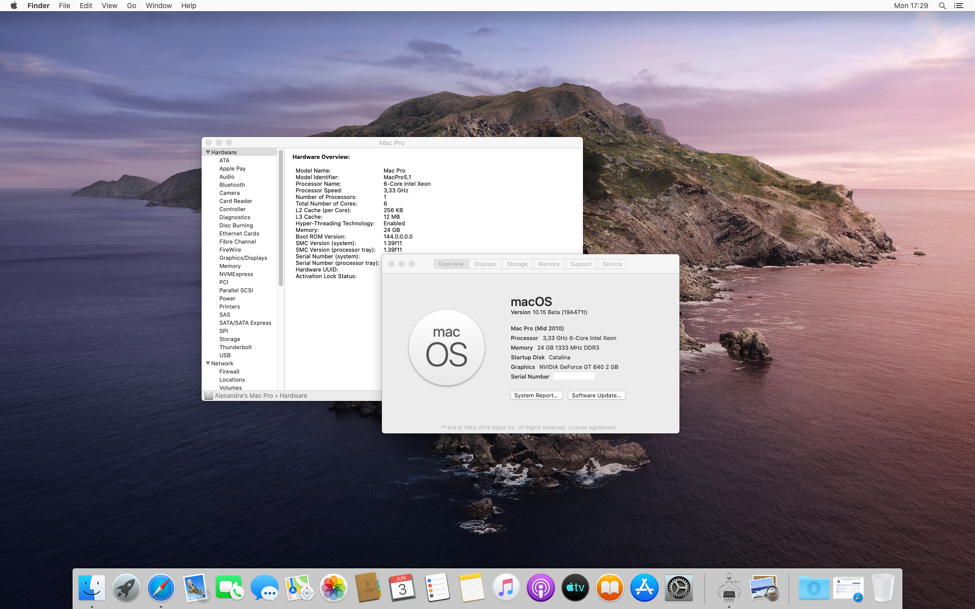

This is a thread dedicated to what is needed to make Catalina work with the now unsupported mid-2010 and mid-2012 Mac Pros with a METAL supported GPU. If you want to discuss about why Apple removed support, please go to this thread 10.15 won't support MP5,1 anymore, support starts with MP6,1.
If you install Catalina with a supported Mac then move the drive to your MP5,1 (with a METAL supported GPU) or use Target Disk Mode, or use VMWare Fusion to install to a disk you just need -no_compat_check added to the Mac Pro NVRAM boot-args, after that 10.15 "works" with a MP5,1.
It's a little slower than Mojave, not unusual for a beta with all the debug settings activated, and have some problems, but you really just need -no_compat_check when you install the Catalina Developer Preview with a supported Mac.
You need SIP disabled to change boot-args and you need to do it before installing your Catalina drive. No need to keep SIP disabled, it's just needed to set the boot-args. Btw, you can set NVRAM boot-args directly from the Recovery partition without disabling SIP. If you do it from Recovery, no need to use sudo. Open Terminal and type:

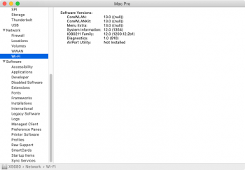

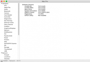

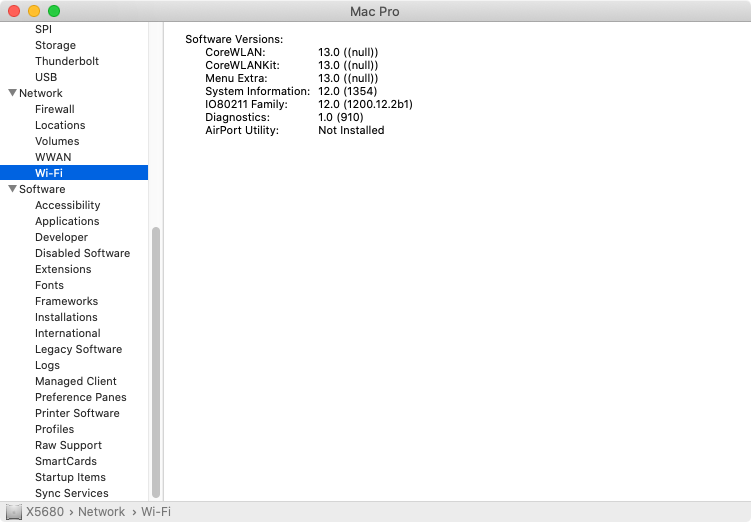

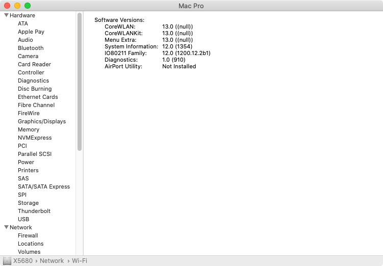

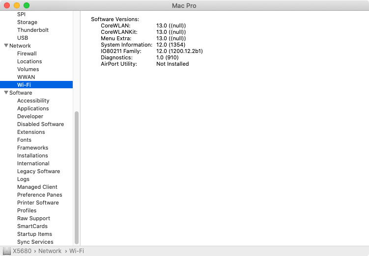

  • MP5,1 AirPort Extreme: Apple removed the driver for BCM94322MC, AirPortBrcm4331.kext, from Catalina, the original AirPort Extreme card from both mid-2010/mid-2012 Mac Pro. If you updated your AirPort Extreme to BCM94360CD or BCM943602CD, both models work with Catalina. The original Bluetooth module works, both Ethernet works. (Mojave AirPortBrcm4331.kext still works with Catalina DP1). Catalina_No_AirPortExtremeBCM94322MC.png

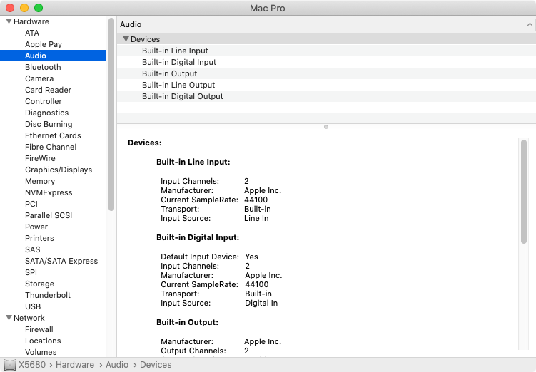

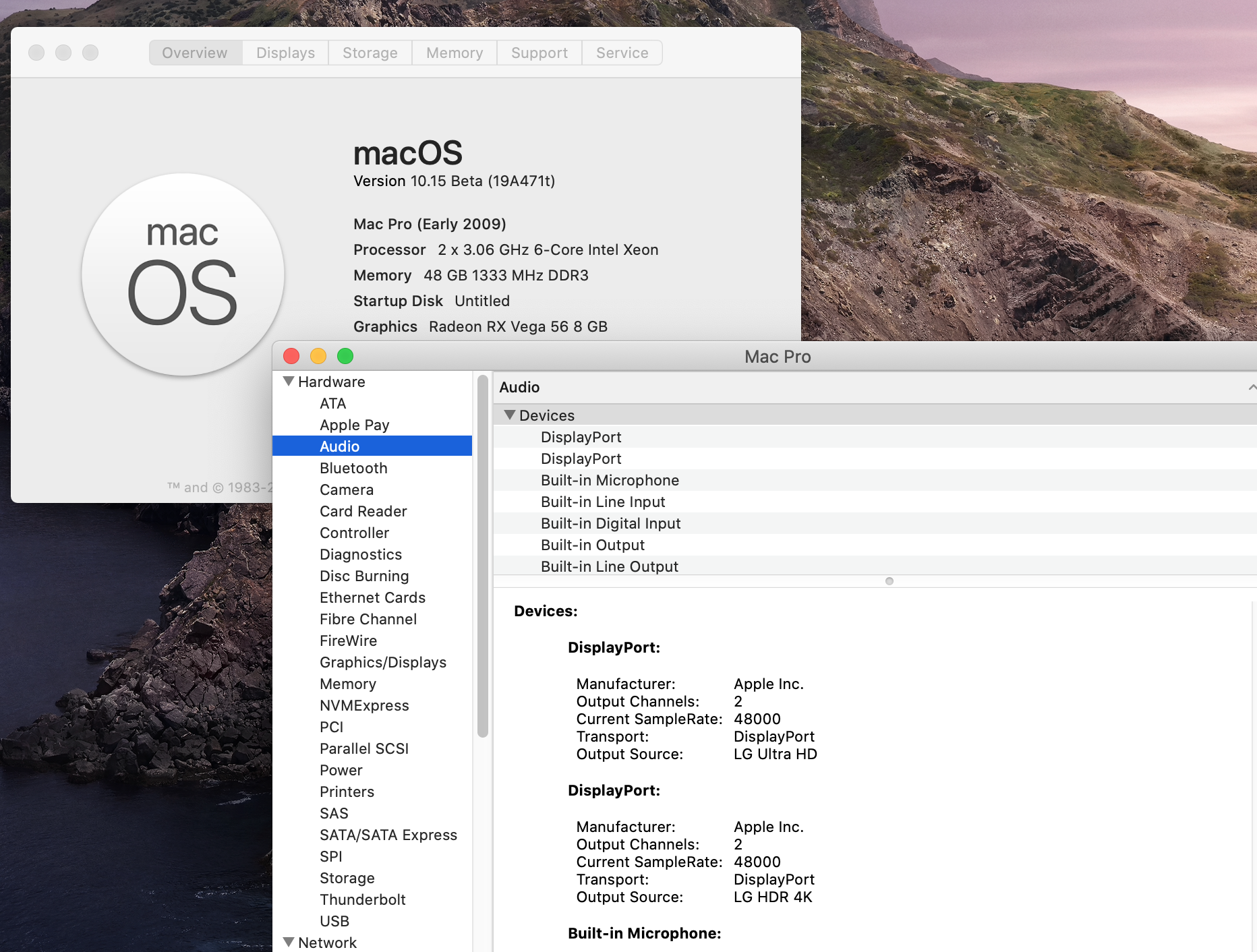

Audio works fine! Both internal audio and Hdmi(displayport) audio for AMD gpus. You'd better double check it.

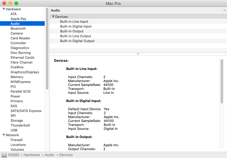

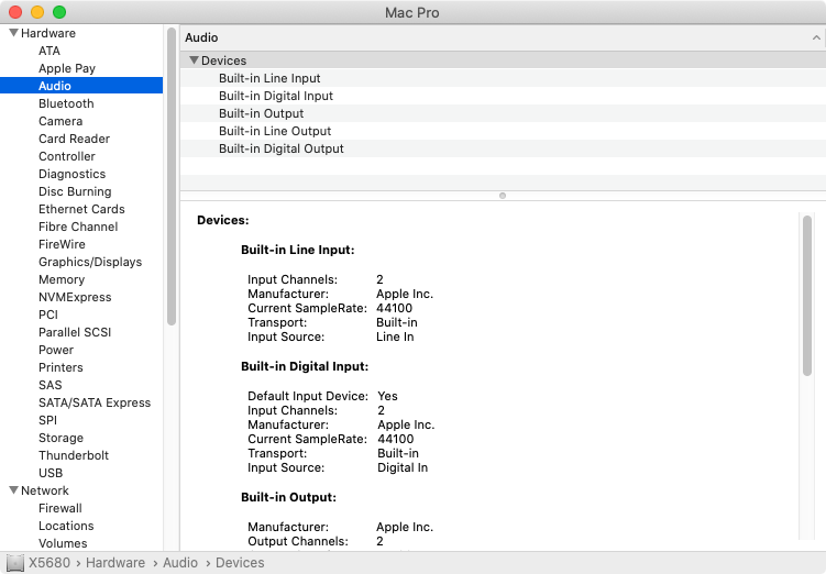

Something in my NVRAM was causing an error of kext signing, only noticed after booting verbose.
Audio works after cleaning three times the NVRAM and re-adding -no_compat_check.
Still no Wi-Fi, BCM94322MC are gone for real.

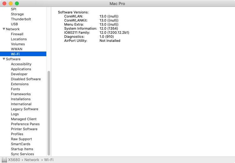

Problems found so far:
- Apple removed the drivers for BCM94322MC, the original AirPort Extreme card from mid-2010/mid2012 Mac Pro:

- No audio Audio works after cleaning the NVRAM 3 times:

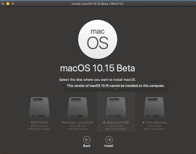

Why can't I install it on any of my drives?
Thank!
