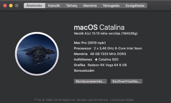

I tried the Catalina Patcher from Dosdude. Working perfectly.
Thanks Dosdude!
