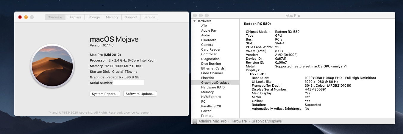

Just upgraded my MacPro mid-2012 to mojave. I got hold of Sapphire PULSE RX 580 8G G5 OC Lite card
Was running High Sierra and took a few tries to upgrade firmware. Can I upgrade to Catalina on this card?
How is it working for you? Seen quite a few posts here saying the RX580 Lite is generally to be avoided.
OTOH, my XFX RX580 is also not recommended on this forum but it has been great so far. Maybe a fluke.
Maybe do an upgrade on a test drive first and see how it goes.
Right! I ordered the non-Lite card but it was out of stock so the retailer shipped this to me. Was going to try once before i return it. Works wonderfully other than the missing boot screen. Also added a Samsung/Crucial SSD on PCIe as the boot drive. Will try on the spare SSD and report.
