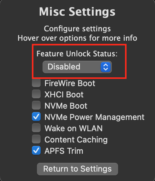

I upgraded my MacBook Pro 13 - Early 2015 to Ventura macOS 13.2 using OCLP 0.61. Before I did not use OCLP because macOS Monterey was natively supported. Update went flawless and after fixing the graphics by installing Root Patches everything seems to be fine. Using SIP standard configuration.
After a while using the laptop, I noticed that a lot of Apps are crashing. Mostly when I use CMD+Q for closing an app, I receive an error later on. Also when I try to copy and paste something, for example Chrome dies.
This is the Error: App "Messages" for example, all Apps crash with the same error:

Disabled FeatureUnlock and now everything is stable, no more crashing Apps.

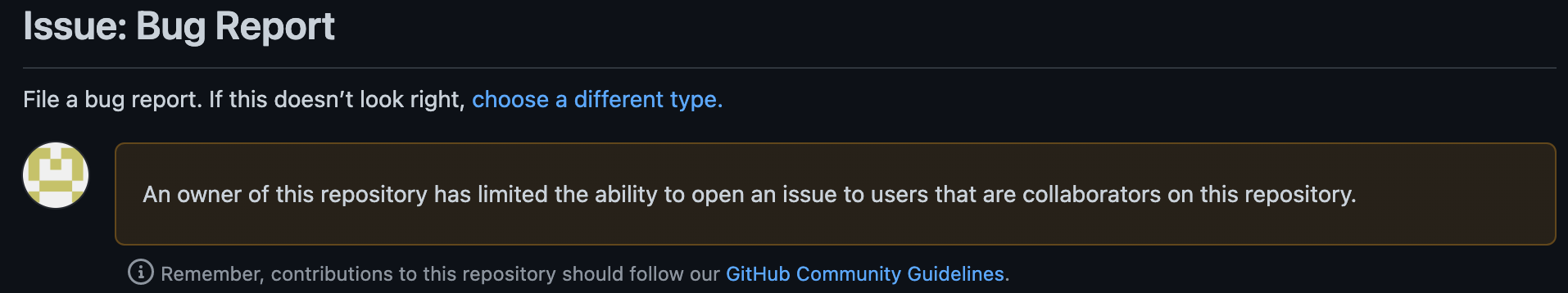

How can I communicate with the developers to find the issue? I can provide debugs if needed.
Thanks, but submitting a bug report was disabled.
